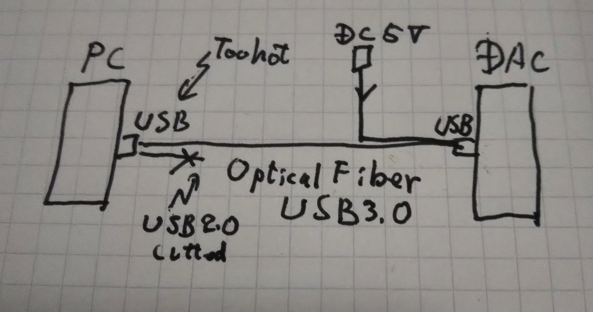

Please explain why the transmitting end on the host side became hot when I cut the wires and switched to an external 5V power supply for a USB 3.0 optical fiber cable that was originally designed to be USB 2.0 compatible, but I no longer needed it to be USB 2.0 compatible.
Thank you for your advice.
I attach the product and the drawings.
I modified a USB 3.0 optical fiber cable.It is compatible with USB2.0.
I removed the wires related to USB 2.0 since they were not needed and
supplied 5V power externally for the receiving end.
However, the transmitting end on the host side became hot.
The wires I cut were for USB 2.0, which includes VBus, D-, D+, and GND.
It was working for about 8 hours yesterday, albeit getting hot.
But just now, when I tried to use it, it stopped working, and my PC
reported that this device is drawing excessive power from the USB.
It worked perfectly before the modification. However, I did not confirm
whether it was getting hot during normal operation.

Thanks!
I checked as you pointed out, and it was indeed short as you mentioned.
After fixing that, I connected it to the USB, and normal operation was restored.
However, the main body of the optical fiber connection is still hot.
So, what I want to know is, is this heating normal?
The cut lines are still I left it as is, but is the handling correct?
For example, should I pull up or pull down something?
