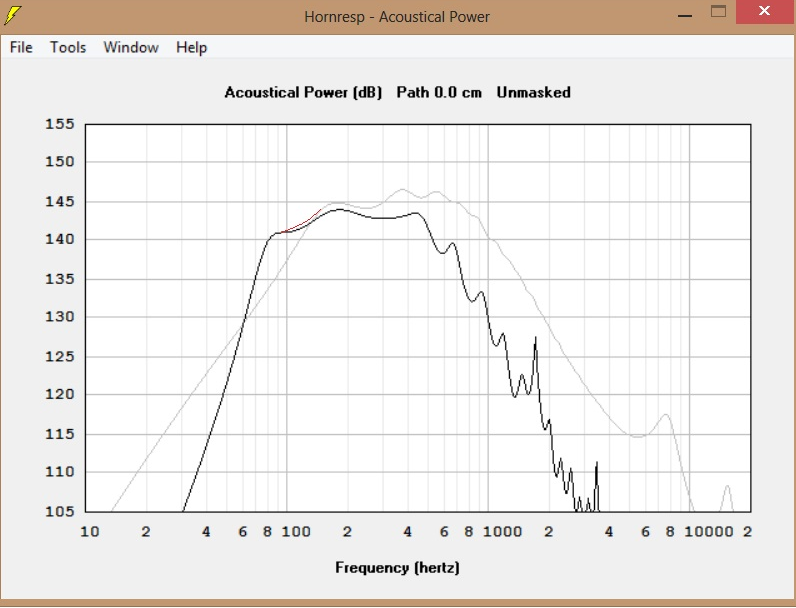

1) is that something Hornresp can do? I know what horns are and bass reflex but port-augmented horns?! - do you happen to know a good read on that one? I'm really curious about starting to use Hornresp to simulate all that.
2) How about using the B&C 12NDL88, which seem similar to the RCF MB12N351, a little more powerful with 700W Prms, and even cheaper. It's probably still not enough SPL then since it's still 100W Prms below the 12NDL76 combo. But imagine using two 12NDL88 in a PM60 box...then we're talking 50% Woodstock! :-D

1) Yes, Hornresp can simulate horns with bass reflex ports, as PM did in his designs, or my SynTripP design, or countless others. Hornresp allows you to look at the horn and port contributions both separately and combined. Freddi has posted loads of Hornresp simulations of various horn/br combos, searching his posts could give you basic starter parameters.Thanks Art!
1) I'm really curious about starting to use Hornresp to simulate all that.
2) How about using the B&C 12NDL88, which seem similar to the RCF MB12N351...
2) Once you arrive at a basic design, you can plug in the various drivers under consideration to see how well they will work. With as low as you want the mid section to go, excursion is probably more a consideration than power handling.
