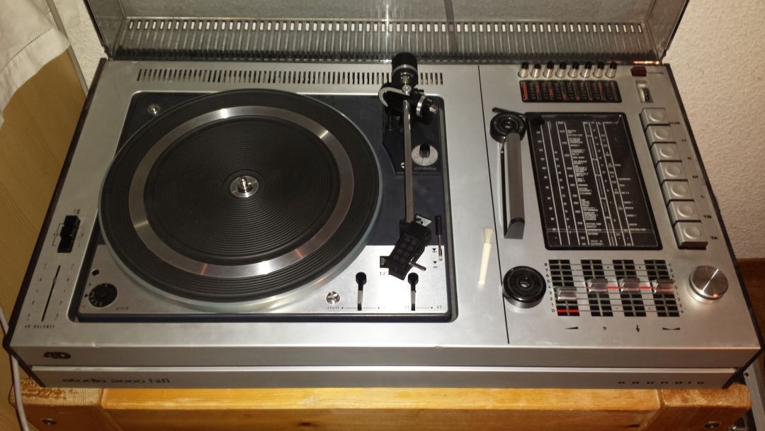

I'd look not that badly at Grundig gear of those days. I own a 1972 Grundig Studio 2000 HiFi console, pulled from the dumpsters, and I'm rather proud of it. Sound is typically 1970ies, but pleasant anyway. Radio section is, typical for Grundig since the 1950ies, very sensitive and selective. Maybe this unit is some bit superior to the Rossini, though. At least the original TT was a Dual 1226, a better record player than the 1220. I've converted it into almost a 1228, using that motor, platter and tonearm:

This newer, 1972 Grundig Studio 2000 HiFi console is one of the products they made, when Japanese HIFI had entered the market and Grundig had to modernize. Something the very special situation with Grundig's leadership did not really allow. They where used to decade long product cycles, while the Japanese had a culture of constant improving, throwing new models on the market year by year.
Anyway, at Grundig they still did not see and understand what the profitable, returning customers wanted. They could not understand the demand for high power and objectivly better sound. So they sold only to the conservative customers, that bought once and keept their gear for a live time. The younger, performance oriented customer, who constantly bought new components and tried to stay up to date, making HIFI a life style hobby, turned to the Japanese makers.
The loudspeaker Grundig build where just an accessory, an inconvenient necessity for them and thats what they sounded like. Well made from the outside, outdated chassis inside.
Tragically the technically interesting HIFI products from Grundig where build at a time when Grundig was alreday bankrupt. A very good example how failed managment of a stuborn leadership killed a once profitable company.
