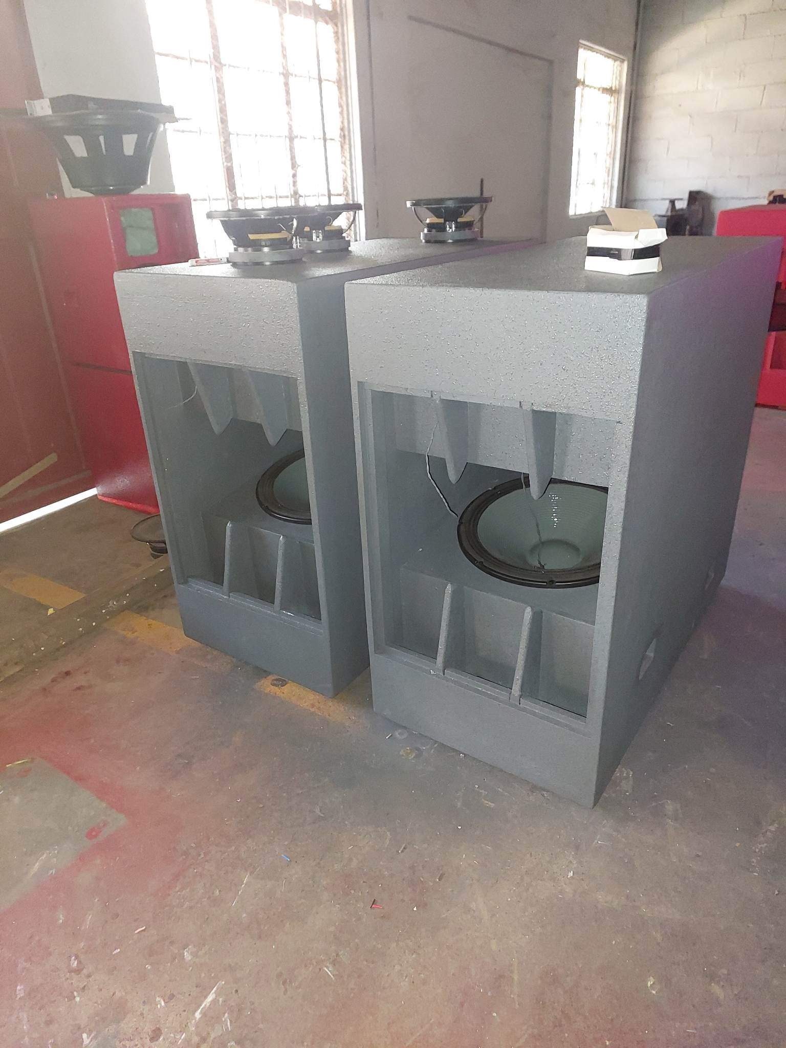

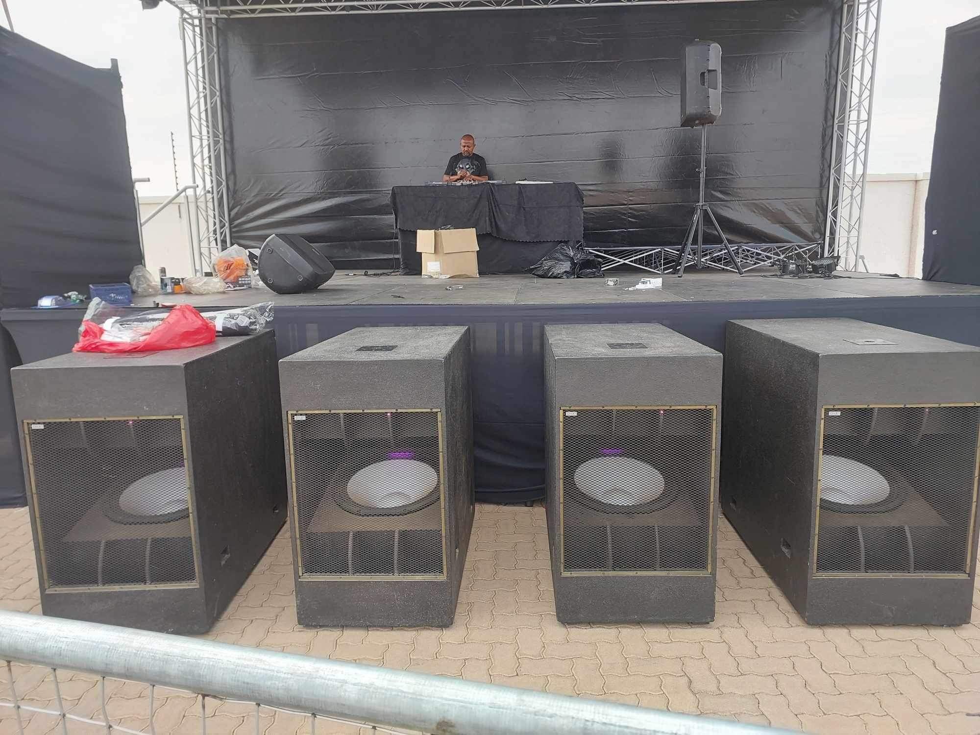

for the needs of a small setup I use 2 tham 15 and 2 rcf tt22a driven by 2 channels of a lab c48.4
the 750w satellites have 131 db declared, while the bass ones are the tham 15 with faital 15hp1060 driven with 1000w they should have 130db
To avoid bringing 4 subs, I would like to achieve better bass performance using the speakers I have, I don't know if it's a feeling due to the fact that more bass extension would be needed or I need more db in the same range.
However, I would like to do a new project also because I have the doubt that at high volumes the wood used, 20 mm conifer phenolic plywood, perhaps has losses, given that everyone finds the output of these subs monstrous.

I have other unused woofers available: 15hp1030 which are the ferrite version of the 1060, 15nbx100 from b&c, and I also have 2 18 faital 18hp1010 - 4 ohm, they don't have an exaggerated bl, but I could see using them in a tham 18, the final would give 1200w/4ohm.. what do you think?
I could, in this case, make better use of the power by putting the power amplifier on 2 bridged channels and limiting the output 🙂 it would become 2400x2 /8ohm

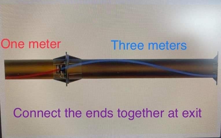

The ROAR is a quarter wave based seriell 8th order bandpass and the paraflex is parallel 8th order bandpass. With parallel bandpass you loose a lot of synergistic effects of positive acoustic feedback (virtual increase of Bl in the midbass region etc). It is more of a simple brute force solution, and as such it does have its place and uses...the roar 15 is an old piano, it seems like a cross between paraflex and TH
Most people seems to dislike or at least get surprised by the sonic character of massive amounts of acoustic positive feedback. It sounds quite different, with typically very "hard" and physical tactile character. Compare the difference in character and transfer curve of a natural aspirated engine with compressor loaded engine (roots blower type). It is not the same, but once you get to fool around with postive feedback systems you start to recognize the similarities in character.
‘ increase of BL in the midbass region’?
because the second resonace is coming off the resonator @ the motor side, or ?
what’s the front doing At this point? Unlike a paraflex (bose wave cannon) they don’t share a resonance 3:1 of the 1/4 wave harmonic, so where’s the ‘supercharger’?

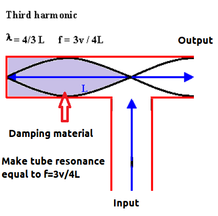

The large front resonator couples through the driver back into tapped pipe section. Helping the driver to drive the tapped pipe harder and to some extent push pull loading the exit of the tapped pipe where it enters the front resonator.because the second resonace is coming off the resonator @ the motor side, or ?
Because the 1/4 wavelength of the front resonator is a half wave length of the tapped pipe section (I’m trying to imagine pressure and velocity at either side of the drivers cone) .

I can not see what that picture has to do with a ROAR?What happens in ‘roar’ at this frequency?

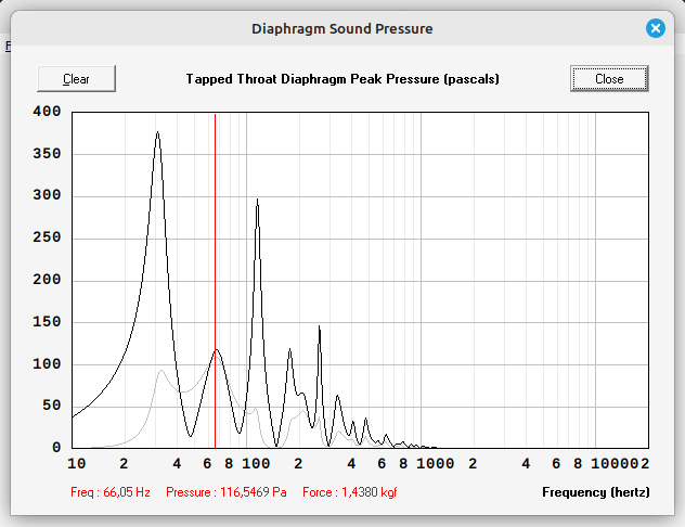

But below is attached a Hornresp sim with the pressure of the two sides of the driver compared. It does not directly show the phase relationship between the two sides, but the overlap in the midbass does indicate a substantial amount of positive feedback as also seen in the spl graph.
