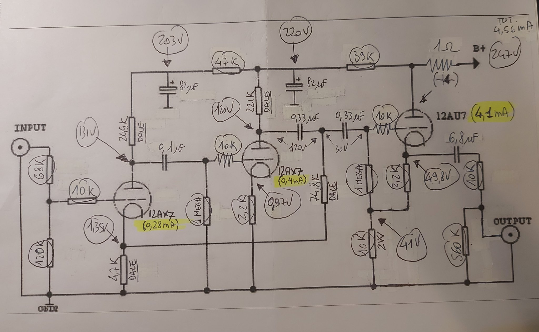

Hi, I mapped the schematic of this preamp with my resistor values.
Many, those made in carbon, have quite different values from each other.
I would like to replace them all with good new Kiwame ones. I think I'll leave the Dales.
I detected all the HT tensions. The filaments run at 12.6Vdc (lm317 to3). On the secondary of the filaments I have 14.5Vac.
I need to drive a 5K load on it. I think I will have to increase the capacity of the mkt capacitor (currently 6.8uF) at the output.
According to my calculations it takes 16uF for a high pass at 2Hz. I would also like to change the blue mkt caps and red mkp wimas for good audio grade mkp's.
I don't know if you have done this very interesting reading: https://ttradio.net/clone-marantz-7-m7-line-amp/
As you can see from my current diagram I don't have the correct values of the blue mkt capacitors.
The advice I ask you would be:
  • What values should I use for the blue mkt capacitors but also for the red wima capacitors?
  • Are the currents of the first two stages correct?
  • How can I modify the cathode follower (currently with ecc82) to be able to drive 5k of load, other than increasing the capacitance of the output capacitor? Higher current? How much? I have ecc81, ecc88, 5814, 5965, 6211 available in my drawers. Taller valves don't physically fit and I wouldn't want to cut the cover.
I don't know how much current the transformer can provide. Currently, with a total load of 10mA it's just timidly lukewarm, but maybe that's not saying much. There is a 6c4p-ev rectifier valve which I believe can carry, maximum, 75mA.
...and then there's the feedback....will it be a good thing implemented with those values?
Thanks for any help/advice!

5k is a very low load to expect a 12AU7 to drive, and there isn't much you can do to increase drive without compromising performance, as even best case you'll only get ~500 ohms of output impedance. Even modifying the circuit to something like a 6DJ8/ECC88/6922 etc will not be ideal, as 5k is a tough load for a smaller triode to drive without excessive distortion.

Tubes are high impedance devices. Even the 20k amplifier would be a strain for the cathode follower,
and will increase its distortion. But it would certainly be a better load than the 5k amplifier.
But the 100k pot is incompatible with either load. You could relocate the pot to the input instead.

The 100k potentiometer is already input. I just took an almost identical online diagram, and made my own values and a couple of other corrections.
The diagram represents my preamp exactly, except the pot!
I hadn't noticed that the pot was coming out.
I corrected it, sorry.

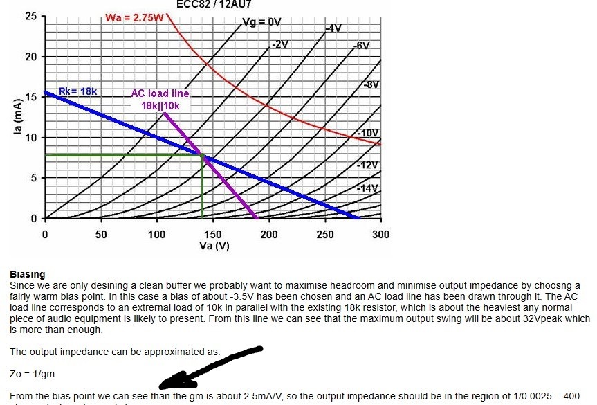

THANKS. ..on this nice internet page you can see that an 8mA ecc82 current produces a zout of 400ohm.
In my case it is 4.1mA. I'd like to know what the current zout is. I don't know how to understand it.
Wizard, in reference to the graph (which I attach) says: "From the bias point we can see than the gm is about 2.5mA/V".
I don't see any 2.5. But where should I look? :(
But wasn't there a rule that said that the zout must be 10 times lower than the load? Maybe I'm confused.

Also remove the 10k series resistor at the output, unless you must use the 5k amplifier.
In that case with the 10k present, the gain will drop to around 1/3 that of no load.
Yes, the cathode follower small signal output impedance is ~1/gm, but its distortion will rise
if loaded by anywhere near that. A factor of 5 to 10 lighter load than zout is more suitable.
Low output impedance does not mean low distortion under heavy loads (on the order of 1/gm).

It's a shame you cannot conduct some measurements because how will you know what any changes are good or not so good.
I feel that a 5k load is not too low but the 10k after the 6.8uf should be removed to avoid attenuation of the output.

You have a need to change them where out of spec., but not to change their values willy-nilly as you have done. Stick to the Marantz values.
THANK YOU. I WOULD LIKE TO CHANGE THE RESISTORS BECAUSE, PERHAPS, DUE TO OLD AGE, THEY ARE QUITE DIFFERENT IN THE TWO CHANNELS WHICH ALSO GENERATE DIFFERENT VOLTAGES IN THE VARIOUS TEST POINTS. THE VALVES ARE NEW AND MATCH IDENTICAL WITH AMPLITREX AT1000. IN ADDITION, SOME DO NOT SEEM LIKE THE REAL ORIGINAL MARANTZ VALUES. There are so many schemes around that I'm not even sure of the exact values they should be. Apologies for the capital letters.
At the moment I haven't changed any resistors. It's exactly like when I bought it.
