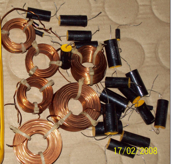

marchel i understand you. you have a rcl meter.Why don't you wire the
coil by yourself? here is the pic that i wire by myself. i spend my
money about 5 dollars to buy a wire about 1 kg. i wire it 1 mh=4 coils
i use a little tool. 80 per i use my hand. and check it again by lcr meter.
1 mh i spend the times about 15 minutes.is it cheaper? marchel your home
is far from me.i would like to wire it for you but i can't.

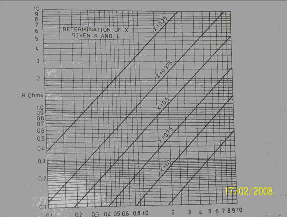

marchel i send the graph about bobbin.about 10 years ago i had ever used
i used the bobin 1" 2" and lower than 1"(x) 3 coils had value about 0.6 mh.
i used 16 awg(3 coils) i listen each of it to used. the low freguency was
difference. marchel i used order 1 for the woofer.i knew the best coil
is i"(diameter)for 0.6 mh. and i had ever wired it for passive sub.
i used 11 mh. The bobbin(air core)is the best=2" Marchel you see the
graph x=bobbin. r=ohms below=mh
