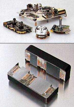

Hi andrew,
Japanese DAT Deck, factory sticker reads 100v 32W.
Somebody added 110 volts to it.
Transfomer see link. UK > 100v, 50VA.
Deck un-modified, other than how I use a dummy tape in it... which I doubt causes this effect - I suspect the transfomer.
I use it in rec mode for longer than 120minutes, to use it as a permanent A/D D/A converter, so, unlimited by tape length. To do this I cut the ferric-tape but leave tape inside drawer to trick deck.
Off topic:
Theres seperate behaviour which is apparently 'normal operation to prevent head wear'. In normal operation, i.e. regardless if dummy tape is used or not, the rec button switches off auto every 10mins (there's an interupt at IC level somewhere). The tape isn't moving in rec mode, but the drum head spins at 2000rpm, really I think the tape is more subject to damage here than the drum.
So I have to press REC every now and again when I listen to music which is a PITA.
