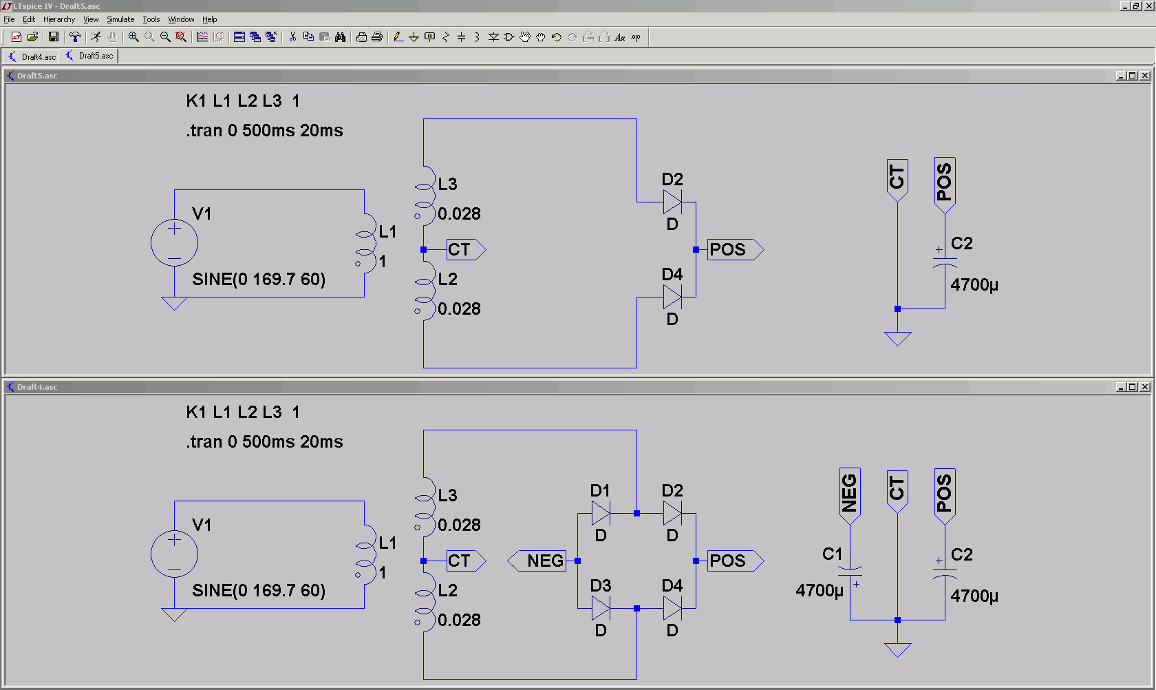

I'd guess you want to build something like these schematics.
http://i69.photobucket.com/albums/i43/Ty_Bower/MiscProjects/powersupply.png
The top is a full wave rectified supply. The bottom uses a bridge rectifier as Andrew described to give +/- rails.
Its amazing how a redrawing solves everything.
From that drawing it looks like i could draw full va from either side of the ground. So no rewire is needed. I just use the positive leg when i want to run the T amp, and it will get the whole transformers va, and i use both the negative and positive side of the ground when i want to use the lm3886, and i still will get the full va of the transformer.

absolutely not!.......... it looks like i could draw full va from either side of the ground. .................. and it will get the whole transformers va, and i use both the negative and positive side of the ground when i want to use the lm3886, and i still will get the full va of the transformer.
Half the secondary is limited to the same current limit as the whole secondary.
When you use half you end up with half the VA.
