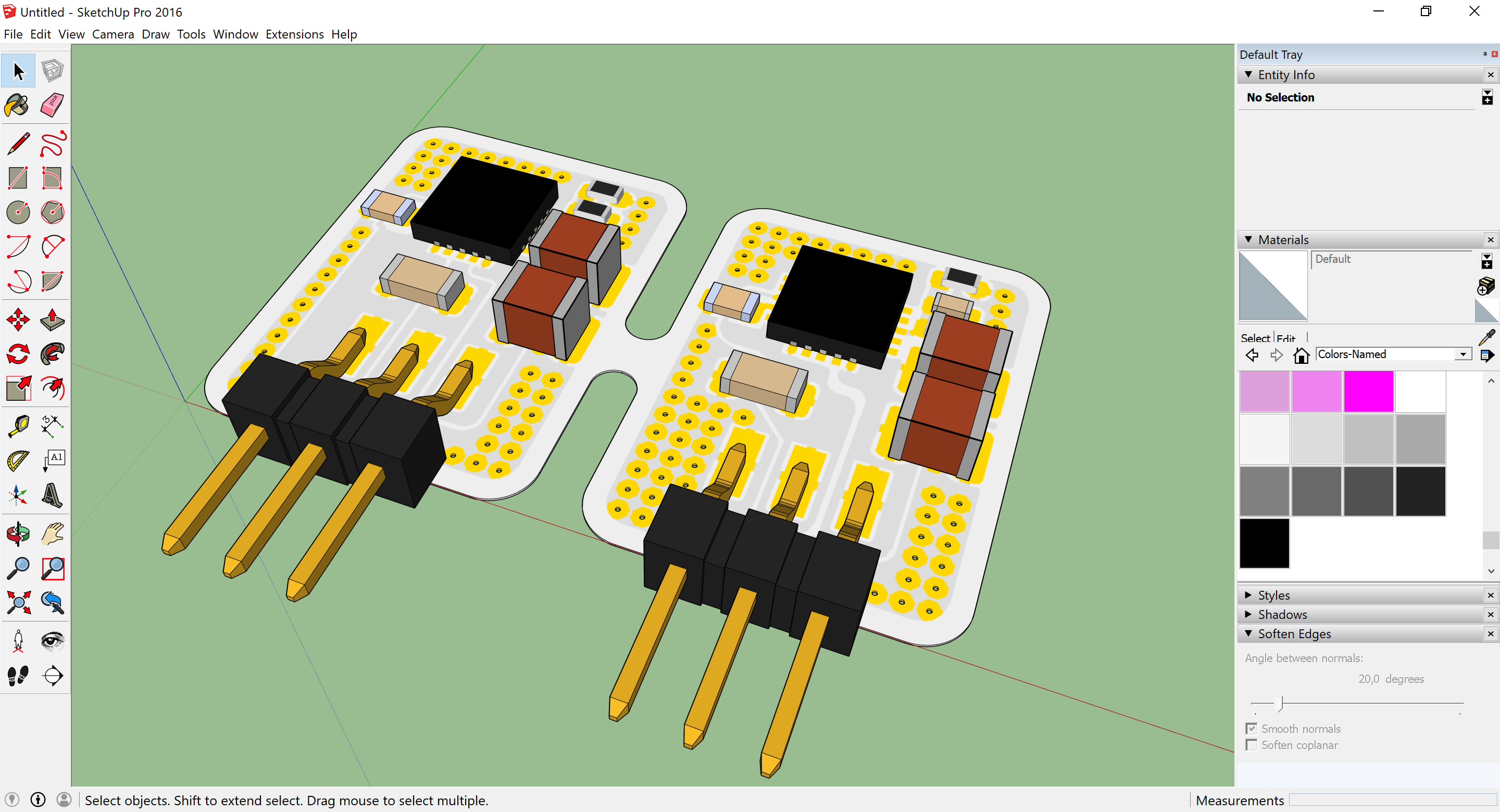

I´ve started the development of an electronic consisting in one panel with different boards with following features.
Note: the PWM and temperature is part of the ALPHA BB board but I´m thinking about additional panel board with only temperature sensing expending universality.

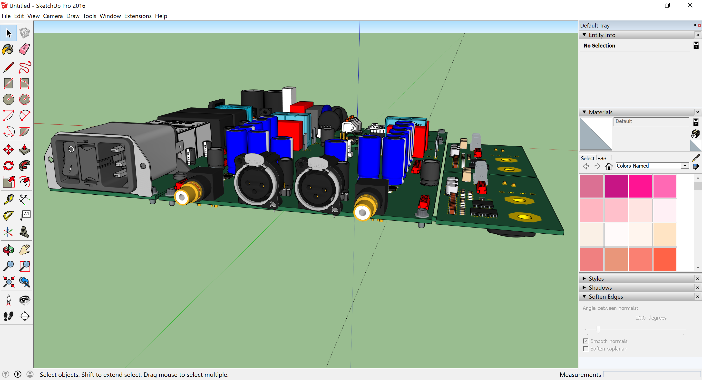

First board, schematics ready:
- 115/230VAC 50/60Hz filtered inlet with switch and fuse or wire to board for main power inout
- additional X2 filter capacitor and varistor protection
- two AC/DC +/-24VDC converter powered by switch main power to supply analog power supplies
- one AC/DC +12VDC converter powered by switch main power to supply digital power supplies
- microcontroller (SW) controlled main power relay before powering amplifier
- 4mm châssis grounding hole
Second board, schematics ready:
- wire to board input connector from first board
- DC-blocking electronic
- NTC inrush current limiter
- bridged central ground to châssis (4mm châssis ground hole) over 6.3mm faston or cable soldering

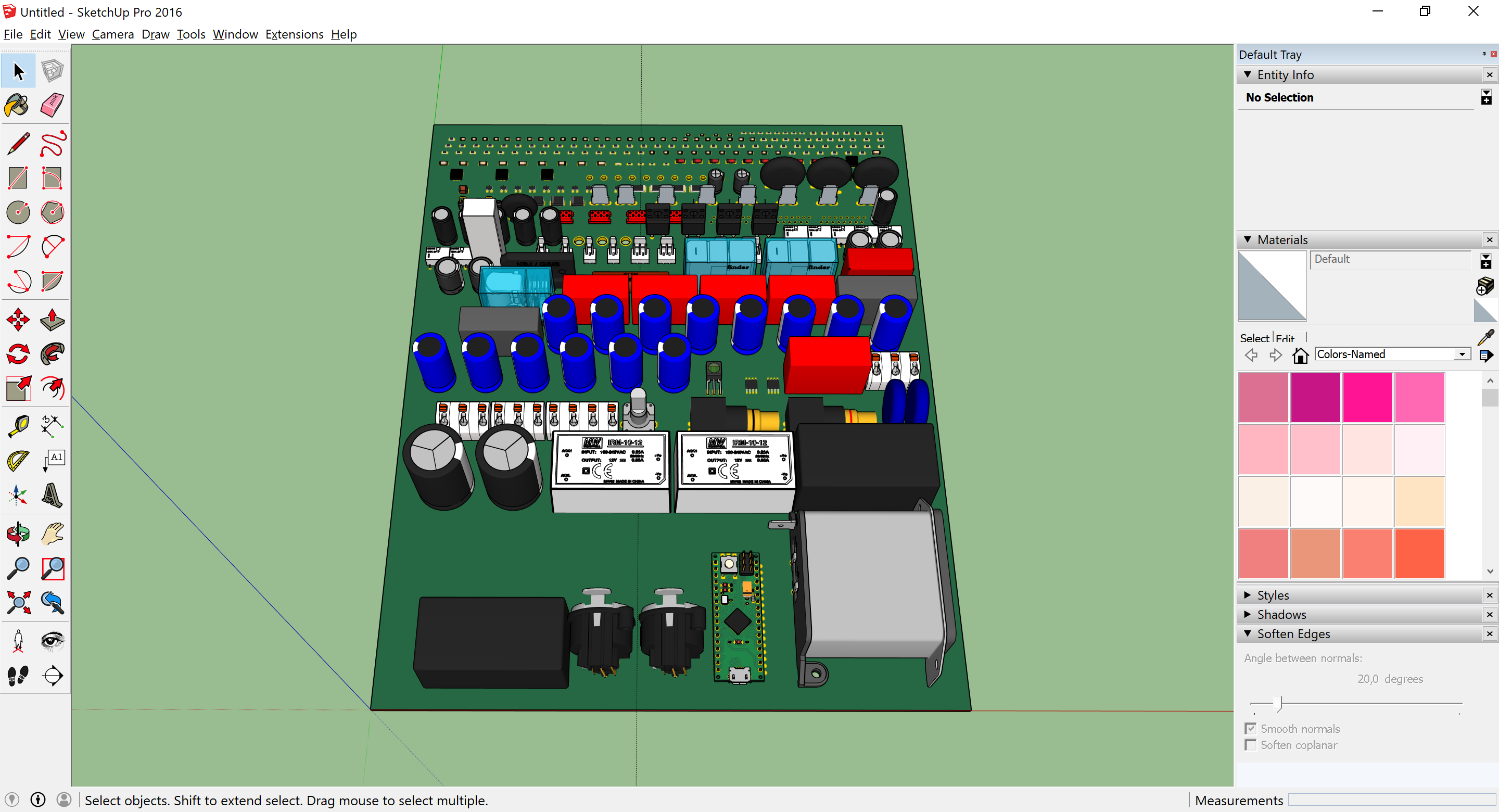

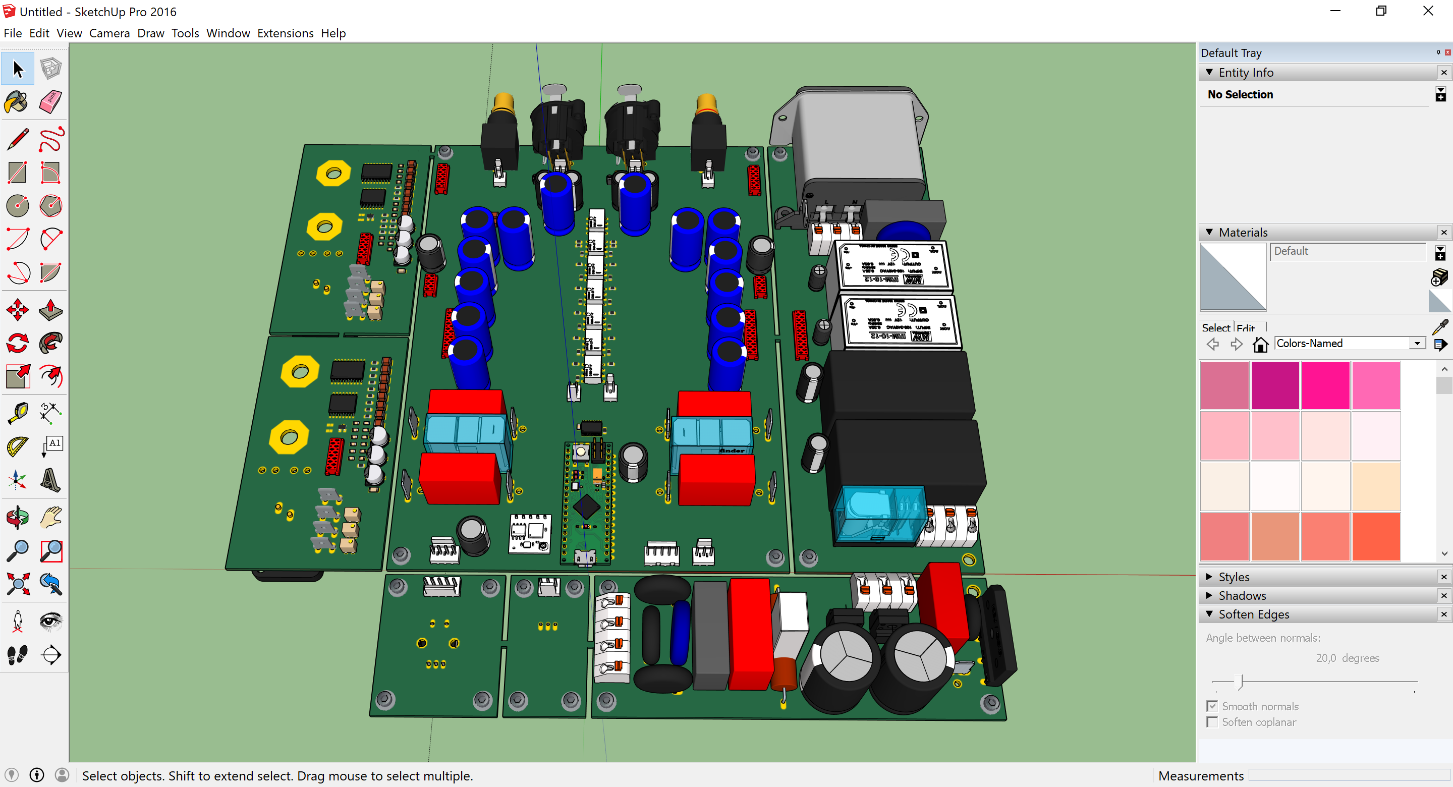

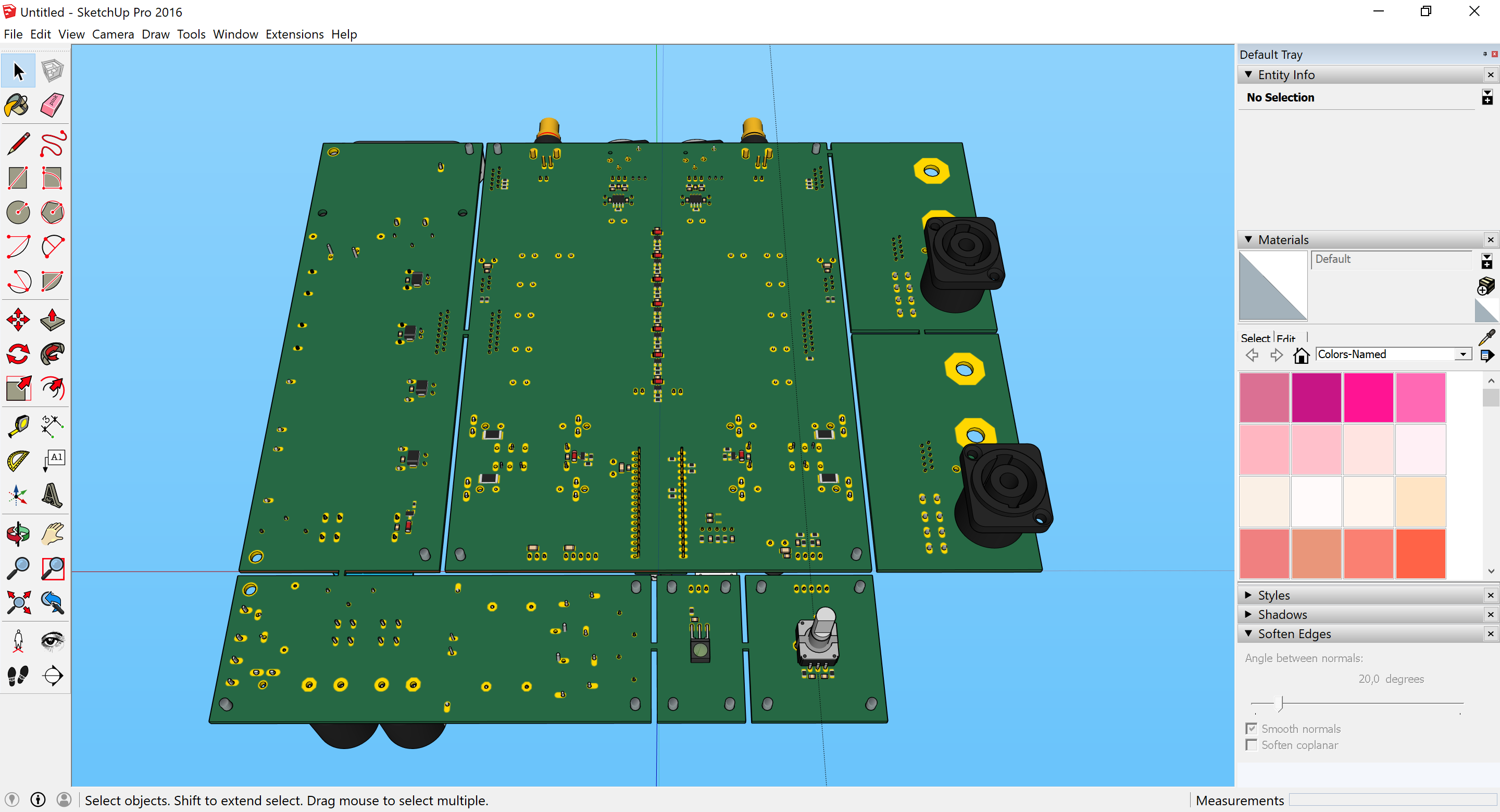

Third and fourth boards, schematics needs some modifications:
- wide ranging VU-Meter based on THAT Corporation design Note 119: http://www.thatcorp.com/datashts/dn119.pdf
- two channel I2C(SPI?) ADC (separating VU-Meter and FFT data streams)
- ADUM1250 as I2C isolator
- +/-15VDC analog supplies powered
- +5VDC digital supply powered
- faston 6.3mm or NEUTRIK NL2MD-V or holes for 4mm bananas for loudspeaker outputs

That sounds good. I wondered, I count three big relays. One for power, the other two for loudspeakers muting ? Have you considered going for SSR rather than physical relays ? It's hard to find relays with really great DC current ratings (except maybe the amplimo ones).
Very nice, JP! Thank you for putting together such a nice interface for our amps. The Alpha BB PCBs arrived today. I won't have time to send them until the weekend though.

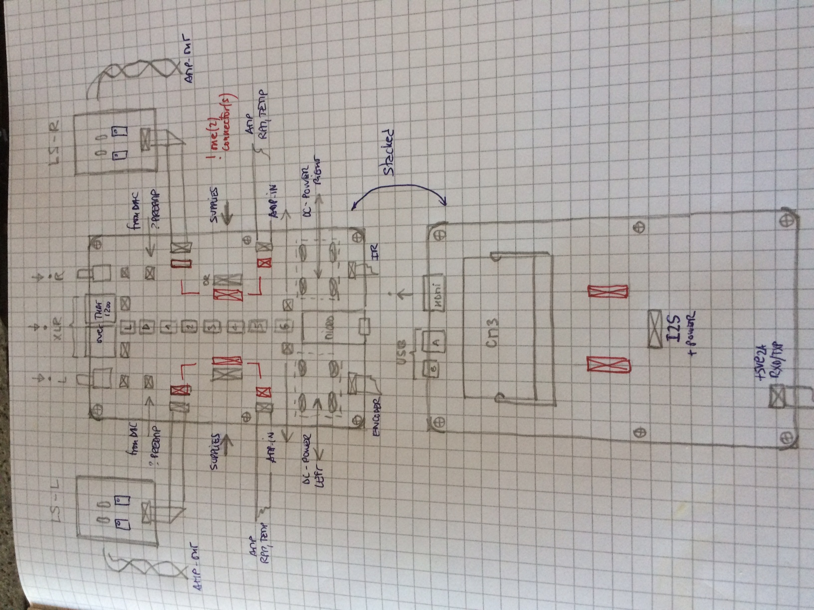

Nonetheless, I´ve started another version using Raspberry CM3 Compute Module (VU-Meter, TFT, RPM, temperature and RS232 display) with Arduino Micro (encoder, IR receiver, elapsed time recorder, RTC and GPIO):
- USB2.0 HOST and OTG interfaces
- HDMI interface
- and I2S interface!
Icing on the cake: NXP i.MX 6ULL - ARM Computer/System on Module iMX6ULL
