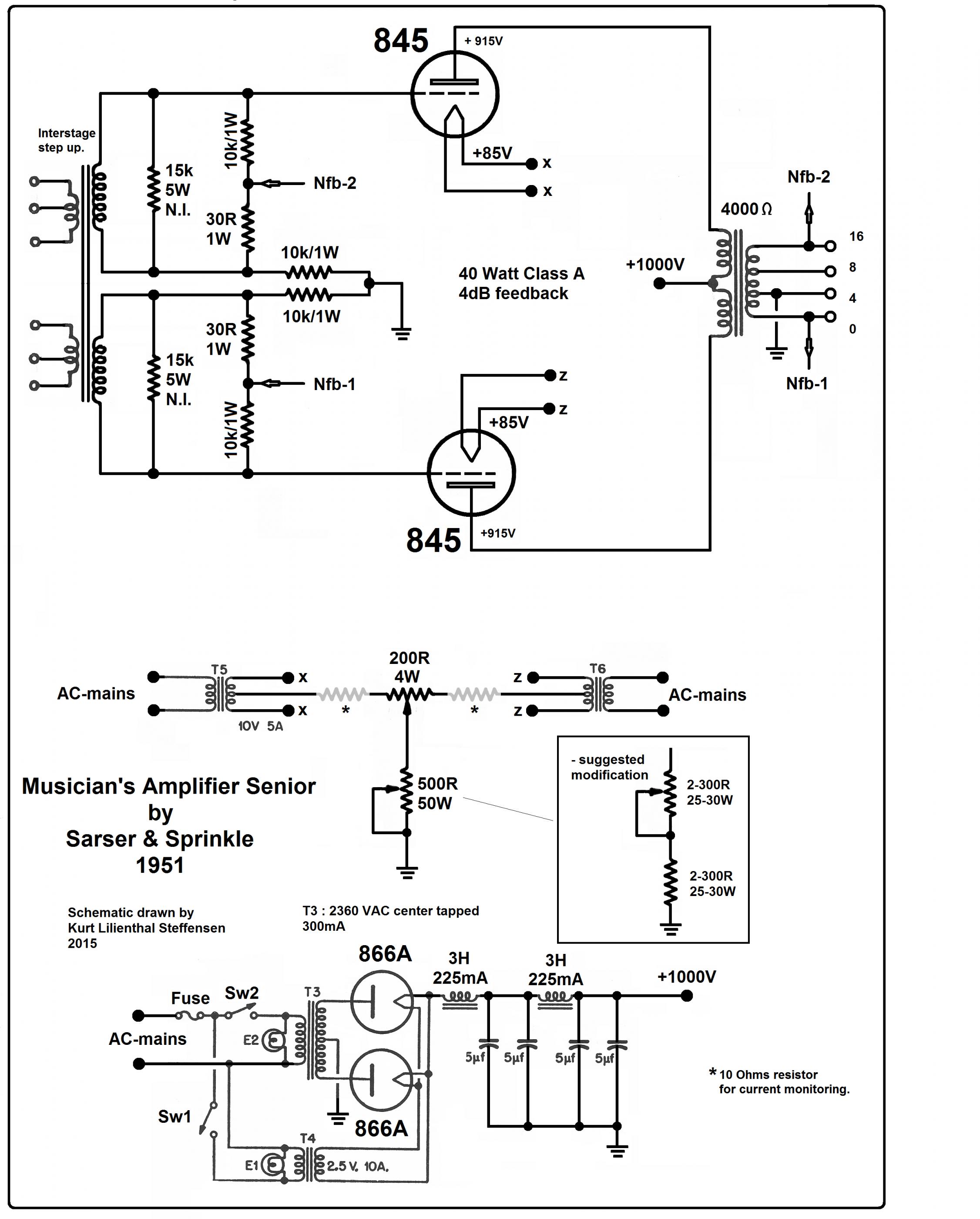

This first schematic is the "Musicians Amplifier" from Lilenthal Engineering website.
http://bit.ly/2OnrQnv
[IMG]
Now I understand how the Bias is set here, it's easy to see and understand.

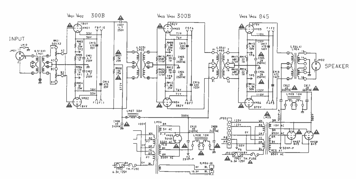

Next is the MARANTZ T1
[IMG]
This amplifier is where I get lost in understanding its Bias control.
It's my understanding that the Heaters on all three stages are fed from DC power supplies. Not shown here.
I've looked for a while now and this one schematic is pretty much all there is on the internet.
Be that as it may. How is the Bias adjusted here? Or is it fixed? Or might it be something that is adjustable, its just that the part of the circuit where Bias control is set is not shown here, so we have to imagine a control circuit elsewhere?

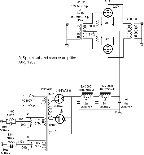

And lastly is a circuit from MJ magazine with the 845's being driven from a single Interstage transformer.
Again same question.
How would Bias be adjusted here? It looks like there are two separate filament transformers here.
And I'm assuming that the Bias section just isn't shown.
The power supply section is obviously missing so again the Bias would probably be a part of that circuit.
I'm wondering if a Bias scheme similar to the one used in the "Musicians Amplifier" would be applicable here ???

Left most schematic
915V plate, 85V drop across the self bias resistors
A 500 Ohm bias rheostat resistor and 200 Ohm balance resistor allows setting of the total current, and balance, respectively of the two 845s. There are two more resistors (*) to get the total resistance of the self bias circuit so the range of current is correct for the actual B+ voltage.

Marantz T1
The two 1.5k Ohm self bias resistors and 22 Ohm current sense resistors (TP 5 and 6), are the self bias network. Each series network of 1.5k and 22 Ohm are bypassed by a capacitor.
Individual self bias, nice.
The next schematic is simply the old print, and the first schematic is the same Senior Amp.
The last schematic is incomplete, and so no conclusion is possible.
I favor using individual self bias networks, (resistor and bypass cap). And that requires individual filament supplies.
I recommend DC filaments.
With AC filaments you get 2x line frequency sidebands on each musical note / tone.
That is true, even if you balance out the hum (like no hum when there is no music playing).

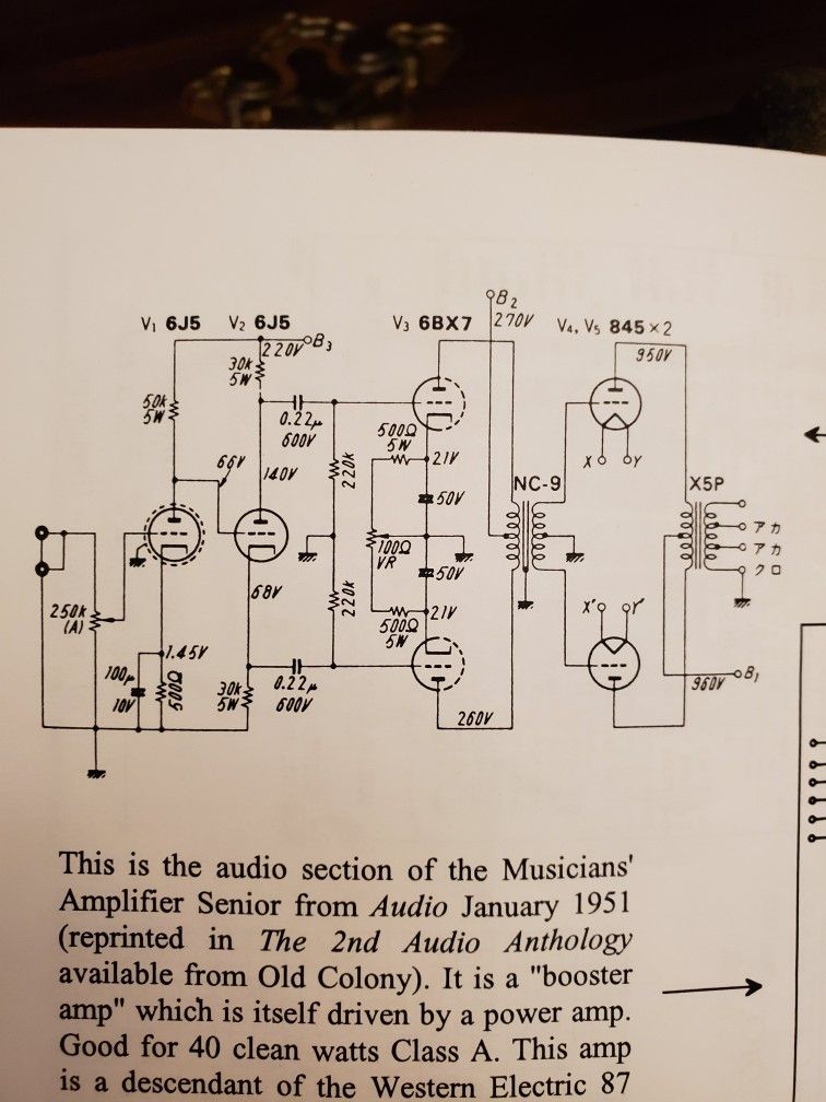

6A3sUMMER The last schematic is incomplete said:Yes I posted the other schematics for reference. I'm hoping someone can help me extrapolate what the powersupply / Bias supply would work for that circuit.
Use the powersupply from Sakuma's amp with the 6J5 driver circuit.
The Bias circuit is what I was looking for.
Probably sub out the rectifiers with 836 or 866A's
And maybe use 6BL7GTA instead of 6BX7 ??? A little R&D needed there.
I had Phil at Heyboer make me the interstage transformer labeled NC-9 it's 5K to 20K ohms ct.
And use FREED QGA-42 output transformer. 5K ohms at 100 watts.
Your post # 6 has an 8 uf capacitor to provide all the plate current for two 845 tubes.
8uF is 995 Ohms at 20 Hz.
You will only be able to operate in class A on the output stage. Otherwise, the 8uF cap will cause the B+ to drag down, and clip the output stage.
You should use more capacitance than 8uf.
As to bias circuits, first decide whether you want fixed adjustable bias, or self bias.
For interstage driver secondaries that do not have two separate windings, and using fixed bias, you can not individually adjust the current in the two 845 tubes.
Individual filament supplies, individual self bias resistors, and individual bypass caps . . .
many tubes will have similar plate currents. And self bias helps prevent thermal run-away.
To determine the bias voltage, use the 845 tube curves, and determine the plate to filament volts you want to use, and the current you want to run at.
Your bias circuit will need to provide that voltage (fixed or self bais).

Just my personal opinion of course, and not a criticism, but 5K Ohms anode-to-anode is a poor choice for *any* of the 50-watter valves, even the least stringent type 845. Twice that puts the valves into the linear category and twice that again gets into the truly magic realm of great linearity and decent loudspeaker damping. Driving an actual loudspeaker is, after all, the goal.
These historical designs are interesting as historical items, but aren't even remotely carved into stone tablets and carried down from mountaintops. Push-pull type 845s is an exciting *new* thing, to be made the best of. Rant mode off, sorry.

Well I did manage to build the Musicians Amplifier. You are correct it's very dangerous.![]()
I love the looks of it! That is a work of art! Supernice build!
Please post some more pictures of it as some inspiration and motivation for our future projects!
Can someone explain the Bias here? The 100 ohm pots these are Hum pot adjustment I take it? And the Bias is Fixed, and is it set with the 2400 ohm resistors through the meters then to ground? R15 & R17
And the filament center taps are just left floating?
This type of bias is called cathode bias or self bias. Current through the 2k4 Ohm pots (and the meters) drops enough voltage to bias the valves about 150 Volts. Filament winding center taps aren't used with this kind of hum pots.

Looking at Meter 1 and Meter 2.
Any idea are these set up as volt meters, or Milliamp meters?
I know they have a red-green-red face and don't give an actual reading.
The meters are in parallel with the .7 Ohm resistors to ground.
I know in the Musicians amplifier circuit the metering runs about 100 to 140 ma per tube.
