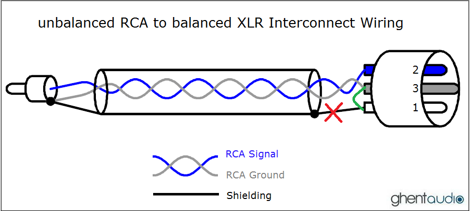

Unbalanced valve/tube pre amp into monos that say need balanced inputs
No, you can't use simple RCA style cabling between the preamp you currently own and the new monoblocks that have balanced I/Ps.

If you are DIY capable or know someone who is, make up a cable as such: RCA centre pin to XLR male pin 2. RCA outer shell to XLR pins 1 and 3. Works in a pinch and my Ref110 doesn't seem to suffer much sonically.
Ultimately, you'll like want a balanced pre as well. On the rare occasion that I want to use my Ref3 to drive a non-balanced input amp (the SQ of Ref3 suffers noticeably driving through its RCA outputs) I have a pair of Souter 3675 trannies. The Ref3 seems quite happy driving these as long as the input impedance of the power amp is 25K ohms or higher.

The first preamp I built was a single-ended output, so I had to make an RCA to XLR cable in order to use it with my MC650 which has a balanced input.
Pin 2 goes to the center conductor on the RCA connector, pins 1 and 3 are tied to the shield of the RCA connector.

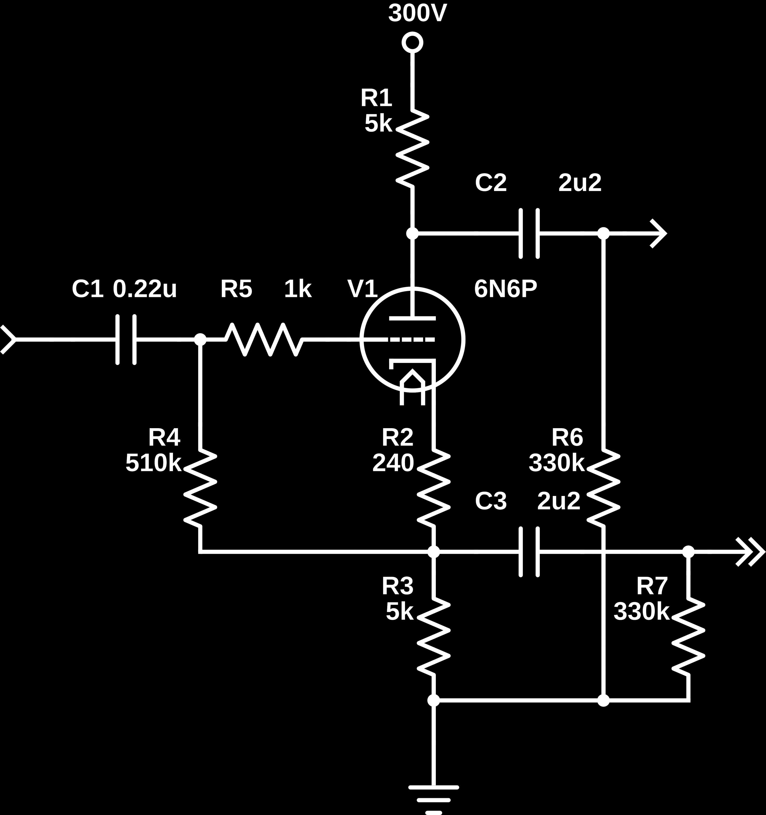

To do things properly, I'd suggest getting some Jensen transformers. Jensen sells boxes that do exactly what you need, but you can save a fair bit by building it yourself. This can also be accomplished with some op-amps. If designed well, this will be lower distortion than the xformers and will have nearly zero impact on the sound.
Building a balanced preamp with excellent performance isn't too difficult, so that may be something you want to look into.

Can you not just connect it as follows? This is how I drive my Yorkville amp from my tube preamp...
EDIT: I see Steve and H713 wrote out this picture...
