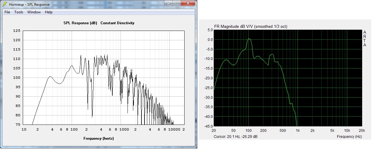

When crossed low at 55-60hz I really like whats coming out of it. Sounds distinct and solid. If I try to crossover it any higher it sounds hollow and even with blindfold there would be no problem to point out it's exact position.
This is really an one octave sub.
I dont know about the output power but as mentioned earlier it has no problem to cope up to the levels the alpair does.

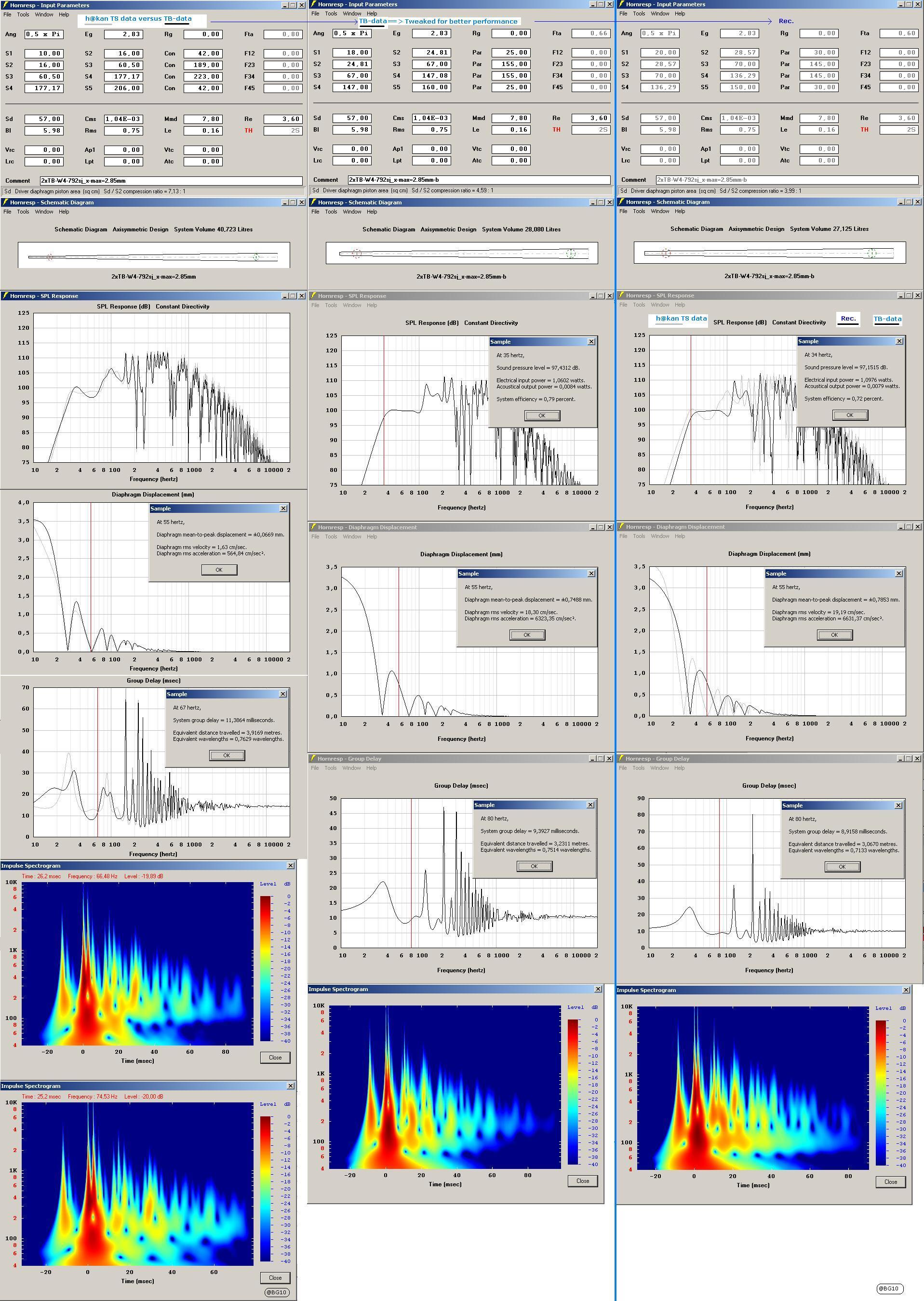

You might find the reason here:See the picture.
Did you use measured TS in your simulations?

The limited bandwidth is not a problem since it will just fill up the interval between 30-50 (or maybe 60) hz. The output is more than enough as well.
Whats worse is if I have used wrong ts parameters. Where did you find yours? I have used this data sheet:
Europe Audio
From what I can see bl and mmd differs from your values.

So did I ,
..From what I can see bl and mmd differs from your values..
I also consistency checked the data: Double click Sd in HR and you will find out why I used different parameters.

Okay I see now that you have entered Fs and Qes in addition of a assumed correct Cms and Re to calculate BL. Is that preferable over entering manufacturing sheet values direct into the BL field?

Yes,The consequences will appear immediately after entering all relevant data when pressing Sd for to finally check the main fundamental parameters: fs,Vas,Qts(Qes,Qms)

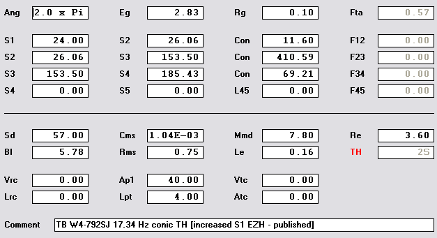

I noticed this yesterday, but didn't have time till now to post about it. As soon as I saw the 0.17 Qes/0.16 Qts I knew there was almost positively something wrong with either the published specs or his, if measured.
Using the EZH spreadsheet and the more likely specs (though best as always to use measured), I get a near perfect match to my calculations once S1 is increased, so maybe a good enough alignment if others want to try it or one can see if there's any benefit to a four section:

Last night I did a quick measurement. Mic was flush the terminus (or mouth the correct term?). It seems like Bjorno's first sim, with my faulty ts parametrs, is pretty much what comes out of the horn. One have to take the measurement with a pinch of salt, of course, but the similarities to the sim is quite significant. Filter on amp is set on 150hz.
