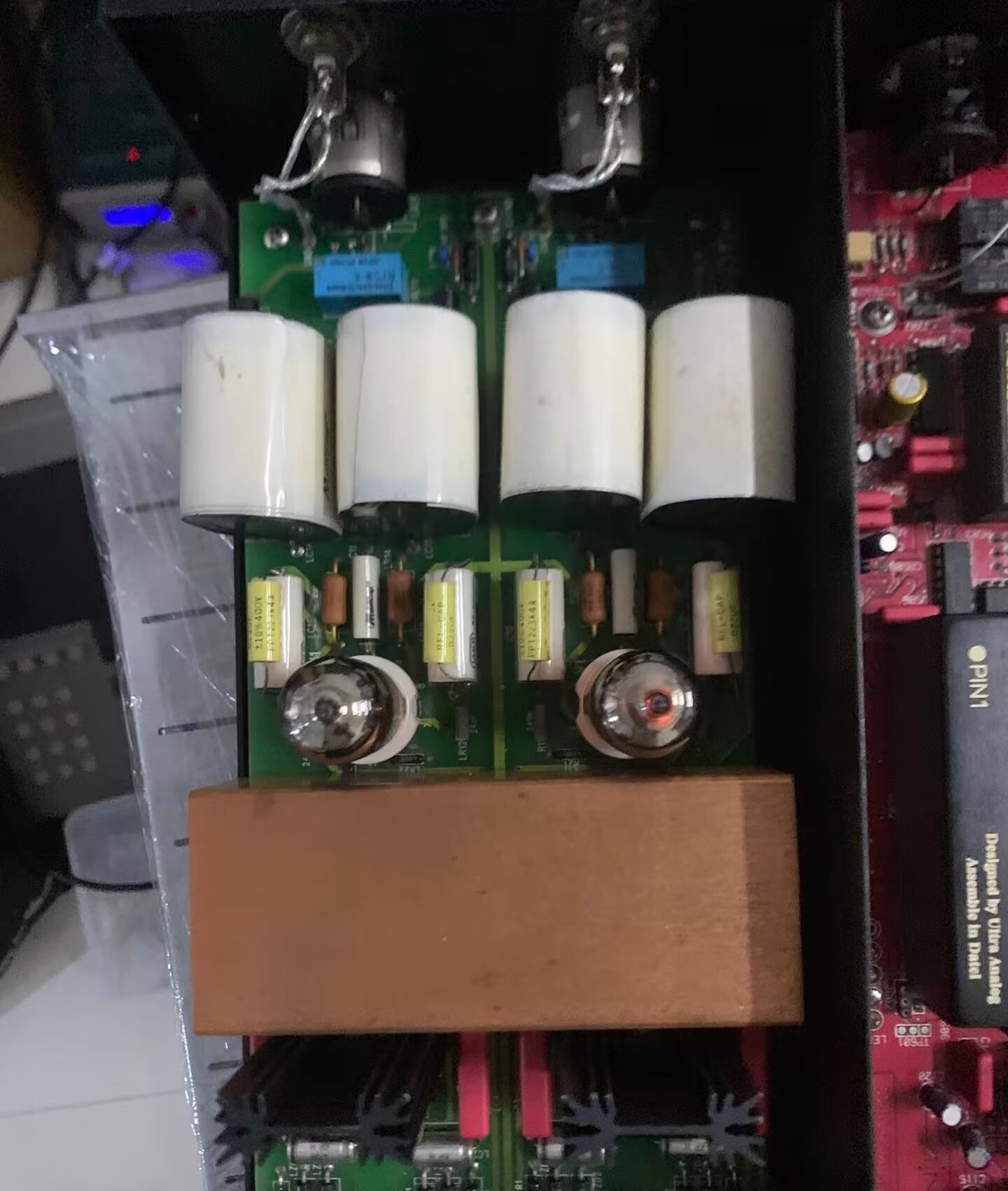

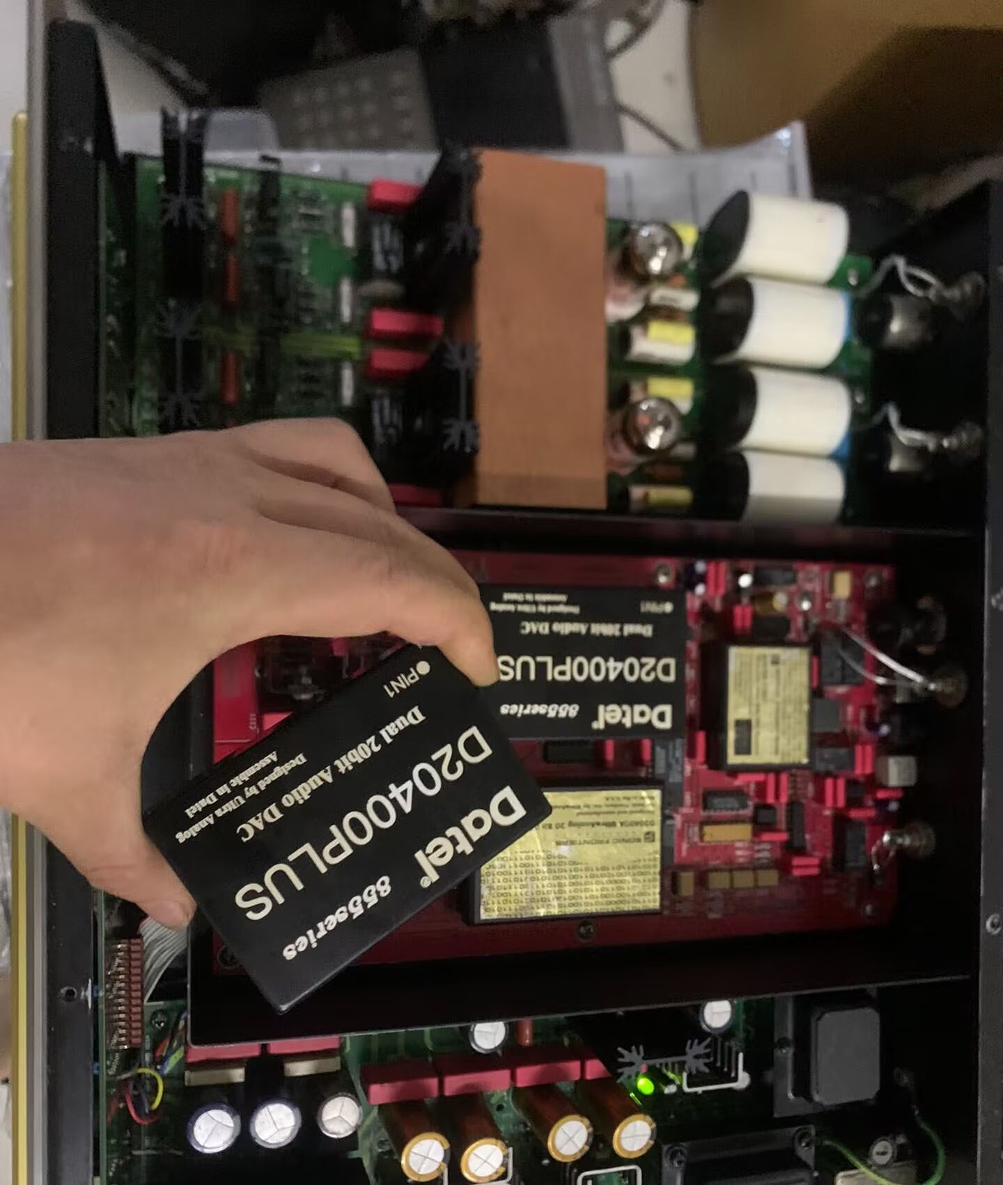

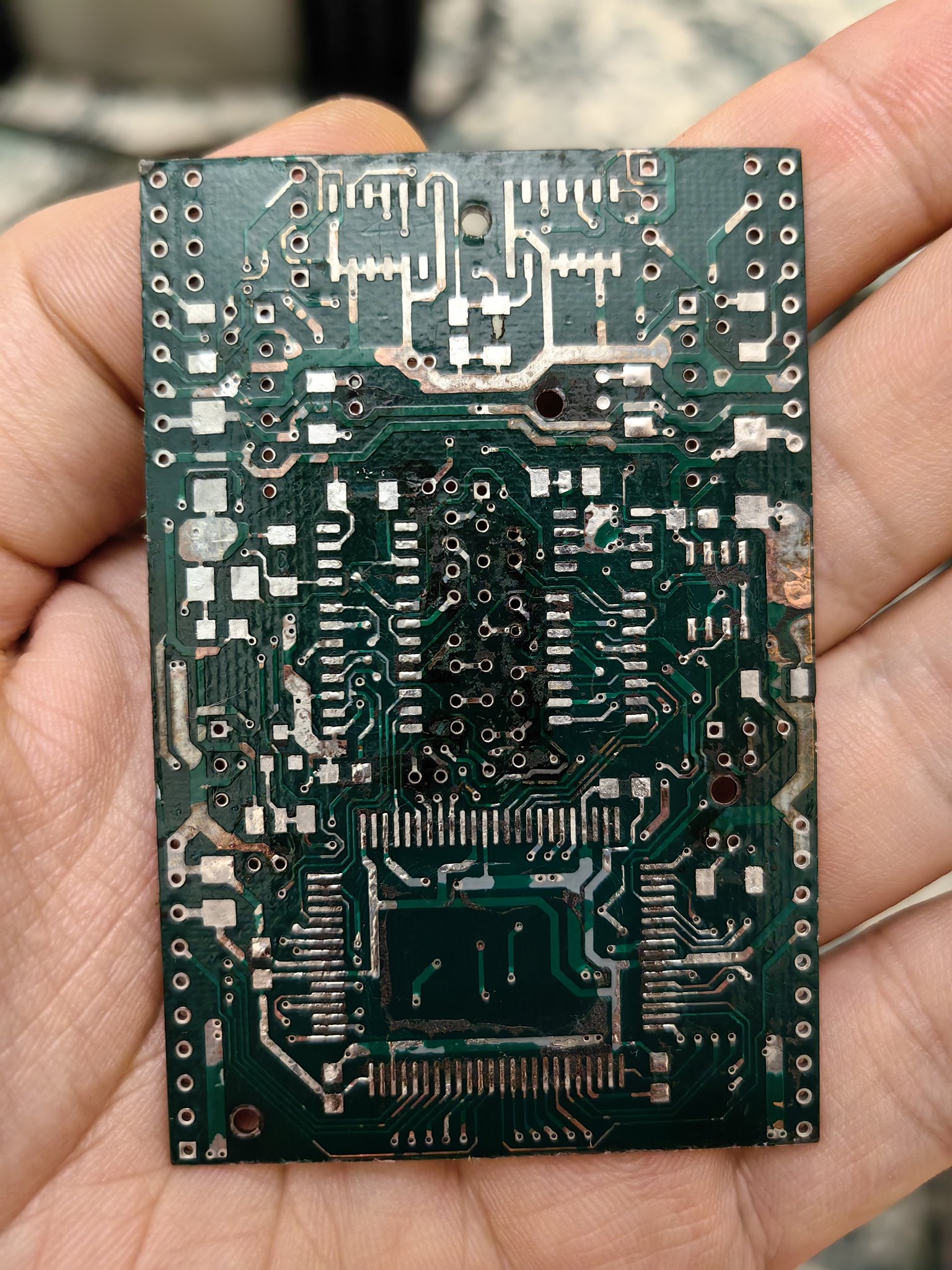

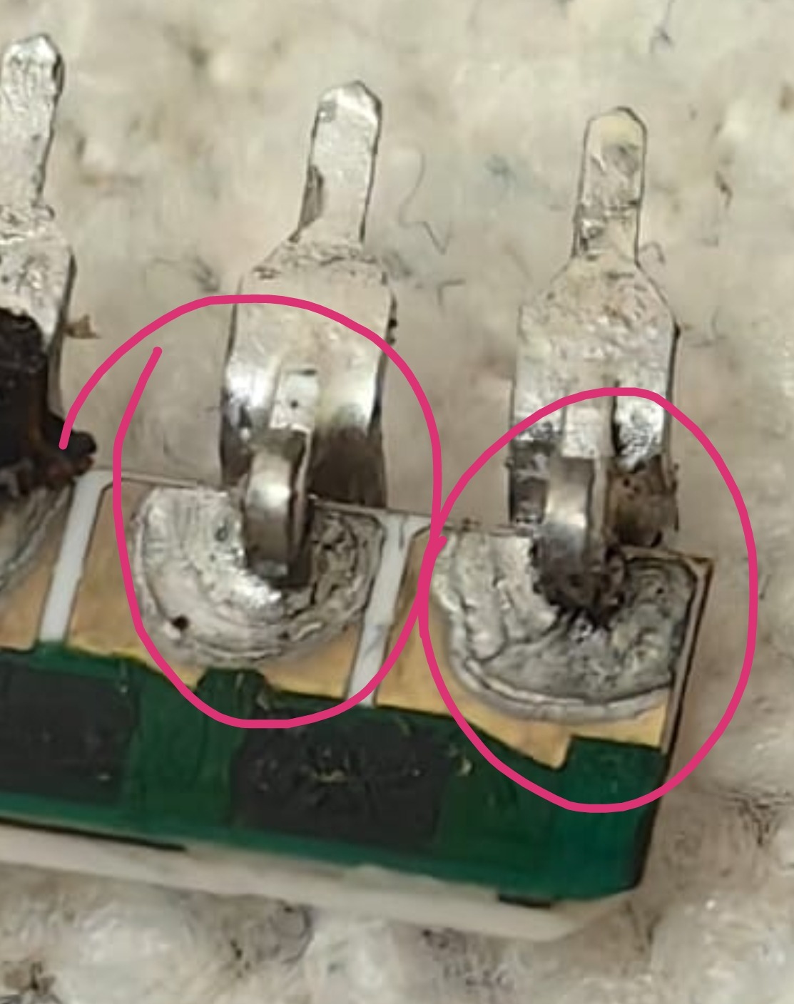

Hello everyone, when you turn on the ml 35 dac, the channels were noisy. I removed the compound with a hair dryer for three days. The fault lies in the cracked solder on the central resistive node... We need to disassemble the second assembly, and it's terrible... I was thinking about replacing it with a pcm1704 board. Does anyone have a layout of such a board? I read that the madrigal was officially put in place of the ultraanalog d20400. I also disassembled the 20400 to a bare board, I have an idea to copy it. Do those present have a desire to make a copy? I am ready to provide high-quality photos and sizes.

Hello
,i got the information this weekend, the d20400plus card works on a mark levinson ML30
we are finalizing the presentation for the vendor's bazar
