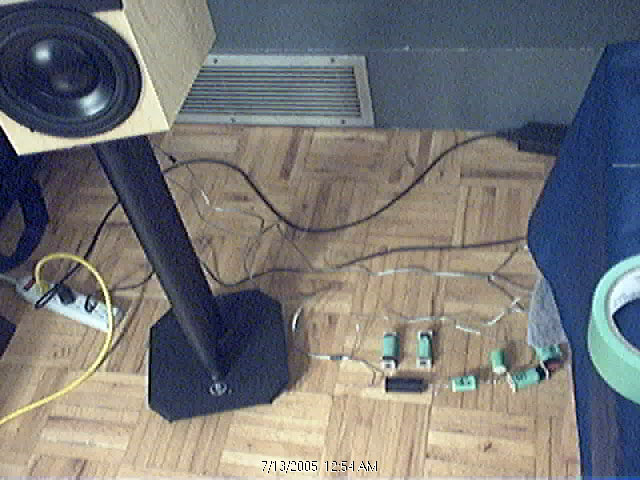

hey guys, i finally got around (and finally got the courage) to build my first cross over
now here comes the question. i have bought all of the parts..but how exactly do i lay them out on the board i will be using? does anyone know of a tutorial on construction that they would like to share with me? any help would be amazing. thanks!

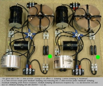

This may or may not help. Shown on this page is a schematic for a crossover and then the completed crossover. Trick to assembling passive crossovers is this I think. Don't focus on the layout of the entire crossover at first, just connect the first two components together, then add the third, then the fourth keeping in mind where the leads to each driver as well as the leads to the "+" and "-" input terminals will go. Don't feel dumb, looking at the schematic and understanding it is pretty easy, sometimes assembling it can take some imagination.

lemans23 said:i finished one of them already. any comments? [/B]
It looks quite good. I would change one of the coils standing up though, even if its not close to the other coil.
To keep the coils ( which are heavy ) in a stable position for ever, except the glue, it is also a good idea to use plastic tie wraps (open two holes on the board next to each coil and use the ties to hold the coils on the board)
