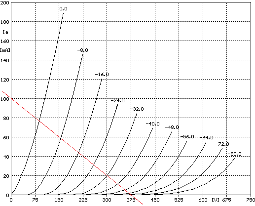

Okay, just by fooling around with the EL34 triode curves from Audiomatica, it looks like you could get about 2.5W output into 3.8K with 225V anode-cathode voltage and idle current at 40mA. Grid bias would be around -18 or -19V. If you use cathode bias, then you want 470R (2W) in the cathode path to ground. Required B+ would be 225V plus bias voltage plus OPT primary loss due to DC resistance. Probably near 260V.
The driver must deliver at least 40Vpp cleanly with voltage gain of 20 (for ~700mV sensitivity), which isn't challenging. Feedback seems mandatory to me, but I assume this is meant to be a learning experience. Turn it every way but loose. If you want 12dB of feedback, for instance, then driver gain must be 12dB (4X) greater, or 80, which is more than single triodes can normally provide. There are many ways to move forward from here.

Yes is a good starting point. I've read a lot about the single ended amplifiers sound but have never seen one up close. I really want to build one of these.
