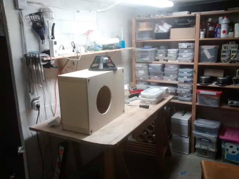

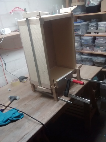

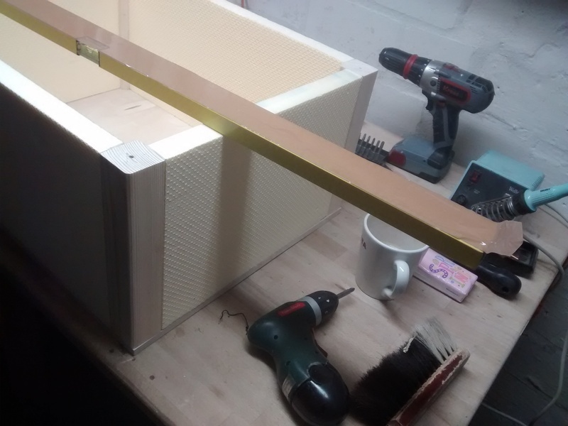

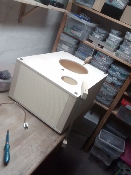

I built a lightweight 50l bassreflex box with 10inch driver. As can be seen it is a hybrid made from wood and foamcore. The driver weights 2kg - the hole box - I dunno, it is pretty light😉
