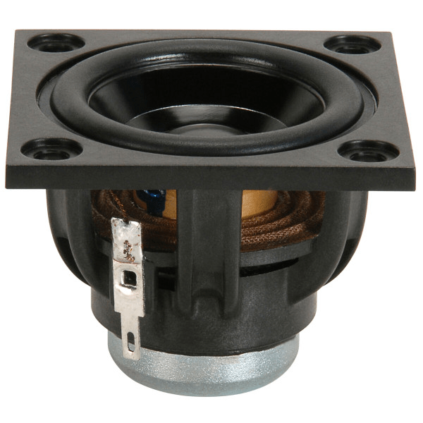

Seek your inputs on choice of loudest possible driver for voice / speech applications which can fit in a sub 2-inch diameter circular cutout.
Weather and ingress protections are highly desirable due to nature of the application.
Presently, have homed on to the following: -
https://www.parts-express.com/Visaton-PL5RV-1-5-8-Full-Range-Driver-4-Ohm-292-636?quantity=1
However, cost being no object, want something which can go really really loud.

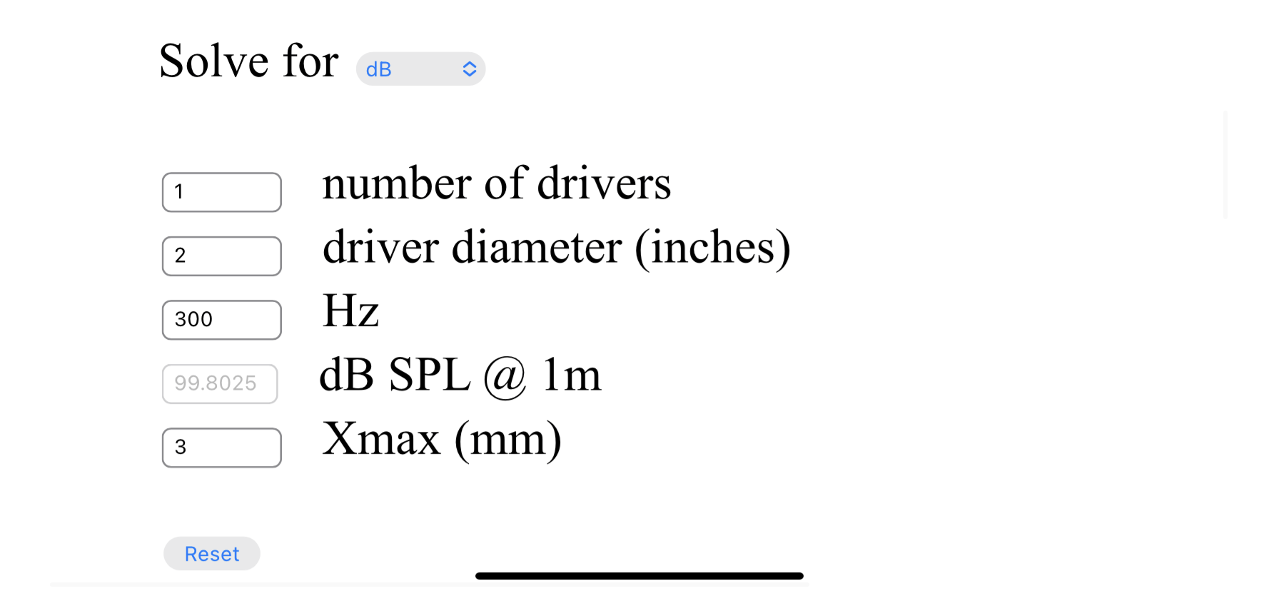

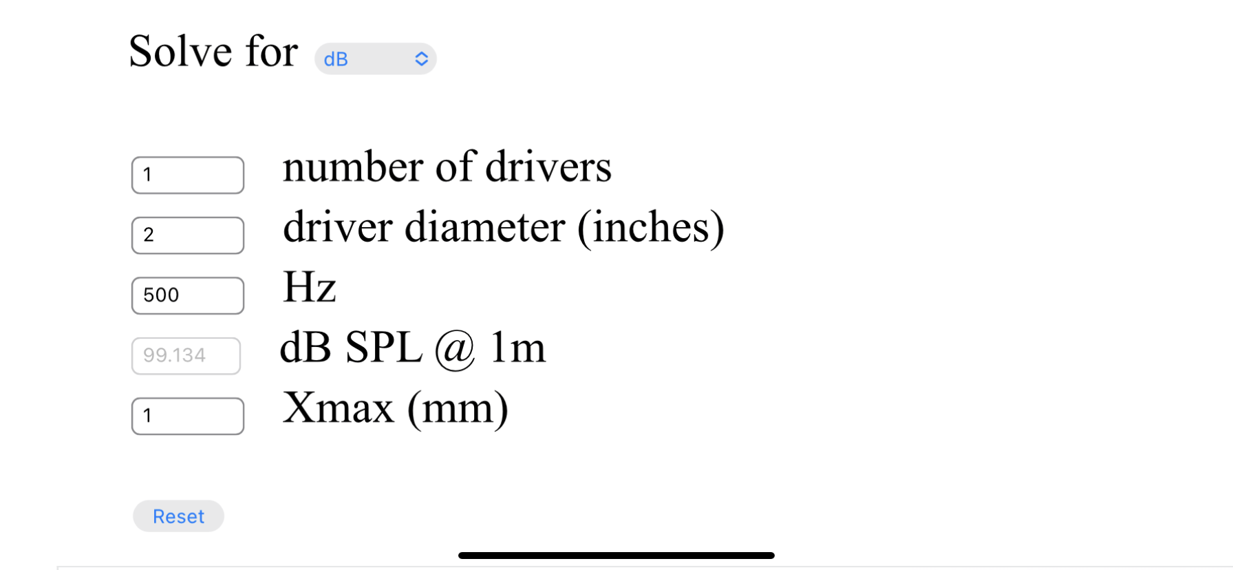

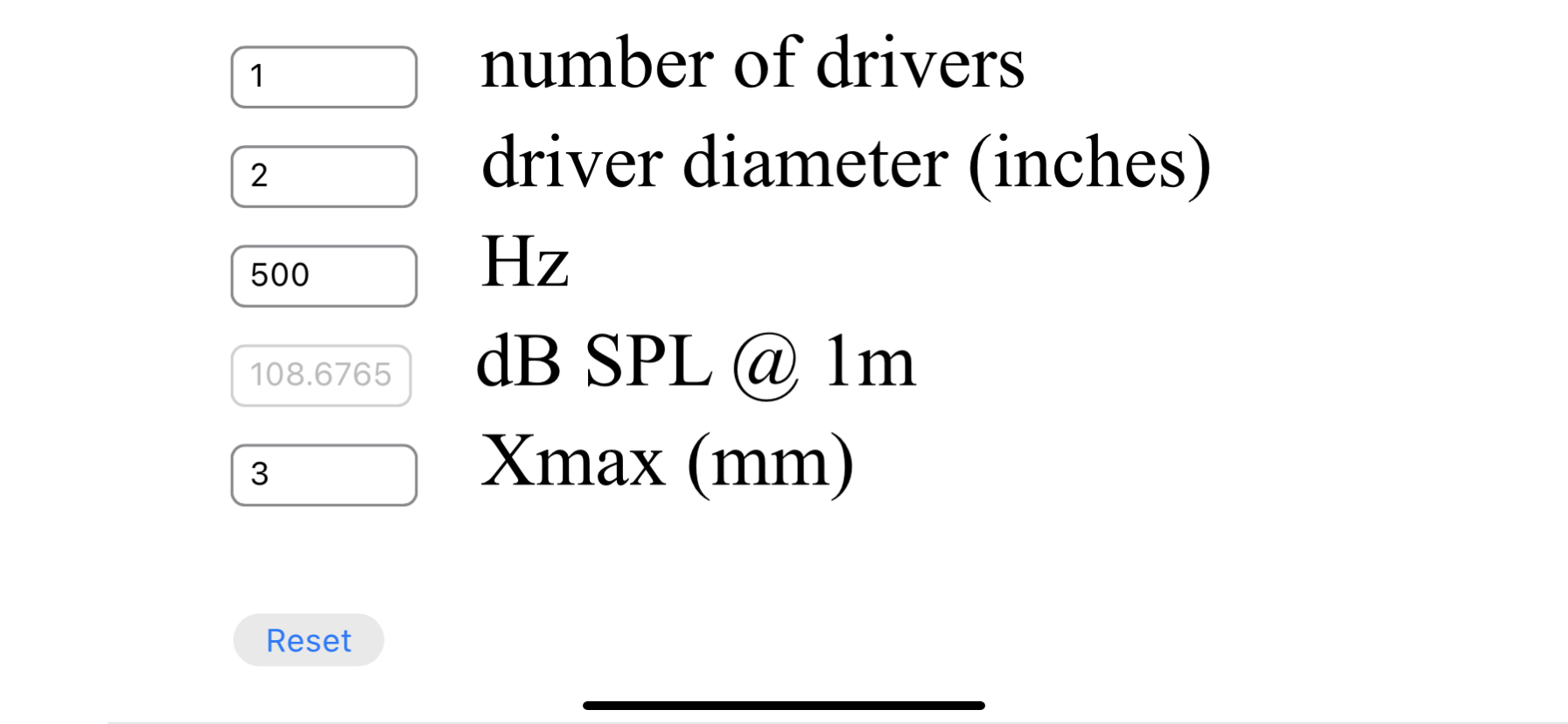

If you fix your constraint to a 2” diameter piston, then sensitivity, power handling and excursion all help.
At higher frequencies excursion matters less. So then thermal power handling eg. Voice coil size and number of turns matter. But the bigger the voice coil the high the moving mass so then and sensitivity goes down. So you need a lighter cone/suspension. eg. Mms and more powerful motor eg. BL
At low frequencies its Vd matters more.
http://www.baudline.com/erik/bass/xmaxer.html

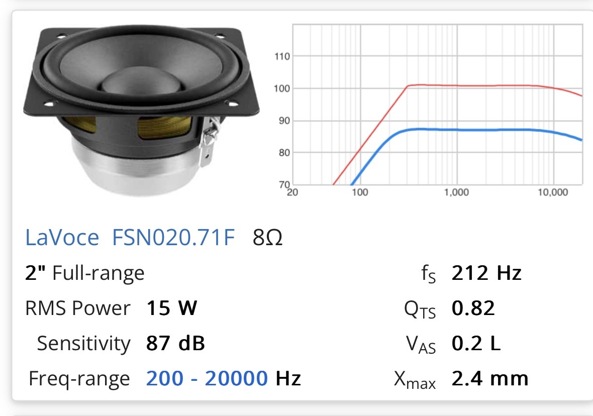

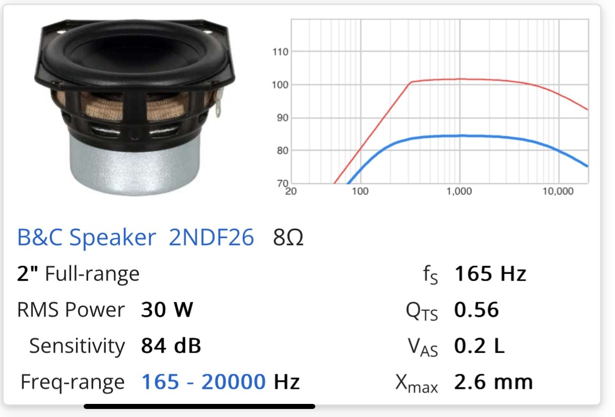

Here’s a shortlist:
http://www.loudspeakerdatabase.com/search/1.6_size_in_2.0/sort=-xmax
My votes are for-

Assuming a direct radiator
Sensitivity for 2" drivers is rather limited.
81 to 84 dB
Max thermal typical to 15 to 40 watts.
Linear excursion 1 to 3mm
Drivers with high xmax make the usual tradeoff
of less senstivity, so max SPL over a broad range of products
on paper may seem better / worse.
But overall Max SPL relatively the same.

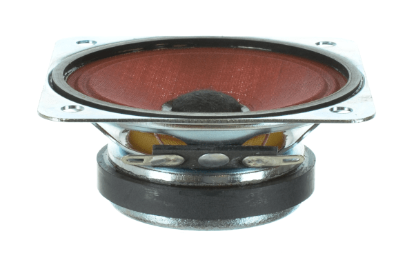

Outdoor applications will use a more weatherproof
cone. And usual coated frame
Misco specializes in outdoor waterproof cones
and has numerous 3" speakers for voice range.
Sensitivity also much higher around 84 to 88 dB
Such as Part # RDC3WI
Misco Outdoor 3"

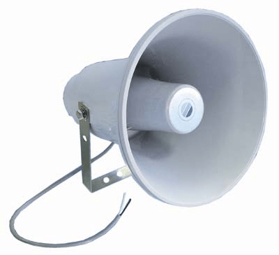

Otherwise outdoor voice would be voice range Horn
Since direct radiators very limited in SPL
3" wont get close to 110 dB at full power
and most horns easily do that at 1 watt
And can go up to 115 to 120 dB
with 10 to 20 watts
