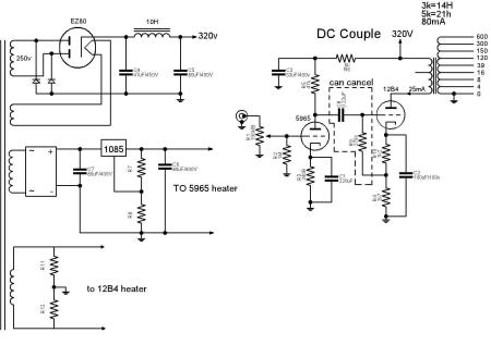

This is the circuit that I considerate was use 5965 directly couple with 12B4. it approx had 1.8W class A Output.
Any advise???

I prepare use the tube rectifier circuit.
use EZ80, 5965/E180CC/12av7 to push the 12B4 SE. It will had high purity 1.8W output.
The rectifier circuit will use C-L(10H)-C.
Can anyone suggest me that the filament of the 5965 & 12B4 use AC or DC? headphone need every low noise will increase the s/n ratio.
Hi, I would like to collect some advise that anyone can suggest me use Directly couple between 5965 to 12B4 or use capacitor couple.
The OPT I order to japan already. It will had 0~3K~5K in primary 90ma. Sec will special for me. 0~4~8~16~39~120( AKG K1000)~150~300~600 Ohm. Core will use 0.22mm Hi-B laminations.
The band width was 70~65K -2db.
3K was test in 13H, 5K was test in 20H.
But the DCR looks a little bit high. had 350ohm. I will test & can japan try to lower the DCR otherwise the efficiency will decrease.
is the volumn of the core increase will lower the DCR???
I prepare to private print the PCB. any suggestions???
thx
Do not worry about it. That is normal for a transformer that has to carry DC current and also low-distortion bass. To get the DCR lower, you have to accept worse bass. Or a much bigger core with more core loss.
I think you have more than enough power even for those very low efficiency headphones.
In line with Pete's remarks about output impedance, you might want to connect your 120 ohm phones to your 39 ohm tap. On the 120 ohm tap, the headphones see about 60 ohm source. I believe that should be low enough, but Pete thinks it should be lower. On the 39 ohm tap, the source impedance (even including the "high" DCR) is about 20 ohms, surely low enough for 120 ohm phones. Maximum output voltage is about 10 or 11 volts RMS, or about 1 Watt, or 104dB SPL in your 74dB SPL/mW phones.

hi PRR,
thanks for your opinions. But if the OPT had same output impendence which same as the headphone. will it really better???
Pls see my headphone circuit!!
I tailor made some parts already. I trusted that the volumn control is very important. So I tailor made a 24 steps Ladder type volumn control. They all use 1/4 watts 0.5% accurate metal film resisters.
I was waiting for japan call back! may be the OPT can improve more!
any comment for the circuit?
The dotted line on the circuit means 5965 to 12B4 choose direct couple or cap coupled.
Filament of the 5965 I suggest use DC & regulator by LT1085 the noise may be lower & 12B4 filament was float up but still choose ac filament the sound will more active!
