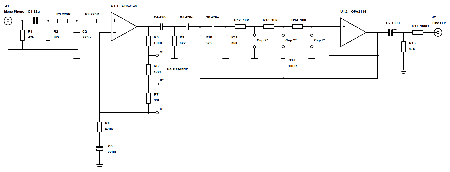

Hello chaps,
Over the past few years I've designed and built a fair few esoteric phono preamps for older mono formats. During these endeavors I have discovered that for a practical preamp, the following features are absolutely essential:
U1.1 is configured as a standard 'all-in-one' amplify and equalise type stage, with provision for variable time constants via switchable capacitors using a pair of 6 pole rotary switches for the bass and treble time constants. A total of 36 curve combinations are possible, including the RIAA curve, of course. Flat gain is 37dB, as the 40dB I usually design for is pushing things a bit for 78rpm levels.
U1.2 performs the bandwidth filtering, using a pair of 3rd order Sallen-Key type filters. As the cut-off frequencies of the rumble filter, a static 25Hz, and the HF cut filter are so far apart, they can be included in a single amplification stage. By switching the 3 capacitors in the HF cut filter using a rotary switch, 4 different HF cuts can be obtained. Very useful. The output is then de-coupled with C7, R16 and R17 to give a low impedance line output.
So there you have it
I have included the list of equalisation turn-overs, roll-offs and their corresponding capacitor values in a PDF document attached to this thread. Also included, are the HF cut values.
As an example to demonstrate the necessity of a bandwidth limiting filter, I have attached (in a ZIP folder) 2 audio examples of Bruno Walter conducting the LSO, performing the overture from Mozart' 'Marriage of Figaro', recorded in 1932. Quite a noisy 78, very crackly. The limiting frequencies are 25Hz and 6.5kHz.

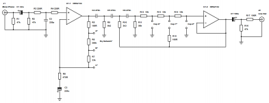

- Separate bass and treble turn-over and roll-off selection for the adjustable playback compensation. This allows a much greater combination of curves to be approximated, as opposed to 12 or so preset curves.
- Monaural operation, and an input stage to match. Parallel inputs from a stereo cartridge require equivalent parallel loading.
- A rumble filter. Ideally between 20Hz and 30Hz. I have yet to encounter anything remotely related to musical material below 35Hz on any transfers that I have made that were released pre-RIAA.
- For 78s - a 3rd order HF cut filter. Pre-war 78s exhibit an upper limit of 8kHz, usually 6kHz, with few exceptions. Post war 78s, possibly 12kHz on a good day. Acoustics, 3kHz. Early LPs may also be limited to 10kHz or so, to protect the cutter head from overheating. It is therefore useful to filter any noise above this limit, with a steep filter, especially in the case of 78s, where noise is triangular and can be very obtrusive (see attached examples, the difference is night and day).
- Excellent overload margins, with it's heavily modulated grooves and high linear velocity a 78 can give a preamplifier an awfully hard kick. Magnetic cartridges are velocity to voltage devices after all

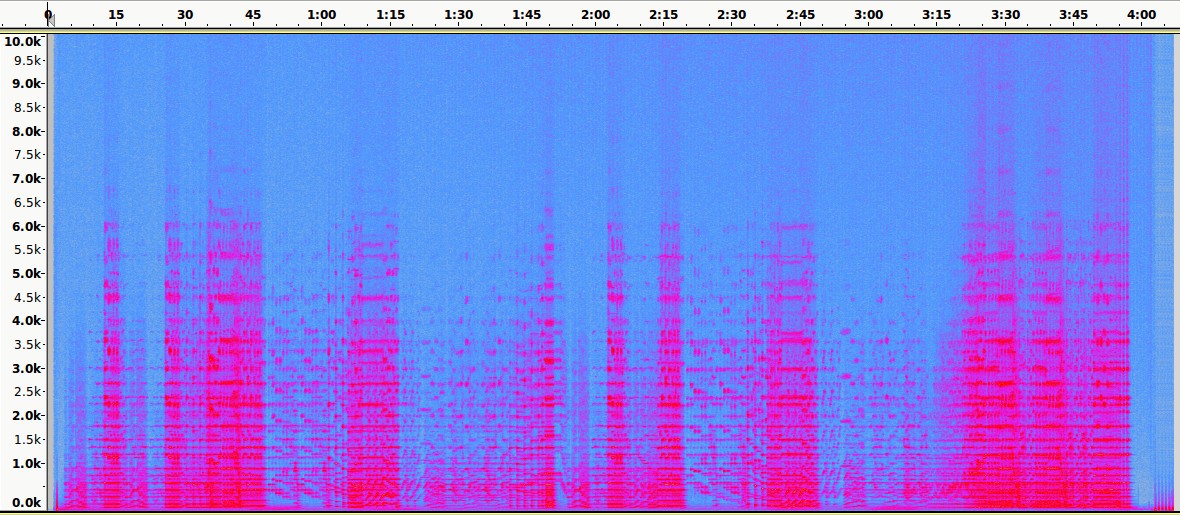

In case you are interested, bandwidth can be determined quite easily by looking at spectrograms. See attached.

Well, there are some mono magnetic cartridges out there. I think Grado does one for 78s. In that case you would want to make R1 and R2 100k to give an input impedance of 50k.
As most cartridges are designed for 47k loading, and will be connected in parallel in a mono unit such as this (mono gives lower noise and distortion when playing back mono recordings with a stereo cartridge), an equivalent parallel loading will be required, so 2 47k resistors in parallel, R1 and R2 as you see in this preamp.
Ceramic cartridges would require a completely different pre-amplifier, as they are displacement to voltage devices, not velocity to voltage devices.

OK, but usually, the most changes are made in the feedback loop, in this case.
I made one more or less like yours, but I used automatic mag/cer change, using a simple HCF4066. In the cartridge, you can see that usually there are two live wires, and two grounded wires, the return. In the ceramic, both ground wires are shorted, and in the mag, not. Then, a resistor giving some filtered DC between the two (now AC) grounded, and a simple CMOS gate detects the short or not, and then, the 4066 makes the constants change needed in the feedback loop to play both cartridges without operator intervention.

Quite a clever solution in your case.
I suppose you could stick an analogue switch at the bottom of the feedback loop so as to turn the gain-stage into a follower.
