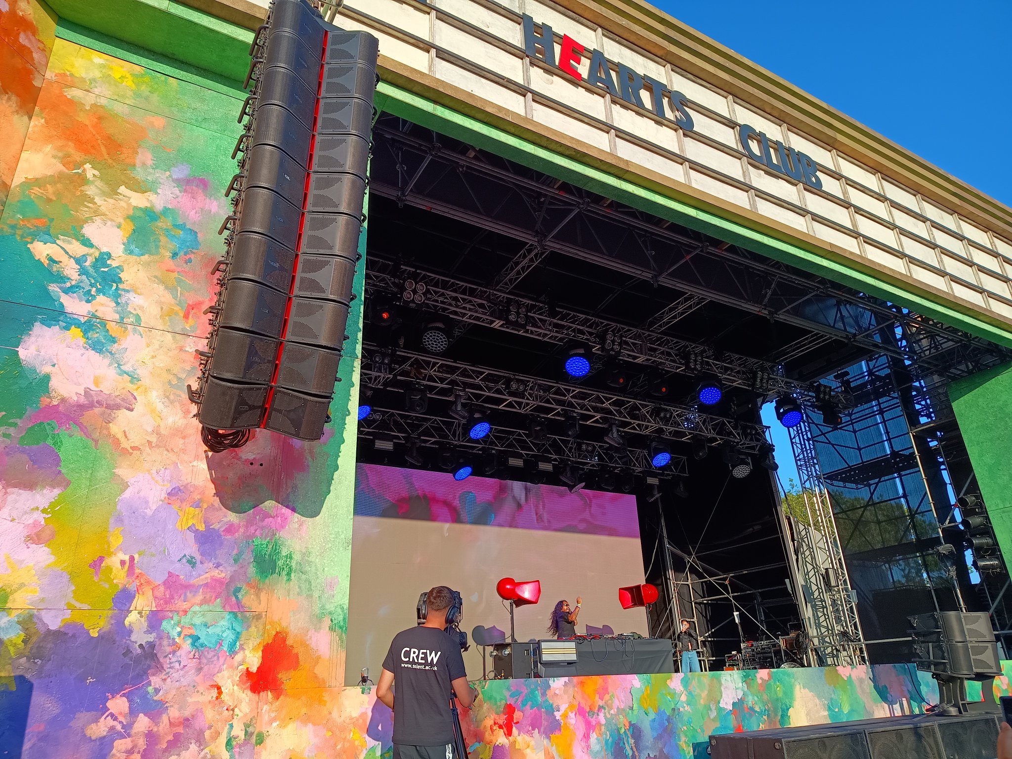

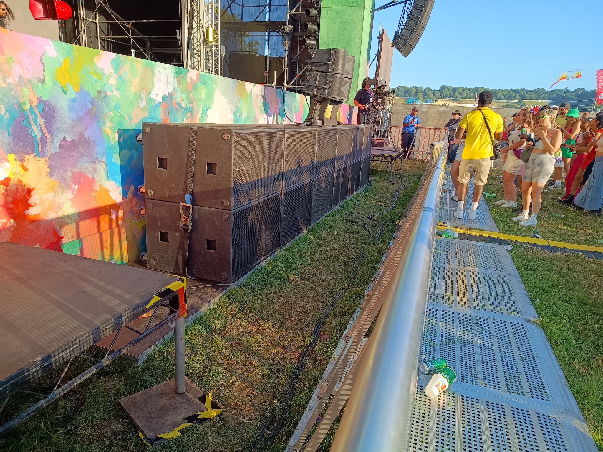

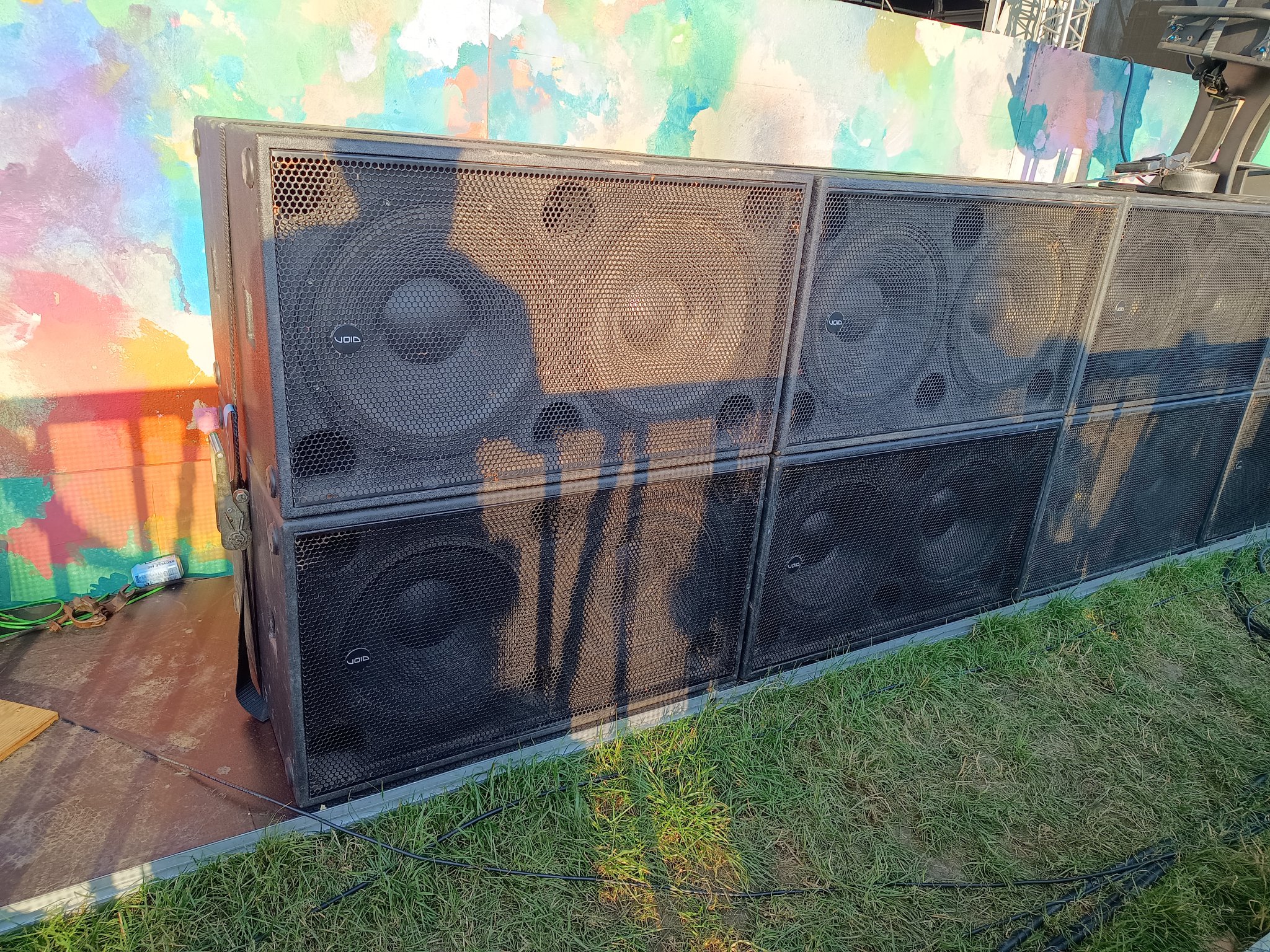

At Glastonbury now Lonely Hearts Club!
Some shots of a Void PA.
Wow!! The subs have round circle vents only....not those KS28 lip like flared ports
Or bassboss diamond shape vents in the middle.
Love the red line on the linear top arrays
I guess I that will sound MONSTEROUSSSS!!!
It did??? 😍😍

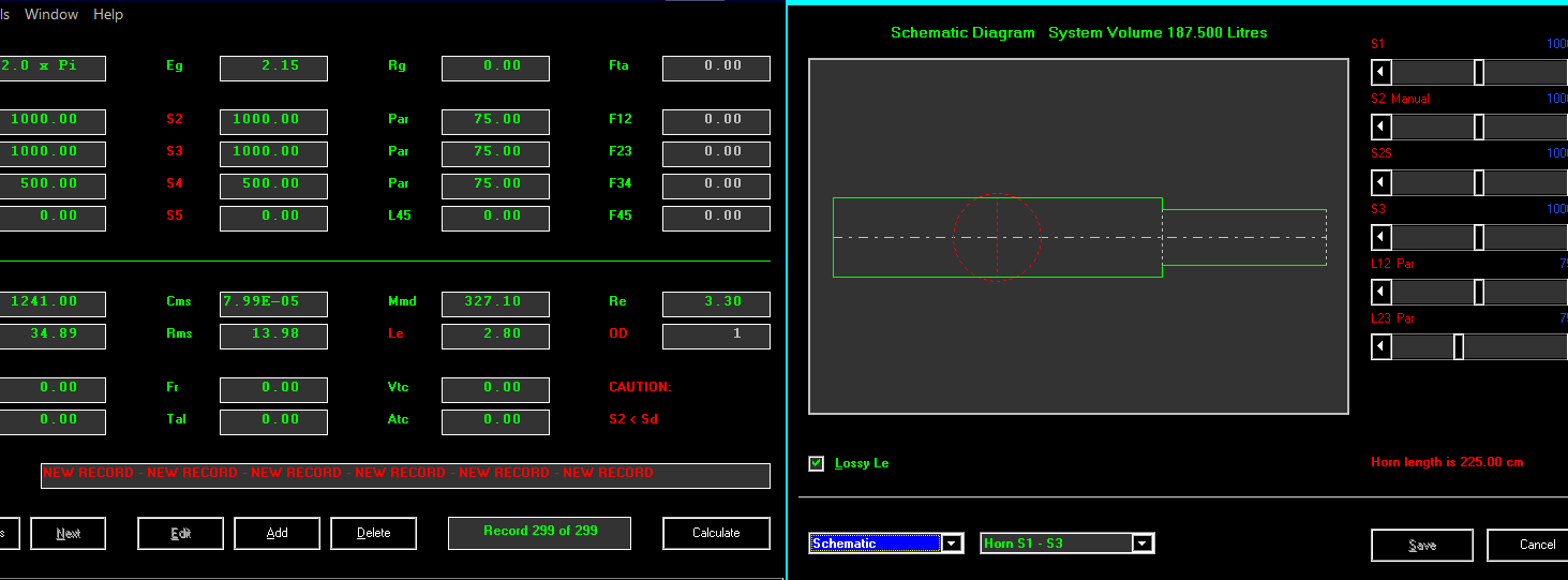

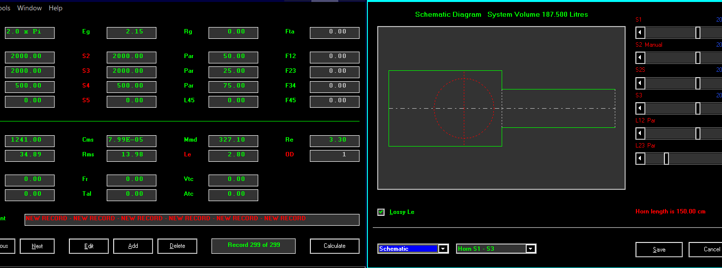

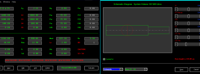

if you ask me what im looking for.... single 18 pa sub that is small around 200L , loud and low 30Hz flat and ohhhh must be lightweight !!
A B&C 18ds115 in a 3 fold 200liter TL ? Shuffle these around and make the last segment 600 cm2 or so if you really wanna ‘push it hard’

I survived the Glastonbury Experience - And had good time!
Got to hear this rig for a good couple of hours - Its one of the small stages scattered around the site with an nominal audience capacity of 5000 up scalable to 7000 with a coulple of delay line arrays if needed.
The subs were used in a horizontal delay to provide a controlled dispersion and as noted only have 6 small ports each.
https://www.tpimagazine.com/void-acoustics-embraces-the-lonely-hearts-at-glastonbury/
Sound was very dynamic and clear but not the deepest.
(The Medal for deepest bass would be awarded to the Temple Stage with its 22 X Danley TH118 system in my opinion!)
https://neuron-av.co.uk/projects/glastonbury-festival-audio-visual-hire/
But as ever at a festival this only being one of many stages would have been subject to a certain amount of noise restriction.
Within its audience area the Volume was more than adequate without too much overspill.
