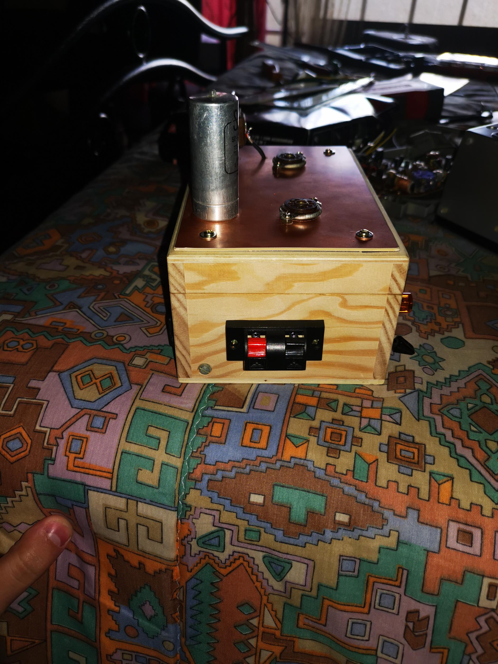

I agree with you but since I wanted to use it with my computer and since I have small children I didn't want to leave open case, so I dicede to make a wooden case or better reagent a used wood box and mount it inside but since I did it, didn't work good, so iam trying to build it better by scratch, my plan is to buy a isolation transformer for the audio and one for the 220 vac, and reporpuse the old can capacitor, it's working OK I mesure with capacimetre and it's OK, now iam just chasing the shecmatic for it if you can help my I will by glad the model as piliphs ag4656

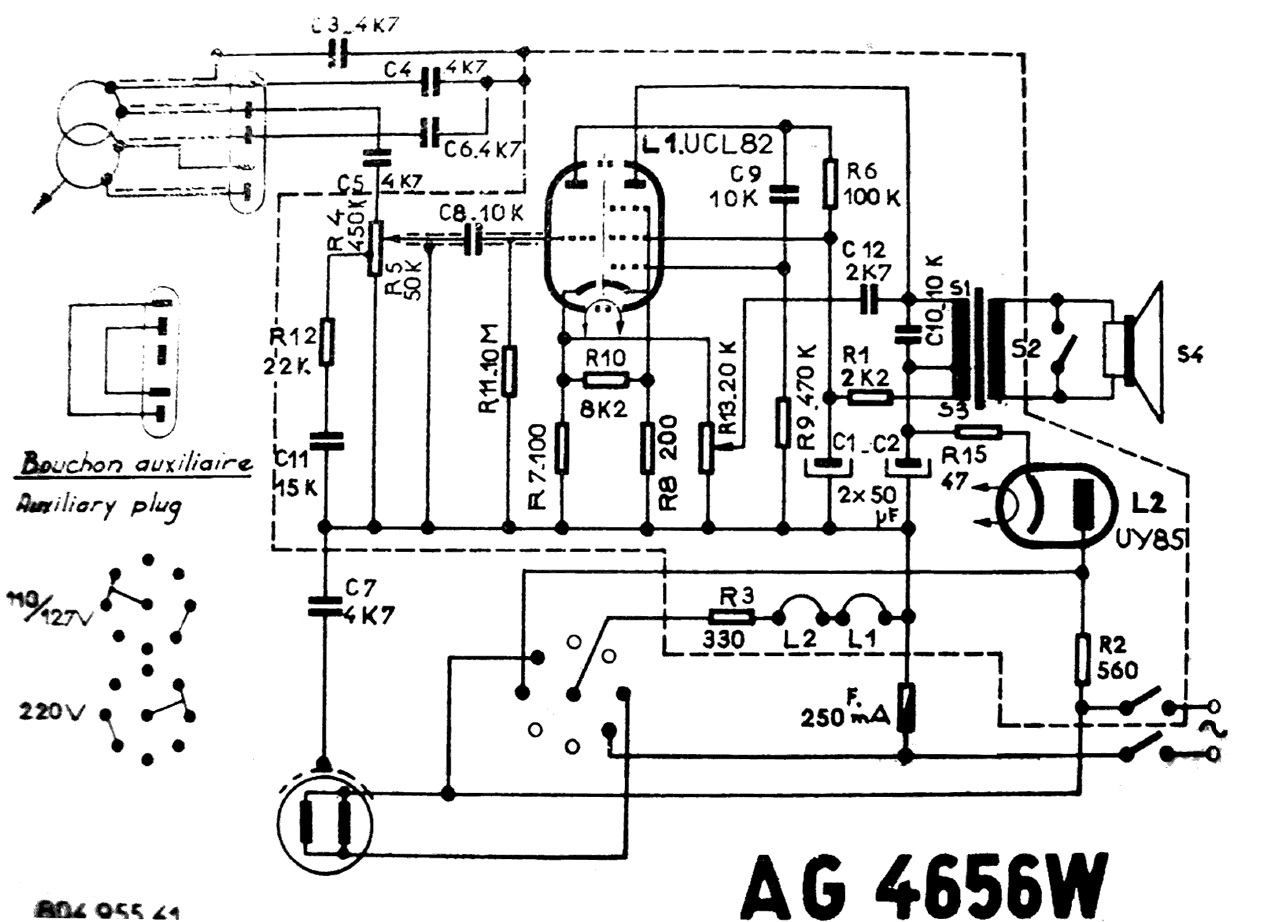

hello iam planing to reporpuse the output transformer, use an isolation transformer for audio and for the 220 v ac, reporpuse the old uy85 the old can capacitor, and the ucl 82 and trying to make it a mono amplifier, but I can find no shecmatic than can suit my the model it belong as the piliphs ag4656 , I thought in maybe ad some mods to the original design and rebuilt again

You have done the right thing by dismantling the original amplifier. It had major electrical safety flaws - the lack of the insulation transformer is only one of them. I attach the original schematic for hystoric purposes only, it should not be used to build an amplifier today. Some capacitor/resistor values are tuned to compensate the original loudspeaker lack of high frequencies and the 50Hz hum.

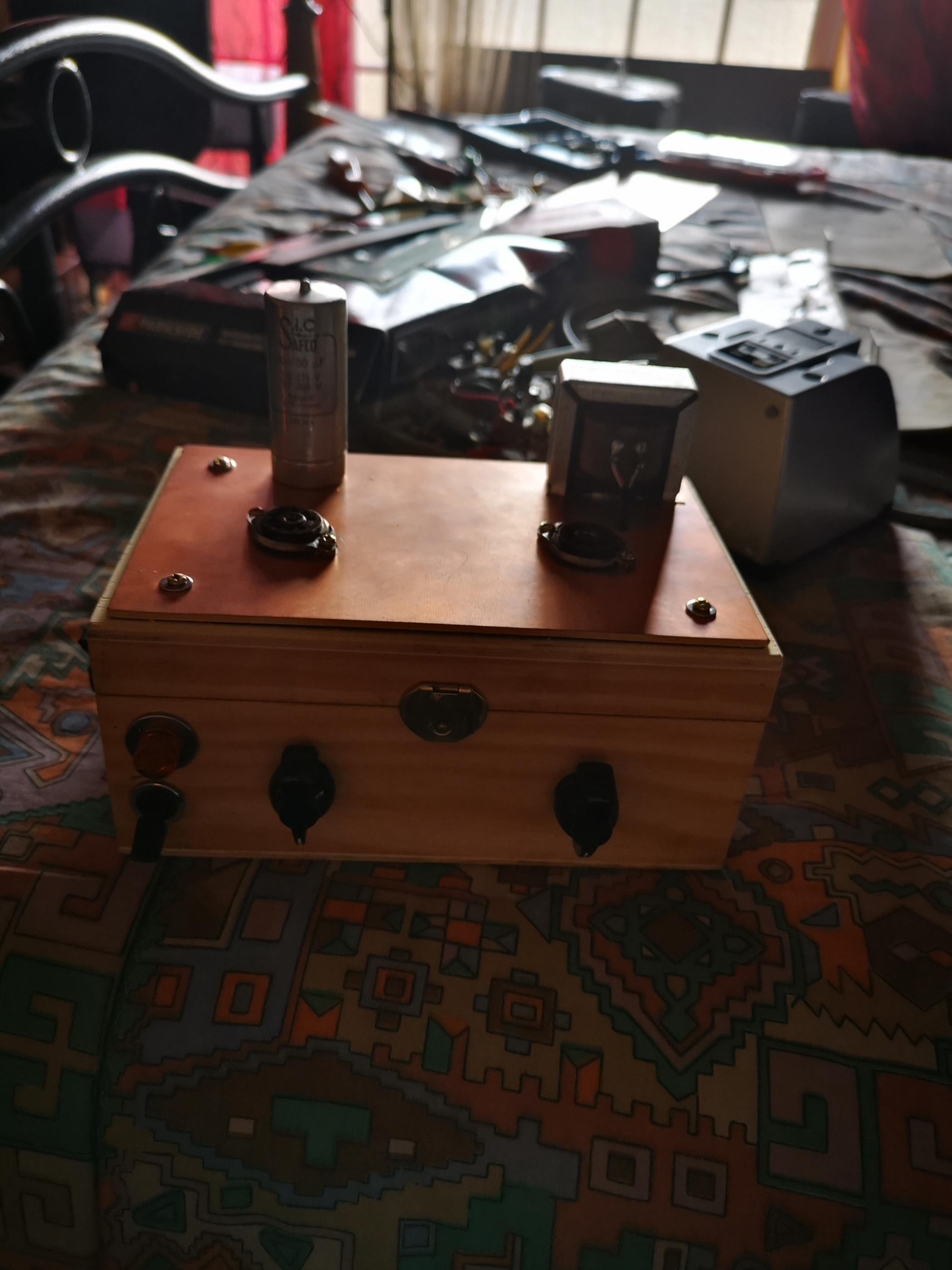

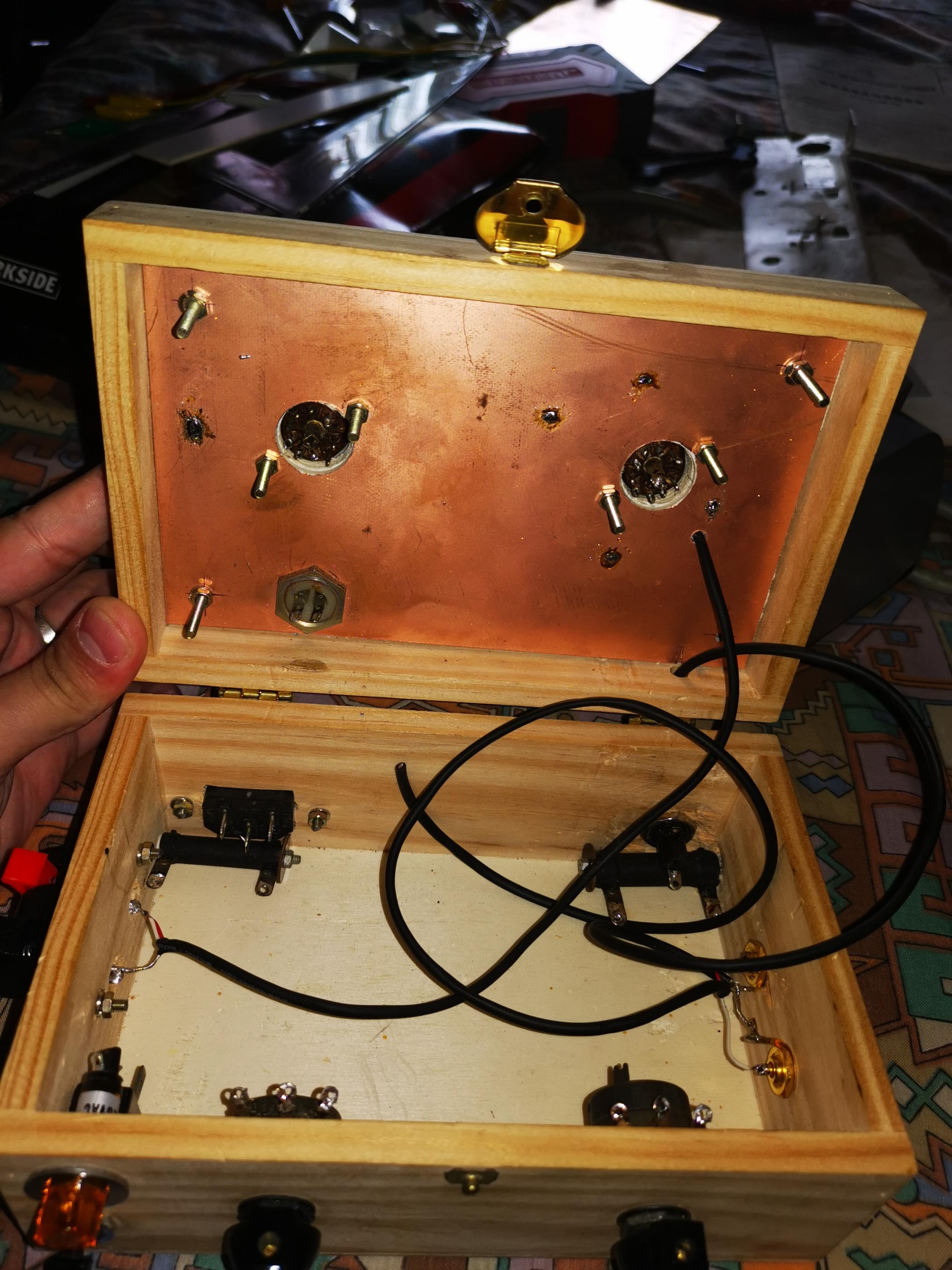

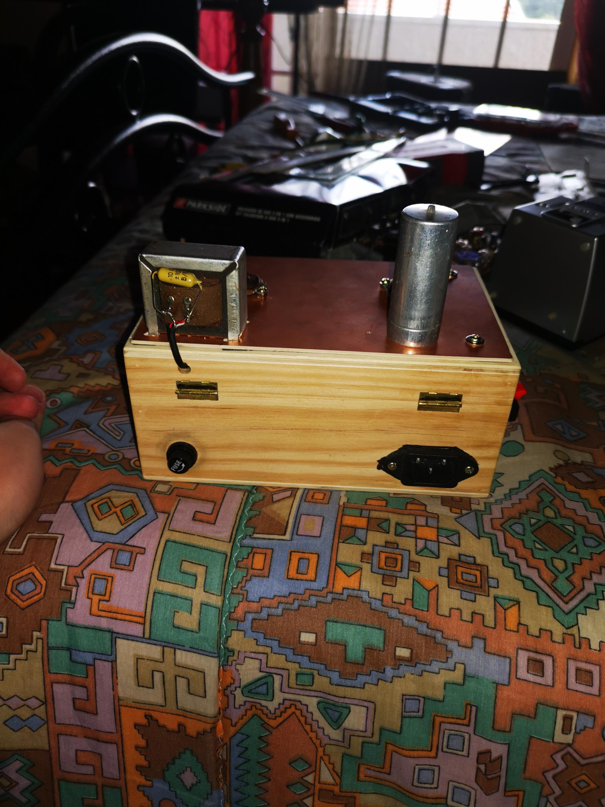

hello, thx for the repply, I wanted to use the 2 valves but if not possible I will jus let the uy 85 with filaments on just as a decorative thing, do you have any shecmatic of a reporpusal amplifier that uses this valve, I will let some photos of the parts I repursed and the valves are stored, IMG_20191027_122016.jpg

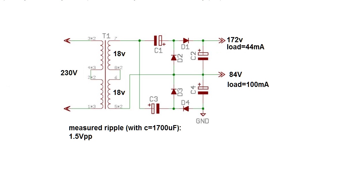

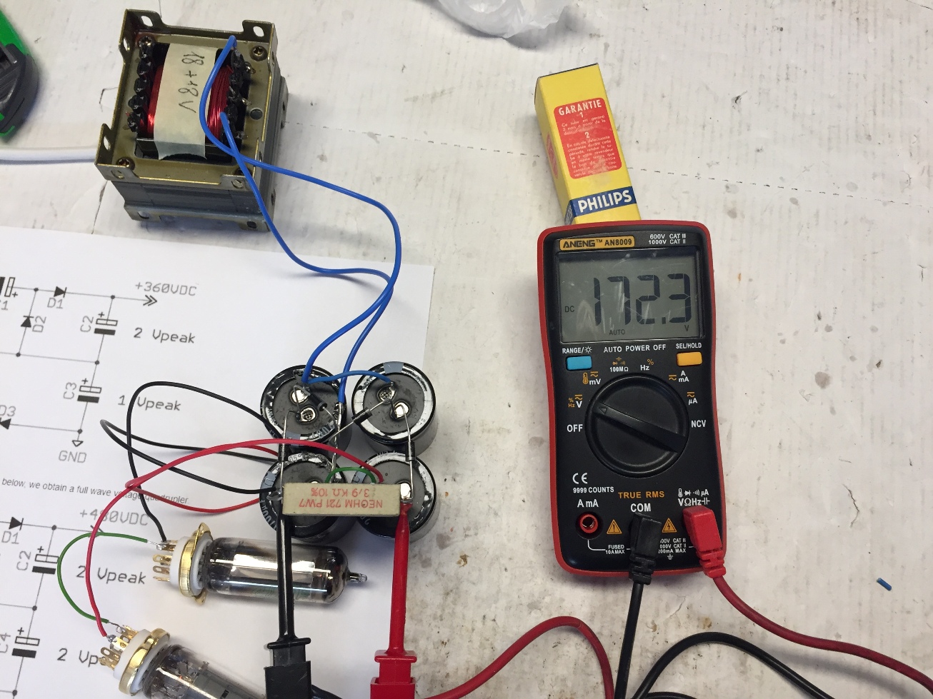

I attach a power supply schematic I have built: it does provide almost exactly the voltages and currents your need. UCL82+UY85 filament supply is DC (no hum), they need 100mA at 88V . The circuit does provide 84V : close enough and whitin the tolerances. UCL82 datasheet does specify B+ = 170V at 41+4=44mA. I measured 172V over a 3.9K resistor. So, with 4x high value capacitors , 4x 1A diodes and a 18+18V transformer it is possible to use the UCL82 while removing the hum due to the high voltage filament and keep the UY85 as decoy. For a stereo version (2x UCL82 - no UY85) a 2x 24V transformer is needed, because the filament supply should rise to 100V and the 200V B+ does provide a little more performance. To optimize costs, top two capacitors may have lower value.
