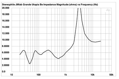

If impedance curve of non Be version of Grande Utopia resembles curve of the Be version then most probably current limit of UcD 180 (8-9A) is kicking in. If listening to the drums is your main objective, you would be better served with UcD400 or even 700. If you listened to anything else besides the drums, I would be interested in your impressions.
Attached is impedance curve of Grande Utopia Be as measured by Stereophile.

HAH! and people think I"m crazy for the size of my little speakers....
I'd love to find an impedance curve for Cerwin-Vega VS-150's if anyone has ever seen one or measured them, they're rated at 4ohms nominal and I suspect will have dips... I'll be driving them from UCD180's as well.
