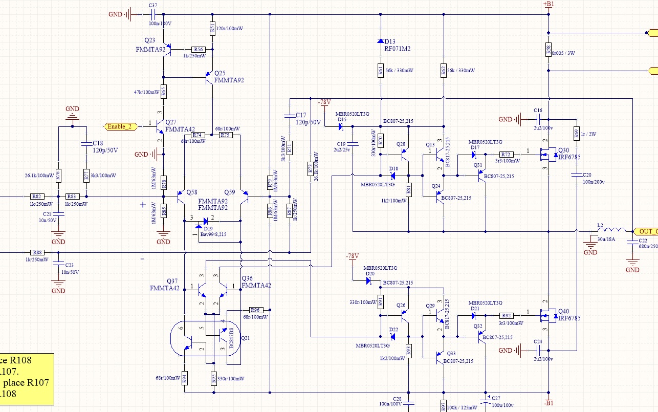

Hello Vinzzz,
Thanks for the reply,
I attached the schematic.
I have this on a pcb and not a breadboard.
The -78V is the +12V referred to -B1, dont mind the capacitor C27 its wrongly connected.
Its a second order mfb differential arrangement.
The aim was around 400 kHz oscillation but it gives 1.1MHz...
Maybe you could see something wrong...
Thanks...

I don't see something wrong (but I'm not an expert), I think it should work. Sorry for the stupid question, but have you connected the load and input? Have you measured L value? Remember that pcb plays an important role for correct working. Have you tried to lower the switching frequency by increasing L and C values? You can try with 33uH and 1.5uF.
PS: I suppose you're testing it with low psu voltage. If not, I recommend you to start with low rail voltage (such as +/-30v).

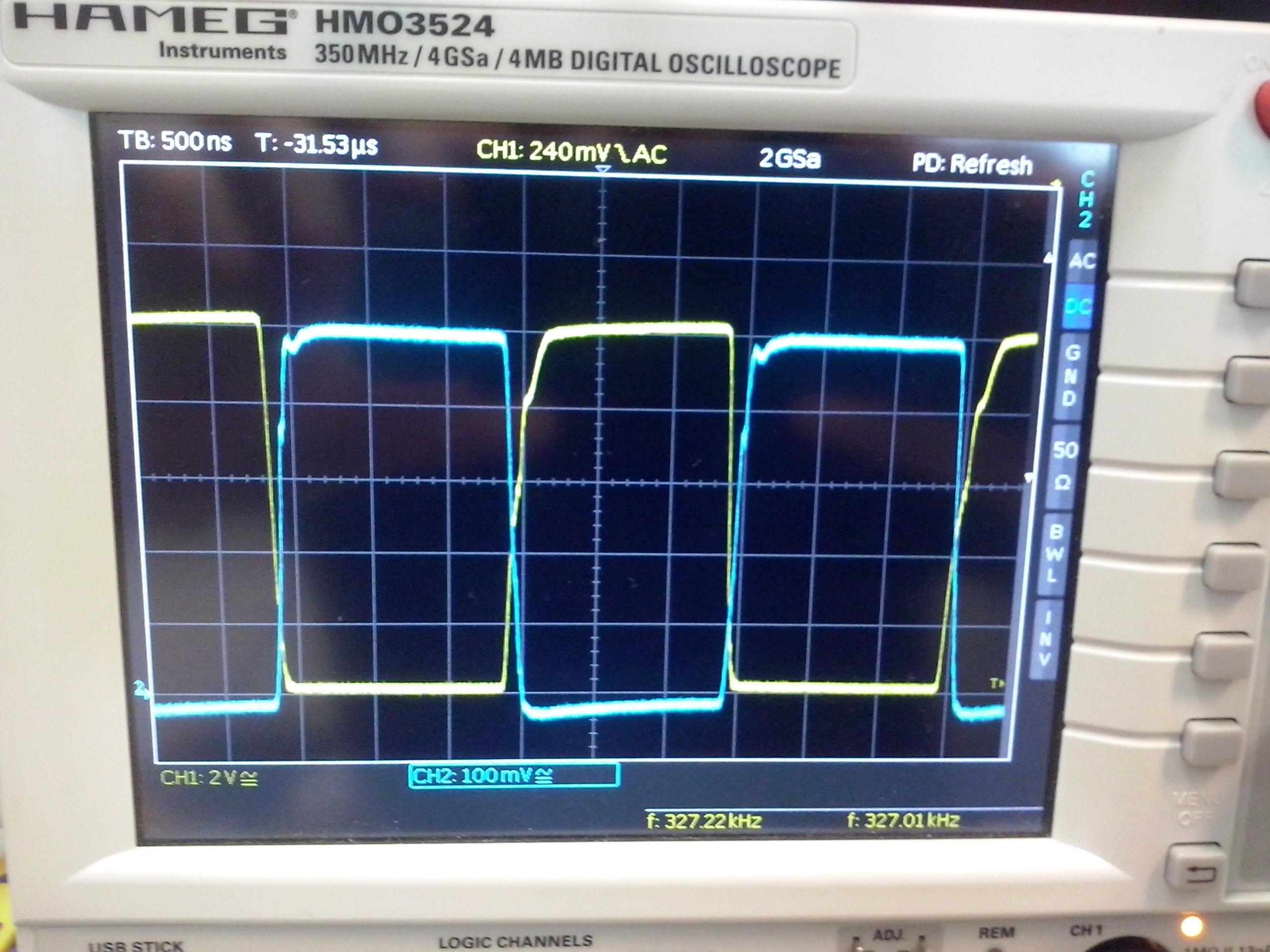

Hello ViNzZz,
Thanx for the reply.
At first it didnt work, then i removed the feedback loop and put a fixed triangle wave at the input of the diff. amp. and grounded the other.
That way i checked both mosfet drivers to make sure that they work properly.
It turned out that one transistor was broken...
When i repaired it and closed the loop (same loop as UM10155) it works.
So i'm a little bit further but have still a lot to do...

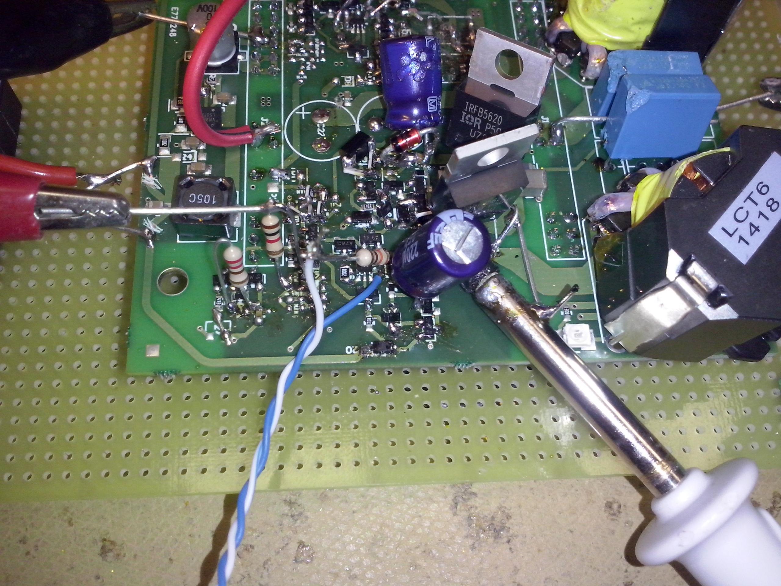

Hello Pafi,
28 = PCB
29 = mosfet waveforms.
Pcb is a real mess momentary, now working on low voltage because i have great difficulty to get the mosfet driving working properly.
THD at around 1.5 %.
But i'm glad it works, so i can work on it further...
Greetz.
