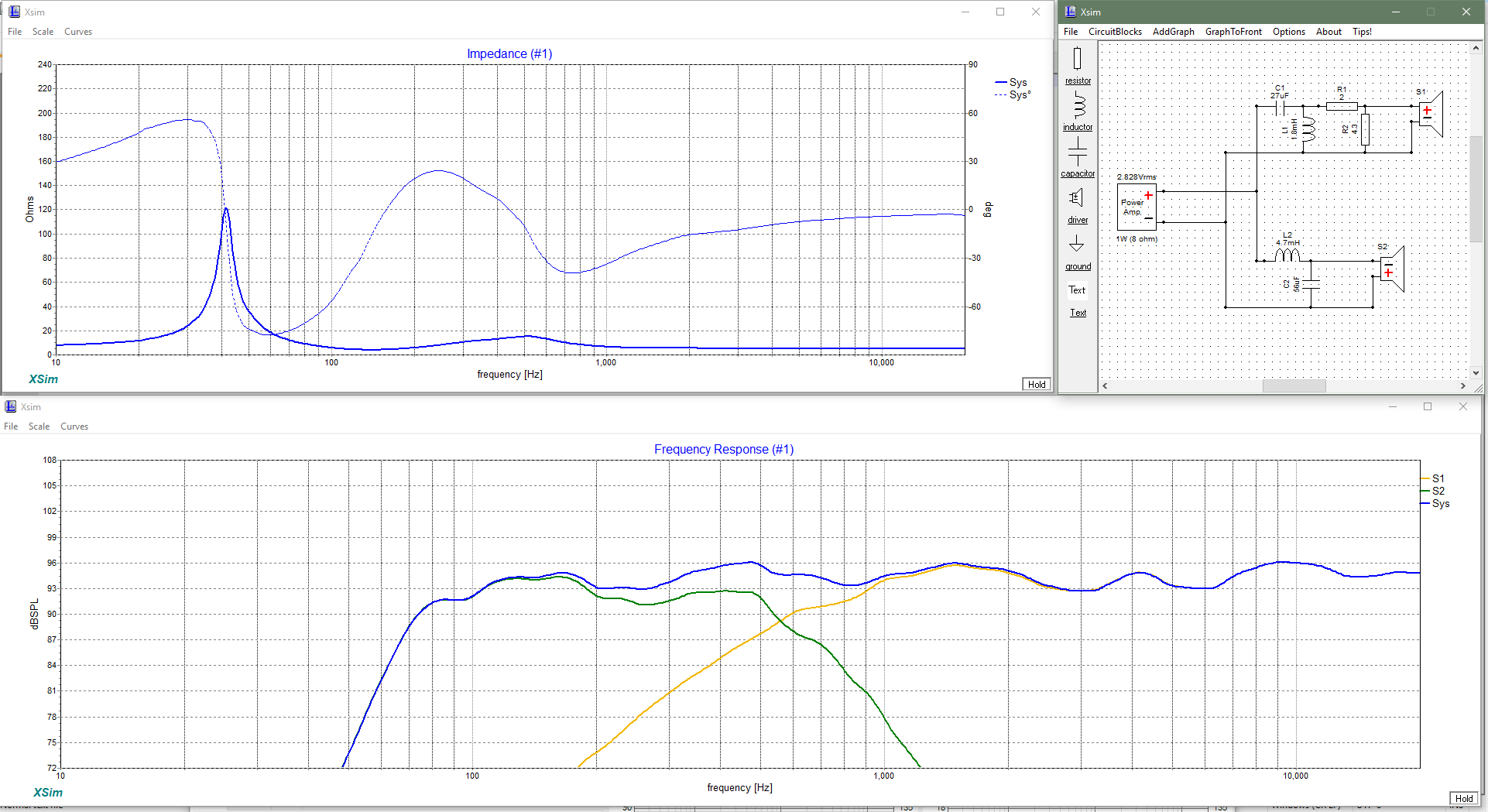

Greetings,
I am making two PA speakers for a medium club, for my music band. They are to be 2-way speakers, with low end handled by one RCF MB12N301 – 8 Ohm, a 12¨ bass/mid-bass woofer, with Neodymium magnet. High end is to be handled by a PA ribbon speaker attached to a cast metal horn (70x30 degrees -- horizontal x vertical distribution).
I need someone who would design a passive crossover for this speaker (schematics and layout) – with top notch components (no need to save money here, it would be stupid). That is number one, while an option number two would also include building those two devices, to be installed in two speaker enclosures that I am making (each a vented enclosure with almost 40 liters of internal volume, tuned to 65 Hz, with one rectangular port).
Crossover frequency is to be 1,4 kHz. Minimum crossover slope should be 12dB/octave. It would be better if it would be 18dB/octave if no major losses are incured (12 or 18 dB per octave - debatable?).
Peak power that both those drivers can handle, short term (perhaps 100 msec?) is 1000 Watts RMS, but I shall never drive them that hard, rather, they are to have peak power at about 500 Watt RMS (AES standard, let us say), but that is tops, while they are actually going to be driven by an excellent Crown stereo power amplifier that delivers two times 350 Watt into 8 Ohm. The 2-way speaker should be 8 Ohm, as seen by an amplifier. The woofer is nominal 8 Ohm, while H.F. ribbon driver is nominal 13 Ohm, but when together in an enclosure and finished, wired, they should be 8 Ohm speaker. Crossover should have protection bulb and other nice features, but it does not have to be ¨studio Hi-Fi perfection¨. It is a speaker for club, for a rock band (not too loud, not heavy rock band... just beautiful sounding band).
For people who know how to do it, it should not be difficult. Learning curve is big for these free softwares and I do not plan to do any more crossovers, so it would be best if someone helps. Could anyone help? Thanks for reading this, give it a consideration. Sincerely, Sven R.

I agree with the post above, but still made some fast (10min) modelling with the curves from the spec sheets (traced in virtualcad, modelled in xsim). This is a very basic 2 way 2nd order crossover that could work in your setup. But to find the inductors that can handle the powerhandling you need, will be hard. You need coils that can handle 1000w at 4.7mH for this. One i know of good quality is a Mundorf L300 4.7mH air coil, and in that spec it cost 220€ a piece (you need 2 of them, and that is only one part of it). Other parts will still be expensive, and i guess your CR may cost more than 500€ per side... It will also ad a lot of weight. I also added the project and the frd and zma traces i made (the software xsim is free downloadeble).
Disclaimer: This is not a finished cr, this is a rough prestudy. Use at own risk.

First of all, THANK YOU for taking time to make a ¨test run¨ and some serious suggestions! Wow, you made me think, hard... this is cost prohibitive, that is for sure... On the other hand, I have seen a B&C company suggest the following X-over for just about the same 2-way speaker... with much less difficulties with the parts... look at the attached file, one of those pages has a schematics of their crossover, passive one, of course... What do you think of B&C X-over on page 5 of this attachment, for a very similar speaker?!

It's hard to tell without the measurements of the speakers (other than you use, but similar layout) build into the cabinet. But they use a similar layout, and added 2 filters to filter out some peaks i think. The Lpad i put in (to attenuate the ribbon) is replaced by some lamps in this circuit.
What you need to do when you are serious about this, is build the speakers, measure them right in their cabs, and then use those measurements to design it like i did with traces of the graph of the drivers from the spec sheet. That is the only way to get an accurate crossover. But remember, the parts, especially the coils, will be very expensive because they need to be able to handle a lot of watts (here you need to take the peak power as guide). You can use that Xsim software i mentioned, that is a very goood package and it's free. Others are Virtual Cad (also free, but harder to work with). You could crossover higher than i did (wich means smaller coils), but they parts will still be very expensive...
It's just easier to go with a good DSP on this level, and with high power systems, the sound is not as detailed so you won't really hear it. But i know what you mean, i also love analog crossovers more than dsp, but only on low power systems.
