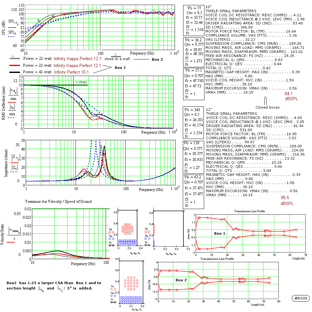

Your 10" drivers should suit this box:
http://www.diyaudio.com/forums/showthread.php?postid=1436141#post1436141
See also the picture 1(1) where a slightly larger box is shown to fit your 12” drivers.
b
1(1)
b
1(1)

Respectfully I disagree; the 12 inch has very high Qms, perfect candidate for a first order highpass and using complementary drivers in a simple sealed box does have a history, especially if one is used as a :filler: for the low low bass.
Yes they are car subbies and should be rolled off early, I'm guessing 80-120 Hz, but putting a first order low pass from the 10 to the 12 and using a simple capacitor bank as well would not be boomy in terms of one note bass, admitted that this aproach would need seperate sealed boxes for each driver.
I have each twelve in a 1.55 cu ft sealed box at the moment under each bookshelf speaker with 250 watts ran in a series so 125 watts apiece. The sound to the amp comes out of the LFE output on my Sony receiver. I have noticed that I am missing some of my upper bass. I guess it is the speakers only going up to 200 hz. So I might need different woofers. What are some suggestions for some 15's or 12's in two sealed boxes. I like speakers with high sensitivity.
I have the two tens left over from my old tower speakers. I seemed to miss some upper bass on them with the tens.
Thanks Y' all, All the input is helpful.
