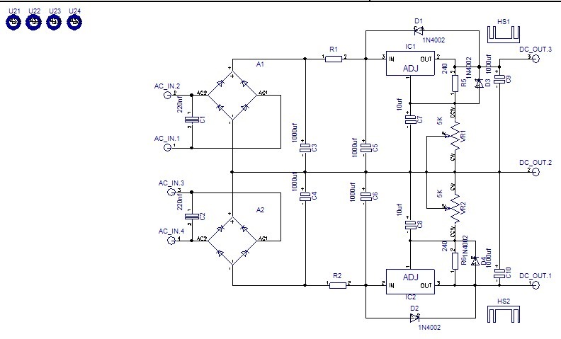

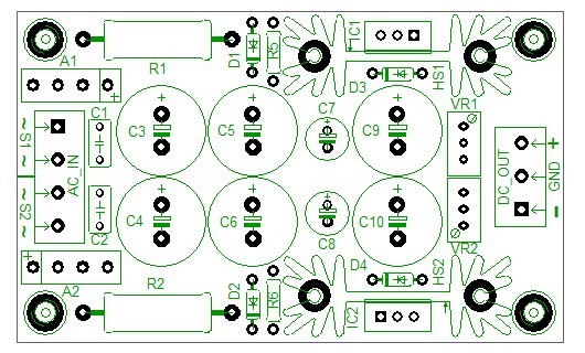

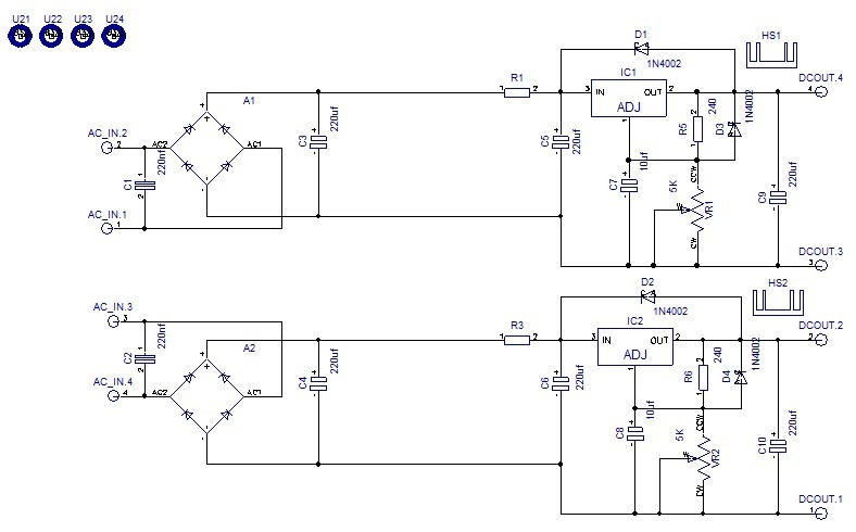

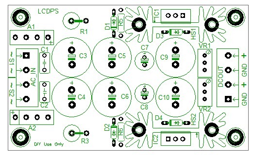

So my main question is about the PSU modules. I was not able to find any info on the Twisted Pear website about them. Can anyone help me understand what transformer to will power them, and what voltages they put out?

Thanks, may I ask what you are powering the LCBPS with? Transformer with dual 15vac secondaries?
So the Buffalo 32S needs bipolar 15vdc provided for left and right (VA). Also single 5vdc (VD).
The COD needs 7.5vdc for both VA and VD.
Each Ventus EZ board takes 12-15vdc bipolar supply.
I could focus on the Buffalo DAC, power both channels with one LCBPS and both channels of the Ventus EZ with the other LCBPS. But it seems like most people prefer to power L and R channels seperately... I assume this is believed to improve separation and imaging?
In that case, I need to scare up another pair of bipolar 15vdc supplies.
If the LCDPS does infact supply 2x ~5VDC, I can use that to power the VD on the DAC and my bluetooth widget. I will just need to figure out what transformer to power this guy- another dual secondary...
