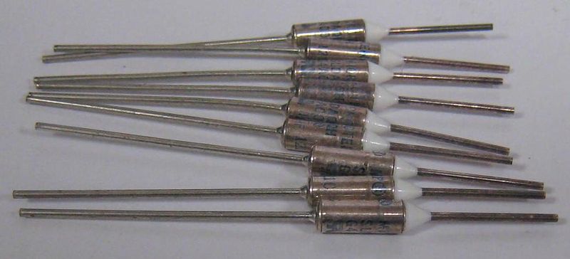

The bigger problem is that the transformer will be heating up over time. It's bad enough that the allowable temperature rise at rated power is something the transformer maker decides. When you draw even more current from it, it runs hotter still. How hot? Depends on run time, ambient temperature and energy losses related to output power in your transformer.
These days transformers don't normally burn as commercially made units have what is called a thermal fuse inside. It is a chemical fuse that opens when it reaches a certain temperature. Once they open, that's it for the transformer. So it may get stinking hot and smelly, but it won't burn out like they used to do. If yours does open, don't touch the transformer. It will stay hot for hours.
so what temperature should i set the transformers thermo cut-out circuit at to shut down the mains to avoid yukky smells?
60'C or 100'C? or what's the norm?
These should be built into the core of the transformer where they will be most likely to be effective.
