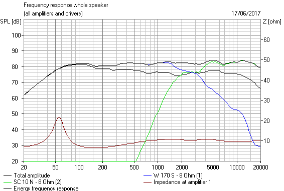

You should try some ideas out in Software | Visaton using the similar W 170 S - 8 Ohm | Visaton and typical G 20 SC - 8 Ohm | Visaton.
Try out this circuit too: CA18RLY/22TAF-G
The 18R + 0.47uF/1.5mH tank notch will just need dropping from 7kHz to 5kHz in my guess. So maybe 0.68uF, but it does little harm to be a bit higher.
Just how it works, but once you have one drivers curve defined, the other one follows, so you can mix and match similar designs, IMO:

BTW, if you want an easy way to get started with boxsim, just find a similar project and put it in the projekte folder, then adjust to taste and driver choice:

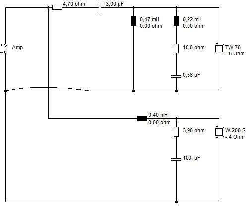

Here are two types of notch filter, this from Goran aka gornir of Audio Excite:
I used one in this slightly complicated experiment. You could probably lose the second half of the bass section:
All seemed to line up:

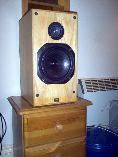

I wouldn't write off that cone tweeter in the Dali hybrid, even if the ribbon doesn't do much.
They have a musical quality:
Visaton W200S + TW70
Good effort from acamilicko in my opinion. About 3kHz crossover I'd guess.
