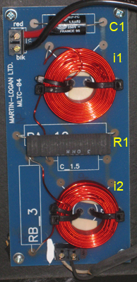

In any case, right now I have a more immediate issue with my current home theater system is giving me a bit of trouble, and I was hoping to have some help troubleshooting it. The problem is that the tweeter intermittently goes out. I have purchased a new tweeter, but the problem persists. I have measured the resistance of the wires, and wiggled them quite a lot to see if the resistance would change, thus indicating a problem with the wire itself (I made that little test up, so if there is actually a legitimate way to test a wire, please let me know!).
My skill set: I have a small grasp on electronics and ohms law. Basically, I can identify parts and give a high school explanation of their workings. I can also turn on my multimeter.
I have attached a picture of the crossover, and have labeled the components just to make any needed communication easier. This x-over is the only thing between the tweeter and the source. This is a center channel, and the highs don’t go in and out in the R and L channels.

Flexing the board a bit to see if there are any cracks in the trace lines and resoldering all the connections on the board is the first thing I would do. It may just be bad solder joints. If you find a crack anywhere you run a jumper wire to bridge it. Also remove the wires from the terminals, strip and refasten.
