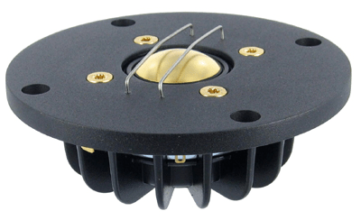

Sealand1 - is this the tweeter you're referring to? https://www.madisoundspeakerstore.com/hard-dome-tweeter/audax-tw025a28-gold-dome-tweeter/
I'm not sure what you mean by "vc" - pardon my ignorance!
Joined 2008
I think I fixed the problem - somehow the tweeter dome got "glued" to the magnet. I took the faceplate off, and the dome came loose with a slight "unsticking" sound. I put it back together, and it worked. I got suspicious when a couple of previously "blown" tweeters still had electrical continuity in the voice coil. This may be a temporary fix, but I'm happy for now.
