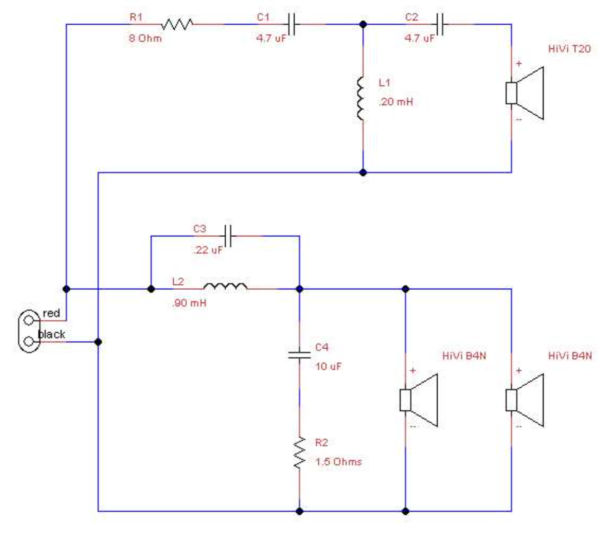

Hi, I'm starting on my first ever loudspeaker project, a pair of Overnight Sensation MTMs.
To complicate things a bit I've bought a special 4 Ohm version of the HiVi B4N woofer that a friend had a surplus of. He had them custom made like that from the factory.
I am making the version with the HiVi T20 tweeter btw.
The original schematic is this:
How do I go about modifying it to use the 4 Ohm woofers instead?

It's not going to work right.
The speakers themselves will have different characteristics to the 8ohm versions.
The crossover circuit is designed to take advantages of the 8ohm speakers in parallel to match levels with the tweeter. Your amp may not like it if you try that with the 4ohm versions. Plus it'll sound rancid.

Don't do it, you'll blow your amp with a 2 Ohm impedance.How do I go about modifying it to use the 4 Ohm woofers instead?

giralfino said:Don't do it, you'll blow your amp with a 2 Ohm impedance.
What about putting the woofers in series instead, then, to get 8 Ohm again?
We though you might try that....at least nothing will blow up.
However - forget the passive xo and go active!

You may find someone over at P.E.'s Tech-Talk forum who's willing to take a crack at properly redesigning the original network ( with your woofers wired in series as an 8 ohm load ).
Running your woofers wired that way is your best bet at salvaging your situation. You'll then need to attenuate the tweeter somewhat by increasing the value of R1 .
Running the woofers as an 8 ohm load ( instead of 4 ohms ) means that ( nominally ) inductor values get doubled while capacitor values are halved.
R2, likely increases to 3 ohms. These changes only apply to the woofer portion of the network.
