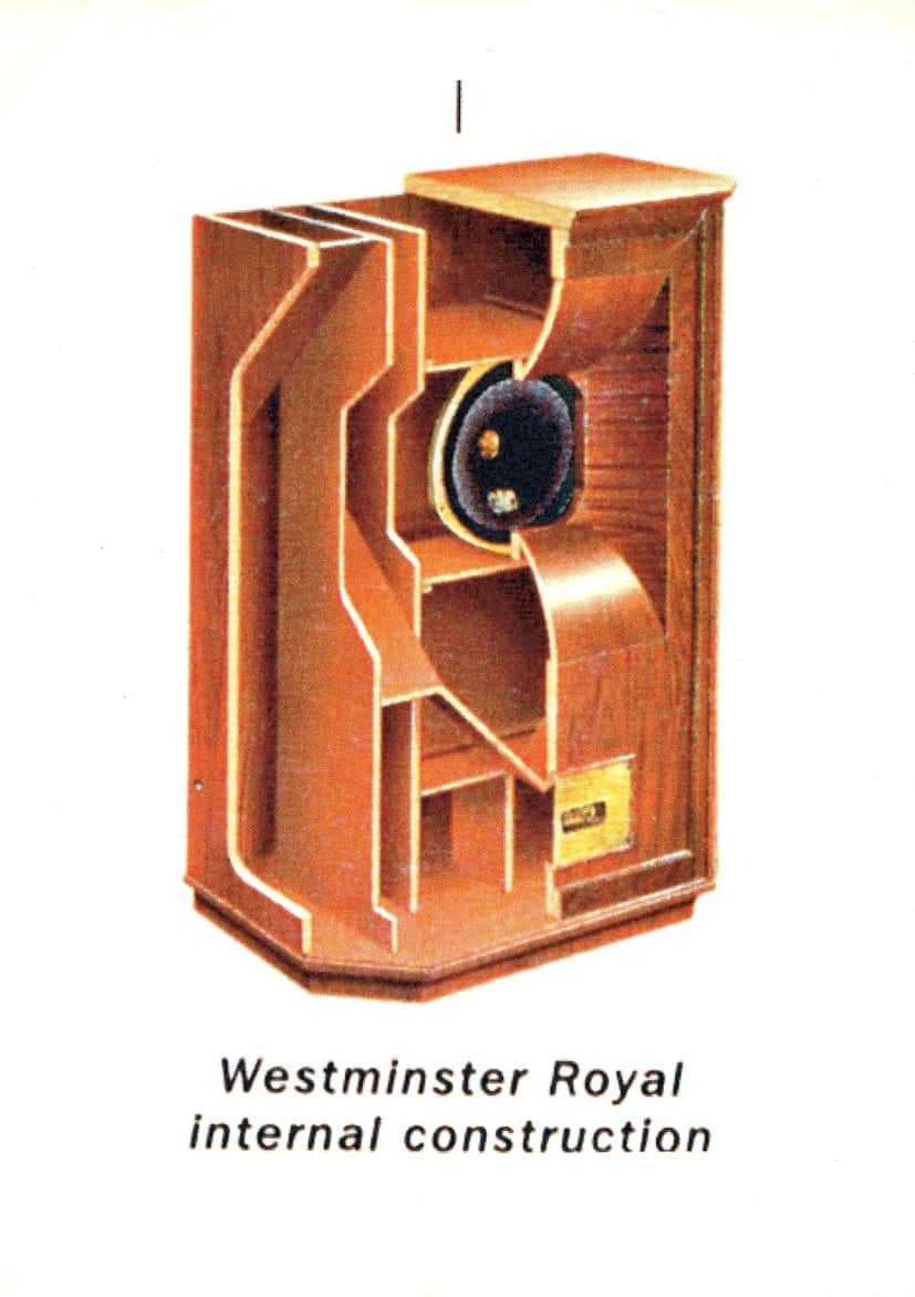

What are the differences between TW horn and Onken type? Are they the same? If not, what are their pros and cons?

What is a TW horn?
An Onken histroically is a low bass shelf tuning in a box with multiple rectangular vents down the sides. Usually couple to a high Rout amplifier.
Lately the same design is used but with a max flat alignment.
And my miniOnken take the shape further and tune very differently.

Tweeter waveguide? You mean the hornloaded tweeter in the coaxial driver?

If you mean the Tannoy Westminster, it's a very complicated backloaded folded horn, an onken is a (restricted vent) reflex with several small but tall vents on the side. They are very different alignments.
Ah. If it's the Tannoy Westminster, then they're completely different. The Onken as usually described is just a variation on the vented box, with ancestry going back to the Ultraflex and Thuras's original bass reflex, where the massive vent system up each side (usually with a combined CSA somewhere in the region of 0.8Sd - 1.25Sd) is used to promote maximum efficiency at Fb. The Tannoy Westminster is a compound horn, with a much more complex internal structure to create a bass horn about 3.6m / 12ft long, and short front horn designed to boost the lower midrange frequencies.
I'm not surprised. I used to see the term 'full-sized horn' repeated by the magazines whenever the Westminster Royal came up. Which it clearly isn't, given the expansion path length & the termini size.

TBH, I've long thought the better option in the big 'proper' Tannoy range was the Canturbury. Simpler (and prettier) box, & probably a more effective loading for most uses.
Internally IIRC it's a lightly braced resistance / frictional load type. The external images are a bit deceptive though, as what looks like the slots at first glance aren't actually full-height. They've got a series of short 'real' slots cut through those full-length insets & you can adjust the practical height of them with sliders at the base. From memory, there's seven per inset, so fourteen per side, the uppermost being roughly level with the driver centreline. Even fully open, they aren't huge so something like a Thuras reflex or Ultraflex it ain't.
