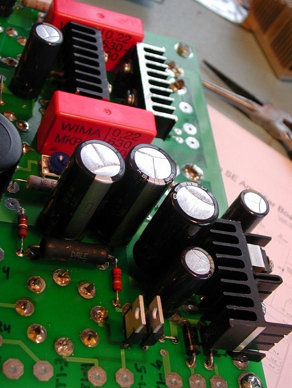

Are my heat sinks big enough for 300B's?

Maybe just little bit. Mine (300B TSE) is not much bigger than what's pictured and it works.The one on the regulator/rectifier needs to be quite a bit larger.
Are the heatsinks for Q1 & 2 and U2 & 3 mounted to the board or are they hung off of semiconductor leads?Everything except the tube sockets is bottom mounted.....
Well, I suppose I'll try them out.....the regulator has thermal protection, correct?
I have other PC CPU heatsink organ donors, so if I can shoehorn in something bigger I'll do it.
They are hung off of the semiconductor leads.
