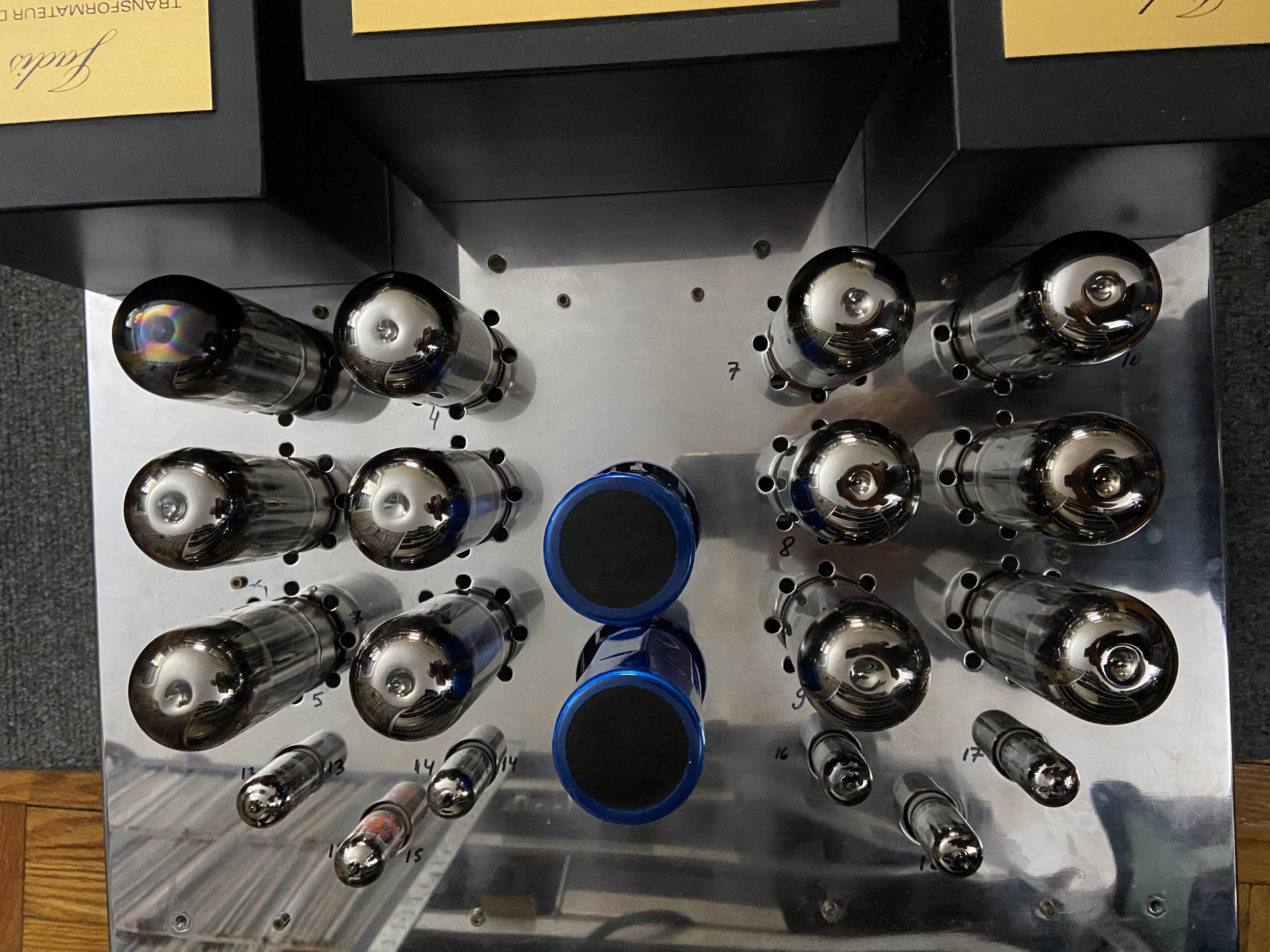

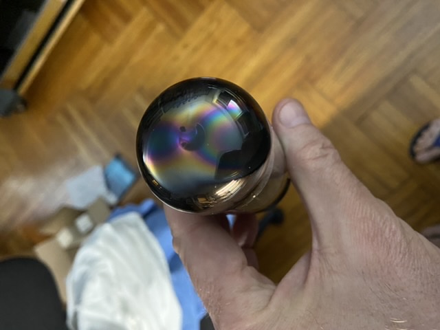

What would cause a 6550 turn black and rainbow at the top? It was supposed to be new, I put it into this Defy 7 (yeah, I know, pls don’t ask) that I’m working on, and it played fine for an hour or so, but then I saw it change color and shut it down. All surrounding circuitry tests fine. Socket leaking?

Looks like only the top left one? If so a knackered tube, bad luck. Get another and soldier on. If its general then there's something rather wrong with the circuit. I imagine these are el34 Siemens/rft tubes?

All 12 have the same hours on them...

you have to replace all of them in one go..get an octet...
but if no other issues other than the visual, then go on using those..
Jadis amps are known to act like firecrackers according to some accounts...

Hi. Thx. These are “standard” Svetlana 6550C. I can’t find anything wrong with the circuit. Unless the socket itself is cracked? Funny but this tube actually tests nearly new on my BK747... Mystery.

pin 3 and pin 2 is where the arc overs occur, unless your sockets are good quality this can happen..a high voltage high temp rtv dope between the pins might help...
Maybe you have a crack along one pin.

I think a crack would explain this. When I got the amp, there was a chinese kt88 sitting in this #1 tube position, and it was fine, and still is fine. Of course, because its bias is so much lower when its stuck into 6550-biased line-up. Need to find a good black socket...
yes, the micas between plate and g2 is the shortest path in between them..

The colors you see are produced the same way one sees colors on an oil slick, or thin film. Its an interference pattern cause by the varying thickness of the film cancelling one reflected wavelength. What we have is a rainbow minus a wavelength with a different wavelength missing as the thickness varies; its physics!

It's getter is half knackered. At best it will have a significantly reduced lifespan, at worst it will gas out, lose its bias and run away with expensive consequences. IMHO its not worth the risk in an amp like that, best thrown away or, in extremis, left in the parts bin for eg. Prototyping or similar well monitored applications.Sounds great! But is the tube still good or it’s it caput?

IF it had been like that for a long time and still working, *maybe* it got an extra thin getter layer, or glass there has uneven thickness, which might have the proper thickness to produce interference "rainbow" patterns ... BUT it happened in a short time, literally before your eyes, that means that the suspected leak must be quite real and significative.Sounds great! But is the tube still good or it’s it caput?

Your description is worrying to say the least, I would not use that tube again.

There is obviously a problem with this amp. Position #1 is killing tubes.

I have the schematics. Plate voltage is specified at 465v @ 110vac mains. At our normally high 122vac line I measured 485. Bias is specked at 4vdc between ground and cathode resistor (fussed), 180 ohms, which gives us 22mA, not too bad. Voltage on grid resistors (474k) specked at 62v, measures exact. So the only problem I see now is around the socket in tube # 1. If small caps around it were shot, I wouldn’t get correct readings, would I? Arcing in socket seems more and more plausible. Should I use a ceramic socket?
