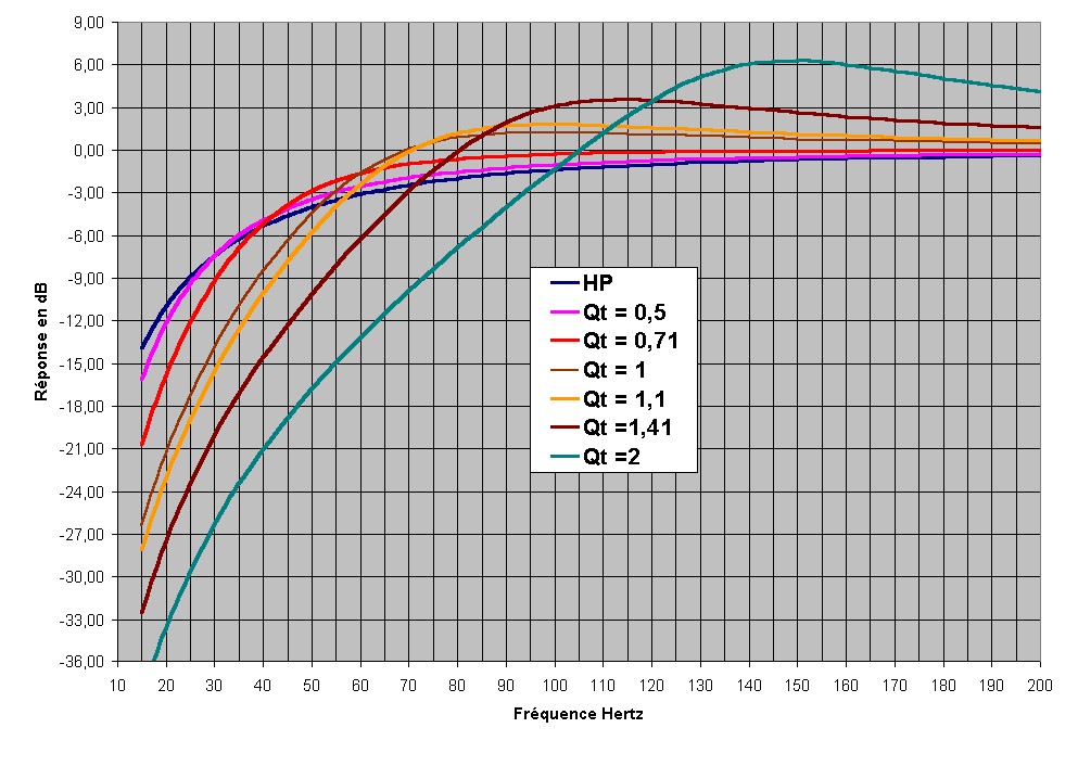

Better enclosure is a sealed about 1.5cf that you can get as much bass as the reflex. With the sealed you have low extension with F3@39Hz and Qtc of 1, 1.1 (~) as good as the reflex with big ports. Bigger volume makes a lower Qtc what might be OK. You can also work good for a LT with the sealed, if you know what I mean. Have fun

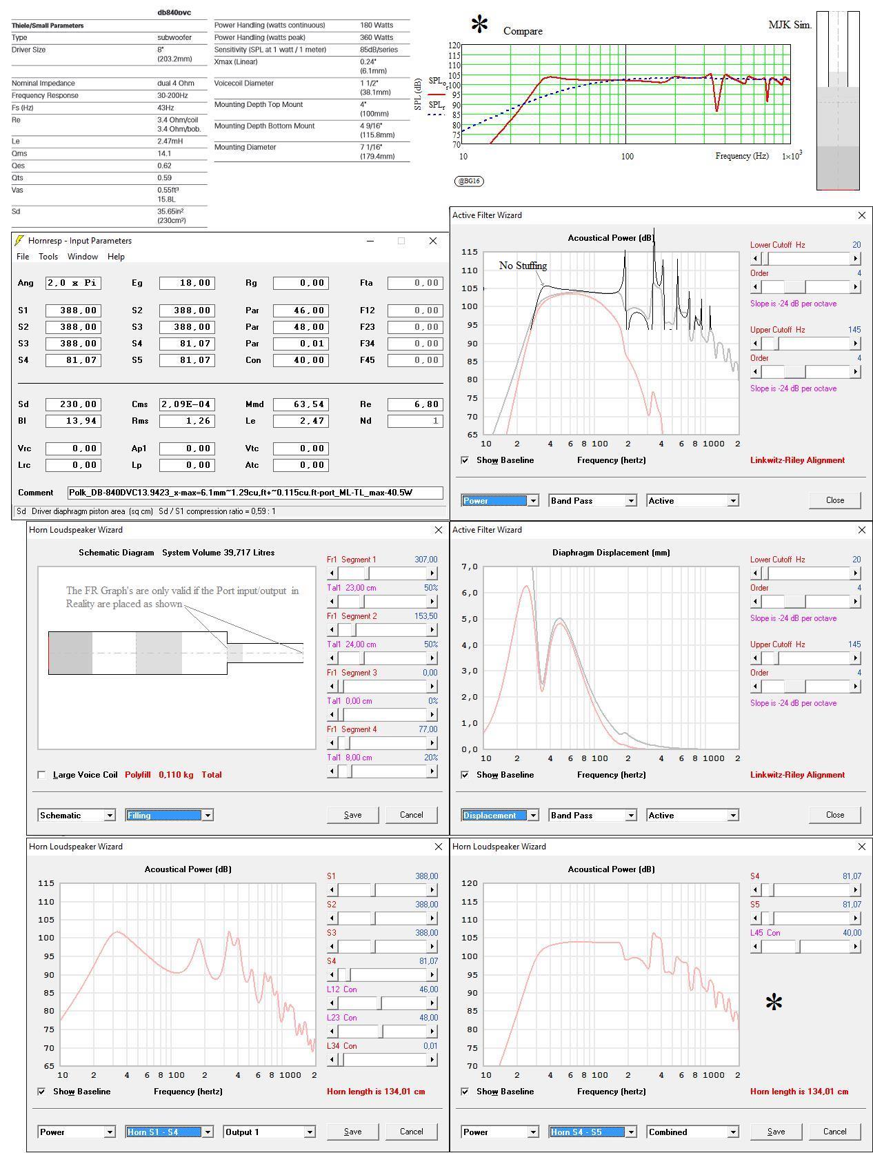

I haven't messed with LRTs in ages, but at the time it was decided that they shouldn't be used on vented alignments, but there's been huge advances in DSP since then, so kind of curious myself, though a quick search didn't return any results beyond its use for sealed alignments only.
FYI, it's generally not a good plan to tune a vented alignment < ~0.707x Fs unless corner loaded and/or a hi-pass is used to protect it.
GM
GM

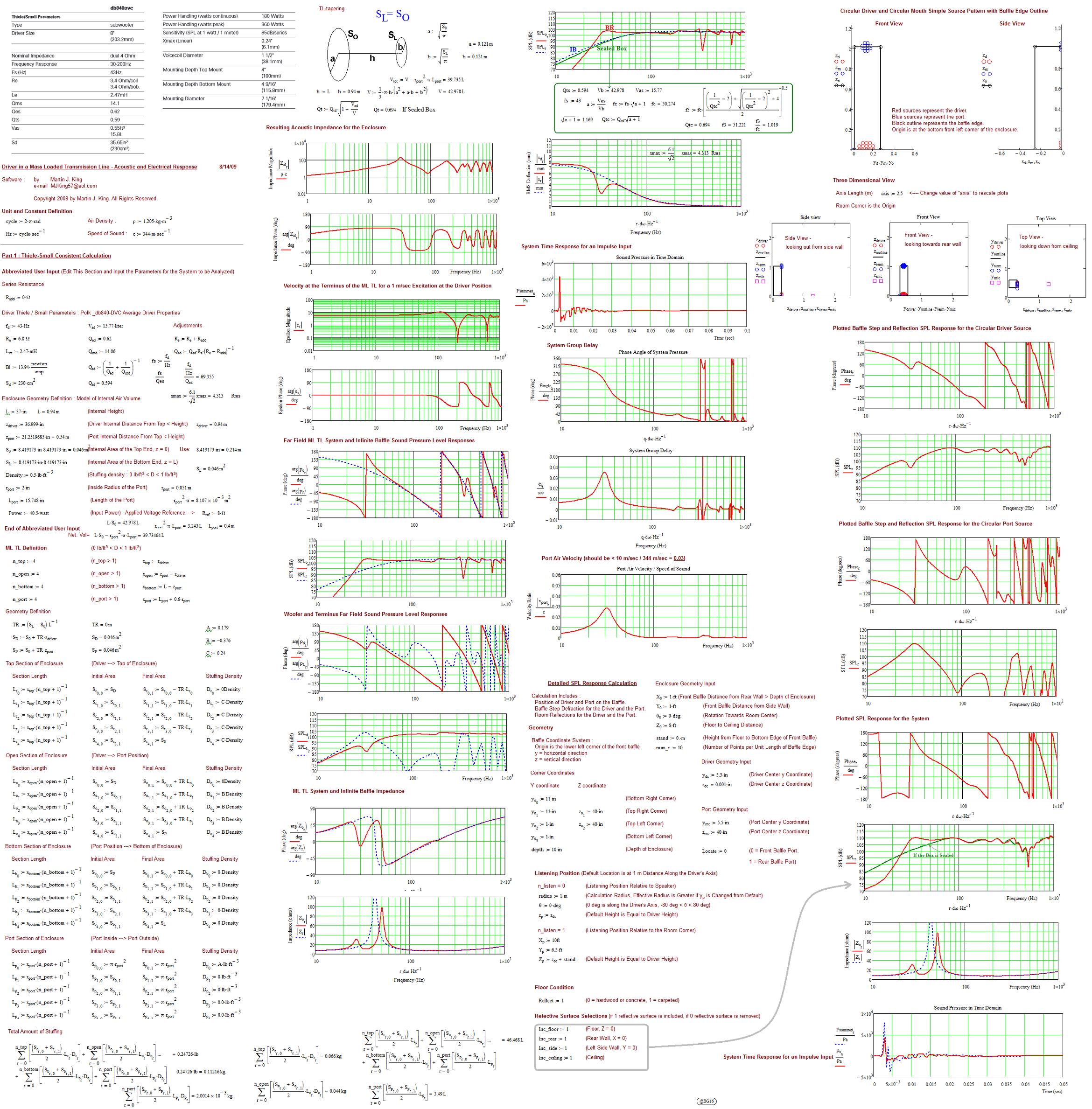

Not 100% sure what I am looking at there, but the total system response looks pretty flat from 30 - 100 Hz in the SPL graph, which is where I will operate. So maybe the 8 inch car sub is OK? If not it would be very little effort to change the mounting plate to accept a 10 inch driver and run sealed since enclosure volume is the same. I have a 150W CO2 laser cutter so making up new plates is a breeze, and MDF is cheap. The DB840s are just collecting dust, so may as well try them out.
