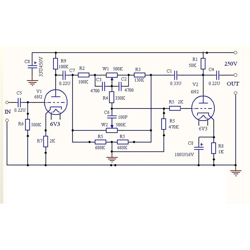

Although they're not drawn like what you see in most schematics, it looks like there are two pots already, labelled W1 and W2, both 500k. I don't think I've ever seen pots with values that high before in a preamp or amp, though.Hi,
I want to add a potentiometer for volume control to the tube pre amp in the schematic. What should the value of the potentiometer be? Will I have a problem?
I'm no expert, but that circuit looks overly complicated to me. The 6N2 is the Russian / Chinese equivalent of a 12AX7 which has a mu of 100 but the pinout is different and their heaters are 6.3v only. So the preamp will likely have much more gain than necessary.
So, I do think you'll have a problem but I doubt it will be related to the value of the pot.
What amp will you be using this with? What is the input impedance of the amp? How much signal is needed to drive it to full power? You really need to start by answering those basic questions and then choose a circuit that fulfills the needs of the amp.
Most all modern amps don't need any gain at all to be driven to full power from a line level source. Sometimes an active gain stage can improve the sound but, IMO, using a design that has a huge amount of gain when none is actually needed doesn't make much sense.
Some of this - pot values and placement options - is discussed in the thread linked above. You'll need to read through the thread, though, not just the title.
In terms of gain, the design you posted seems to use two mu 100 voltage amplification sections while the one in the thread linked uses one mu 20 amplification stage and a cathode follower stage which adds no gain at all.

Those 2 pots are the Tone Controls.

Volume Control:
Put a 50k pot from the input connector signal to ground, and the pot wiper to the grid (or better yet to a 1k grid stopper resistor and the other end of the grid stopper to the grid).
Done.

I would install the pot at the input, right after the 0.22 cap. The viper connects to the input grid but keep the
grid resistor(500k)
Pot should be of the "log" type as it corresponds better to our perception of volume. Value of pot is not
critical, the sources ability to drive is limiting here, bit 100k could be a starting value.
grid resistor(500k)
Please note that normal sources will have no trouble driving a few kOhm and this device definitely will have issues with that. So it will be worse in that aspect compared to the sources driving it possibly leading to low roll off. Output capacitor is too small for modern amplifiers. It lacks GND reference resistors at the outputs (and the novelty called muting) so it is dangerous/unpleasant to both users that change cables and connected amplifiers certainly if these are solid state. I always chuckle when I write "solid state"
In its current state it will be an effect generator like many ChiFi tube devices. Volume control should be at the inputs before C5 and today 10 kOhm log is one of the better choices unless one has tubed sources.

I believe that circuit is a Chinese PCB for a Baxendall tone control, and it has been featured herein the past. The usual misconception is about input and output impedances since, as mentioned above, it needs another stage to drive a lower impedance output.
Position choice depends A LOT on what signal levels or signal input/load we are talking about.
If signal driving it is 200mV or lower, say it´s coming from an input RCA connector selector in a Preamp, choosing from Aux - Tape - Radio - CD - etc. it is better to put volume control at output, since it will not only control Volume but also attenuate hum-hiss-buzz down to zero when lowered.
100k Log would be a proper choice there.
It will NOT clip since it has Gain (when set flat) around 40X.
Given those plates as shown can swing up to some 60-70V RMS before clipping, input can handle up to 1.5V RMS, an ample margin/headroom.
Now if we come, say, from a DAC , say some 2000mV RMS possible, we ned a volume pot at the input, on penalty of unadjustable saturation (unless we control volume from DAC itself, which would turn preamp volume control redundant/useless)
For general purpose use (suppose you come from an unbuffered Tube preamp output) a high impedance would be better, say a 500k pot (even 1 M) , always Log of course.
High impedance will not cut highs, since shielded cable after it would be internal, 20-30 cm at most.
Problem being that even setting volume to zero will NOT stop internal hum buzz hiss.
If you come from a high level low impedance source, say a DAC, you can use a lower value, down to 10k.
But in that case, 40X gain would be excessive, WHAT cn you drive that needs such a high signal?
It would be better to replace first stage with a unity gain follower/buffer which would also improve tone control functioning.

Confused, the schematic shows the valves used as a "6V3" which is a damping diode NOT a triode.
Re the OP's question, use what you have and see if it sounds ok, anything from 50k up should do but also depends on the source.

Guys, thank you all for your answers.
you said circuit is a Chinese PCB for a Baxendall tone control. I am using a media player as the audio source.

Doh! Thanks.@Diabolical Artificer: 6V3 = 6.3V
