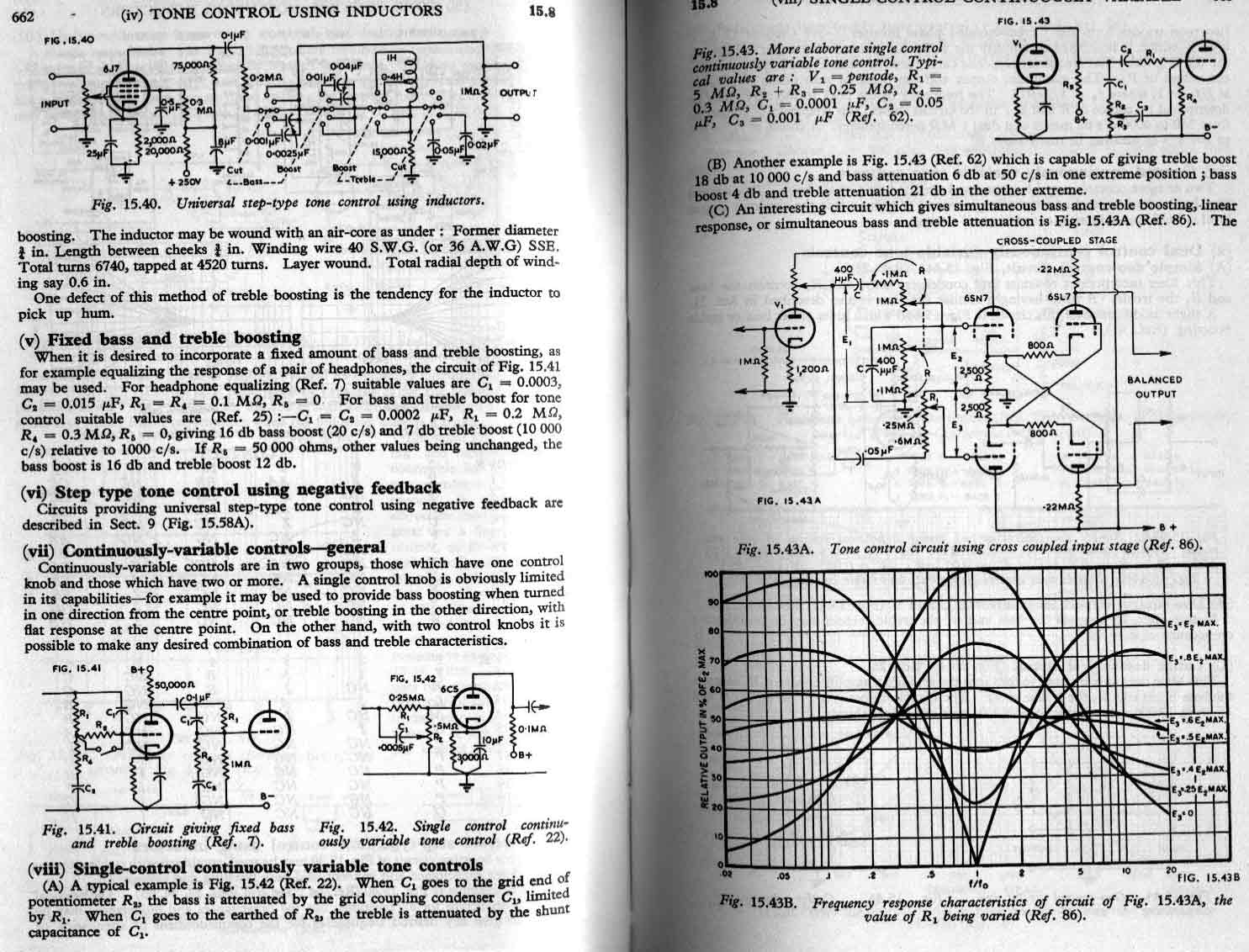

This is something I always wanted to try, never got round to it. Courtesy of the Radio Designer's Handbook, the last circuit seems to be a sweepable centre frequency EQ adjustable from bass+treble cut/boost to mid boost/cut. No noisy inductors, balanced output, could be what you're needing.
^ thanks, I'll save that and take a look sometime. At quick glance, it isn't quite what I am after. I already have a passive ladder-style Treb/Mid/Bass tonestack and a recovery stage. The parametric or graphic (depending on what I decide) will be there for further tone tweaks after the passive tone stack.
