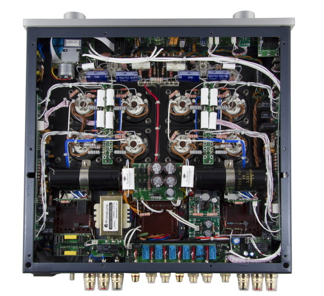

I’m wondering what “rules” to follow in order to determine the minimal required mechanical distance between a set of KT-150 tubes and between KT-150’s and 6SN7 drivers. All running Class-A.

No such rule unless RF yet for heat dissipation distance between edges (not centers) = diameter of tube's glass bottle is enough.
Just purchased 9 octal socket mounting plates with ventilation holes; 9 of these plates in a row means I need at least 57 cm chassis width. I guess this will give enough spacing and cooling.
Regards, Gerrit
If I understand you correctly, you are planning to mount all your socket plates butted against each other, and thus drop spacing to smaller than that suggested by Morgan Jones. I would strongly recommend against this. Making this compromise just to avoid some additional cutting or drilling is a bad idea.
Tube mounting plates 68 x 68 mm
This is a sample of a commercial Hi-end amplifier with similar tube mounting plates (they actually are 68 x 68 mm). I’m sure I’ve seen more similar commercial and DIY builds.

Yes you may be right but given that you have asked for advice, and haven't started your build yet, why not space the valves as far apart as possible? It will be you that has to pay for new replacement valves, not the manufacturer or fellow DIY'er.
Because it'll look like a 5yo did it with one tube in each corner. Use the plates and call it a day. There are many other factors that cause tubes to fail. Excessive heat is pretty far down the list if you use Morgan Jones and common sense as a guide. If you've ever seen the audio amp in an old film projector (Kodak "Brownie" or Bell & Howell Film-o-sound comes to mind), the tubes are almost touching and they are housed inside a tight enclosure with meager air circulation. I wouldn't pack them that tight in a DIY audio amp, but just to give you a frame of reference. Those tubes lasted years. As long as there is ample air circulation you should be fine with those plates with a little bit of room between. My $.02.

a commercial Hi-end amplifier with similar tube mounting plates -I’m sure I’ve seen more similar commercial
That looks like a typical chinese made amp.
"Hi end, commercial & Chinese", = oxymoron.

The sample image is from PrimaLuna... Not typical Chinese I guess although I have no personal experience with this brand. I’m quite confident they know how to build a good amplifier.
