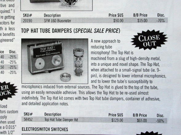

For anybody who wants to get the most out of his tubes.😉

Are those things for real? You said you abandoned the project they were for, but have you used them before? They just look so strange, yet cool.

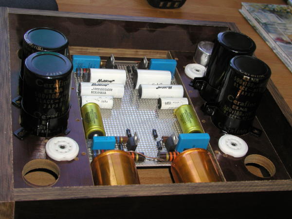

That's the project. I intended to use good parts: MIT RTX caps, Elna Cerafine, Jensen copper foil caps, Holco, Caddock, Allen Bradley resistors and of course the dampers. The dampers were available from Sonic Frontiers, so I think they were for real. SF was sellin them at discount for $65. I never have an opportunity to try them thou. Maybe someone on the forum did?

Bill Perkin's tube coolers act as dampers as well, cost a whole lot less than these top hats, keep the tube cooler (ie for longer life), and are available at the new Parts Connexion. A pr can be seen on my 5-Buck Amp.
Bill also makes isolated tube sockets that minimize microphonics which with the tube coolers make an excellent combo.

Oops... didn't realize you were trying to sell some top hats Peter... that last post won't help you out any on that -- what i said is still valid thou.

That's OK Dave.😉 I am sure that if you combine Top Hat Dampers with tube coolers you will achieve even better results on a road to audio nirvana.🙂

Very interesting idea, adding a little mass to the shell of the tubes!
I recommend dampeners for high-mu areas of your amplifiers, especially the phono stage tubes!! I use a pair of little sorbothane rings on the 6922s in my trusty Counterpoint 5.1. The heat generated by these tubes does attack the sorbothane over time, but the microphonics are effectively squelched by the rings.
I am using the high gain mode, as I'm using a low output MC cartridge; prior to the dampeners, I could hear even slight thumps of the chassis.
Has anyone experiences with the metal dampener hats?

Sorbothane is amazing stuff. It is like a resonance "sponge". I have some very cool sorbothane feet with a spun aluminum "shell" around each unit. The quartet of feet effectively dampen my preamplifier. No more thumps, as well as the "ping" sound as the control switches are toggled.
Granted, the gain has to be cranked up a bit, as in a quiet classical recording, but I know that feedback is happening in the loud passages. Kind of an expensive spring reverb, come to think of it...
The tube rings are mounted about two-thirds up from the base of the tube. They are about 6mm wide, with a square cross-section. If I remember right, someone like AudioQuest made them. I'll research it for the group.
I think that a dense automotive O-ring would have much less effect than these rings. They're simply too hard, and not as heavy as the Top Hats. If one wishes to dampen with metal, it should be of larger mass.
