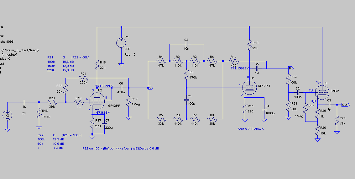

For a tube Baxandall tone control circuit where the design show 500K pot, what effect would it have if the 100K pot is used.

...which means that you should adjust the capacitors of the circuit to get the proper response.You will get the wrong frequency band adjustment.

Which will get very messy.
Load the tone stack calculator from here http://www.duncanamps.com/software.html a Passive Baxandall is called a Jones network. you can substitute different values to check them out.
a passive tone network should be made with A law Audio pots. Beware the passive tone controls on eBay, they have linear pots and don't track properly!

To be more clear:
Baxandall tone controll circuit can be built as well with 100 k potentiometers as with 500 k potentiometers.
Ofcourse the values of other components should be recalculted accordingly to get proper frequency response and operation.
An example:
hi ARTO....you use 6F12P Triode section only...how can we use the pentode section on this schematics?
