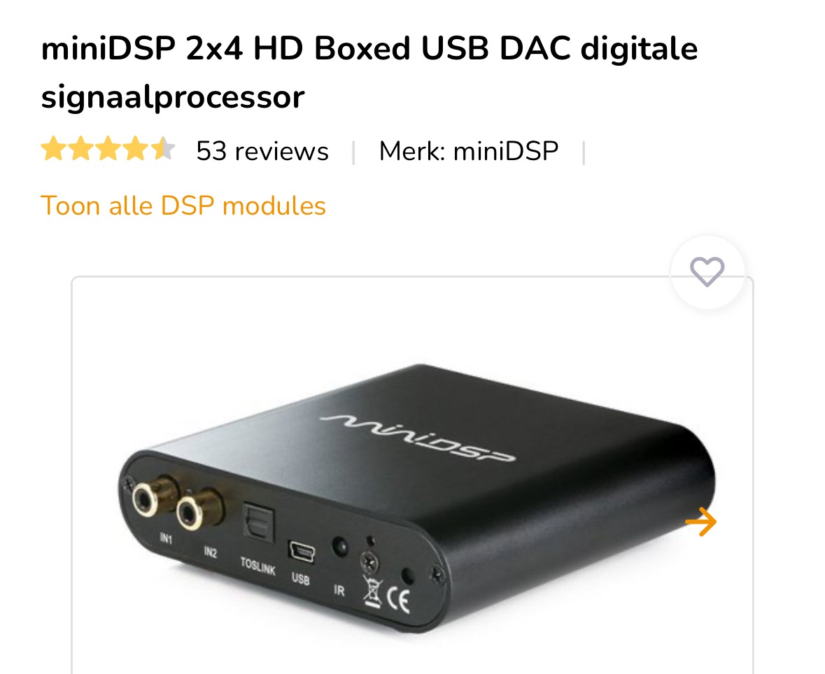

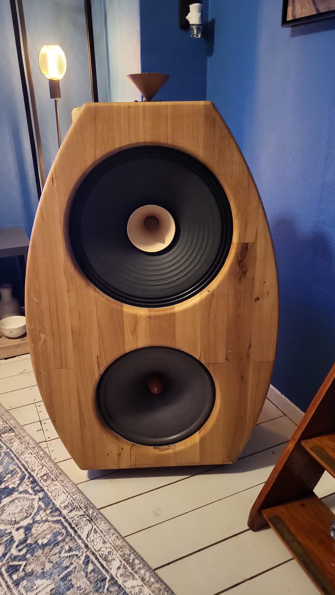

I have a 300B Stereo tube amplifier and OpenBaffle 2-way speakers.
Can I use minidsp with this amplifier?
Drivers are Lii F18 and SB Audience 18sw450.
Does it need more than just a dsp module?

What type of miniDSP?
Is it analog in, analog out, 4 channel?
Do you have a possibiliyty to do room measurements and/or room correction?
Does it come with Dirac? Are you familiar with say REW? Have a measurement mike?
You don't need to - you can do all xover adjustments by ear, but measurments make it so much easier and accurate.

Yes that'll work. But it's all in the settings you will use.
Did you think about the crosssover frequencies?
Is there a difference in sensitivity between the woofers and the mid/highs?
Difference in amplifier gain between the low and high amp?

You have only 1 stereo amp? In active setup with minidsp you will need 1 stereo amp for the fullrange, and one stereo amp for the woofer.

I myself have an OB with the Lii F-18 combined with a W-15 and a supertweeter. I run with two Rotel RB980BX and a MiniDSP that you want to use. This goes very well here.

By placing 2x4HD between source/preamp and a stereo amplifier, one can eq the speaker as such (L/R individually). It can help to smoothen spl response and room modes. Then two output channels should be muted in the control software.
But when using two power amplifiers (eg. heavy classD for woofers), one can equalize L/R woofer and tweeter individually, set crossover frequency and type, adjust gains and adjust delay for the upper driver.
In both cases you should invest in a measurement mic, eg. Minidsp UMIK-1. RoomEQWizard is very good freeware measurement software, with semiautomatic eq for minidsp 2x4HD.
2x4HD is a very versatile and rather easy to learn gadget! Well worh the price anyway! It has only RCA output, but voltage is often high enough for power amps.
