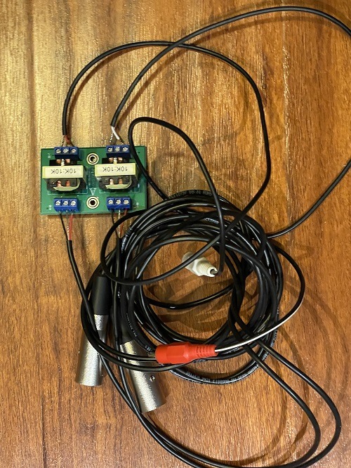

My hum problem
SS Preamp ---> SS amp and Tube amp (no hum with RCA jacks)
Tube Preamp ---> Tube amp (no hum), SS amp Parasound A21 and ML 532 (hum with RCA, no hum with XLR)
So I use audio transformer to convert from RCA to XLR, solve the problem.
