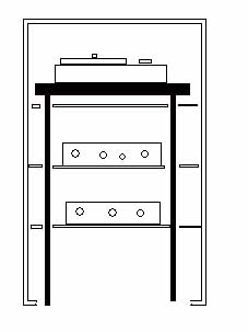

"It's difficult to tell from your description, but would it be possible to construct a 'false shelf' within the cabinet, which is really a table solidly coupled to the concrete floor?"
Not possible. I don't think this would help much anyway, I think I should be more concened about the cabinet acting like a speeker box and trapping sound. I had exactley in mind what Casey said, sand filled box and load the interrior of the cabinet with automotive sound damping material. Maybe when my wife sees the price of damping material she'll change her mind
