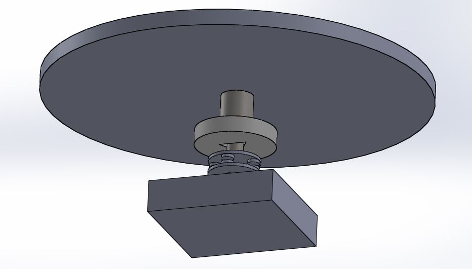

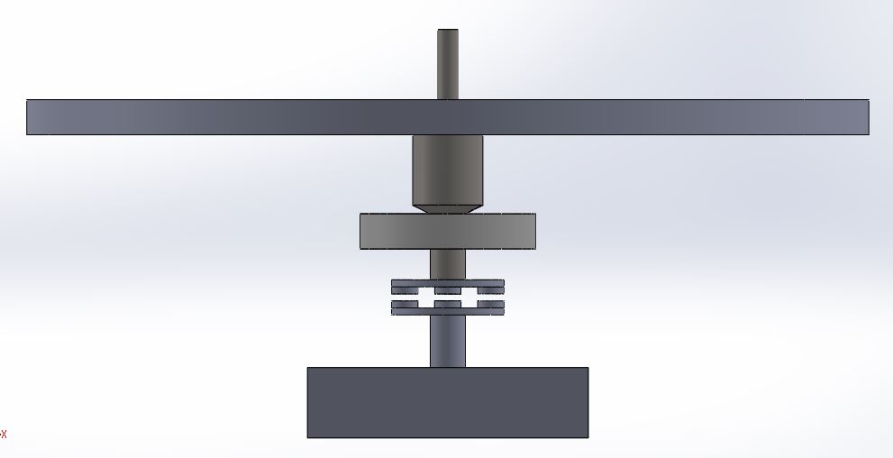

This is my first turntable I have designed, and am looking for input on this drive/bearing system.
The motor (the square at the bottom) is a direct drive motor, but to reduce rumble/noise, I want to have a magnet-coupled drive as seen here. The magnets alternate N and S facing up. I am worried mainly about the magnet proximity to the cartridge. Here it is 2.67 inches from the closest magnet to the top of the platter. Would this be a problem? I was thinking of adding MU-metal shielding. Would that be effective?

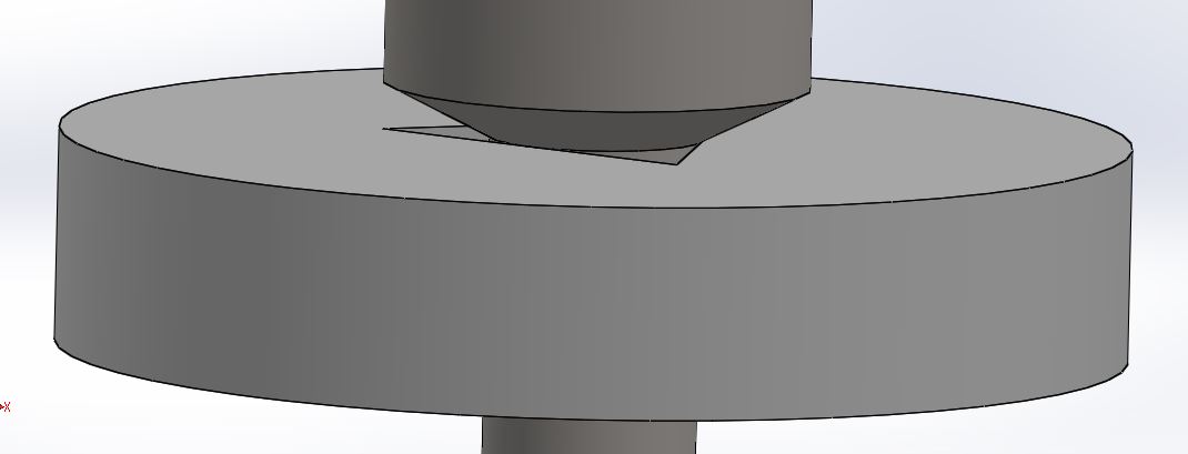

The bearing is teflon with a triangle hole and the spindle sits in it so that it contacts 3 sides, and the vertical support is taken care of a flare on the spindle that contacts the edge of the hole. This was inspired by the Well Tempered Labs bearing design. The bearing is light colored cylinder near the middle.
Finally, just another idea, also inspired by Well Tempered Labs. The half of the magnet coupler attached to the platter spindle and bearing are in a 'cup' that is filled with a viscous fluid for dampening. Not to viscous, since I don't want fluid friction to be an issue.
Feedback?

it goes without saying that the plinth is not here. The magnet drive is not levitating, this is just what it looks like completely exposed. the bearing takes the weight of the platter.
if the magnet drive is not levitating then why use magnets?
if you dont want to transfer noise from the DD drive then couple with rubber bushing.
as for 'viscous fluid' for the bearing i would use a good plastics grade grease instead.
have you considered using a plain bearing and a rotary shaft seal, that way the fluid will stay put and you get a much larger area for the fluid to 'cushion' the bearing from the shaft.
The magnet is there to drive the platter in order not to have physical contact with the platter and main bearing. Magnetic levitation in turntable design is a bad idea. Since magnetic force is a compliant system, not rigid, so there will always be vertical movement in microscopic level and it will affect VTA for the cartridge. However, using magnet to lessen the mass of the platter is a good idea as long as the magnetic field is well shielded.

The bearing you have drawn has Dr. Forsell used on a turntable, an article in a Swedish audio magazine where you could buy some parts and other parts did you yourself.
That which I could point out is that the shaft can be made longer at your sketch and let the bearing to be longer or two pieces.

But at the same time he's compromising the quality of the bearing as it has to run dry and increasing contact area at the thrust plate area or the lack of a thrust plate. The triangular hole now has THREE points of contact, instead of the traditional single bearing ball on a thrust plate, and running DRY.
The teflon bearing isn't running dry, though. The magnet assembly and bearing are both submerged in lubricant that would also supply fluid dampening. The bearing was designed to take care of the need for a thrust plate, but to add one should be possible if that is a better way of doing it.
The magnet assembly is not the contact point where the pressure of the mass is loaded. The edges of the triangular hole are the contact points where they deal with the load and if you place fluid there, it will leak out. And the bearing shaft is also not submerge in oil either. There are also no azimuth (or axial?) support other than the magnetic attraction at the bottom, not rigid enough. Too much wriggle room. If you a better method, I want to see it. There's really no better or simpler way of a bearing system using a shaft in a hole with the single point of a ball against a thrust plate. Why reinvent the wheel?

When I manually spun the bottom drive platter suddenly, there was a long delay before the top platter started to move. This is much like a belt drive turntable with a very loose belt IMHO. It is this " soft " coupling between the 2 platters that I feel is not the best solution for a turntable drive system. Their system does work well but I feel it more for a selling point then a practical solution.
Thank you for confirming my speculation about such designs. Once again, magnet is a compliant force just like a rubber band. But people are attracted by the non-contact novelty (One reviewer, Harry Pearson, who gave it a rave review and compared that to driving a car without the tires touching the road!). I think Clearaudio's method compromises the rigidity of bearing. I am told their magnetic bearing (top portion of the table) has no mechanic grounding so the bottom point is not touching any thrust plate so it's floating. There's no path for the energy transfer or drainage. One account says when press the platter bounces up and down, that's clearly not rigid and will affect VTA or vertical information.

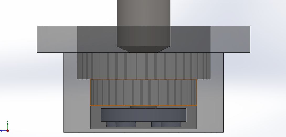

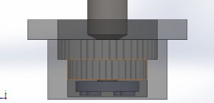

Here it is with the addition of the cup for fluid. The bearing has been changed so now it is an inch tall. There shouldn't be wiggle room, assuming proper tolerances- same as a bushing being close fitting, the shaft is a close fit in the triangular hole. To remove the need for a thrust plate/bearing the shaft has a flare.
The entire cup is going to be filled with fluid, including the bearing. I understand the need for mechanical damping, and I feel that the design principles utilized by Well Tempered Labs provide this damping.
there's no issue with vertical compliance, just make the design so the load on the mag Lev system is heavily compressed so that any difference in weight from record to record is such an inconsequential fraction of the supported weight it causes no deflection. They don't dip and Bob as they rotate.
You're right. Perhaps I was being too generalized on magnetic levitated bearing. It reminds me of airbearing tables a la Micro Seiki or Techdas et al.... No one ever seems to complain about their sound except invariably rave about how quiet the background noise is. If the layer of magnetic force or air is compressed hard enough, it should be fine. After all, many thrust plate made out of plastic material can change thickness over time too.
