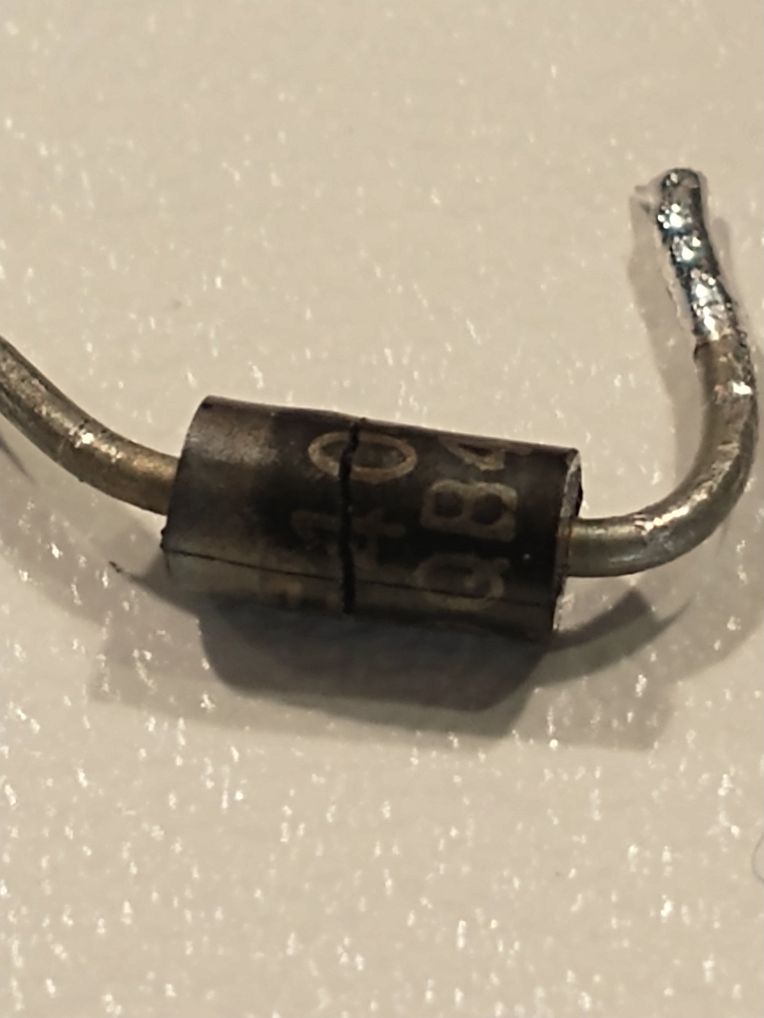

Hi everyone,
I spent some time looking over the board today. I noticed that d3 was a little... off-looking. the black cylinder w/ the grey stripe on it looks like it was damaged. It has a crack, and it generally looks kind of fried. picture attached. there's no marking on the board or anything.
My multi-meter has a diode setting. I don't really understand what the machine reads, but: when I put the COM probe to the cathode (the side w/ the stripe) and the red probe ("V_Omega_mA") to the annode, I get a reading of 218. When I flip the probes, I get a reading of 119. I'm told readings of about 500 and 0, resp., would be "good".
I grabbed a new 1000v UF4007 diode, with the COM probe attached to the cathode (w/ the stripe), I get a reading of 496. When I connect the probes 'backwards', I get the unmeasurable reading (the screen just says "1 ")
So I think that means d3 was compromised. If that's the case, does it give any hint as to a possible larger issue?
Thanks in advance for any help!

Joined 2004
Dan,
What schematic and BOM did you use? It might help to post them so that we can be sure we use the correct component designations.
That diode above (D3?) is gone, but could you verify what the part number is? I thought it looks like “40” across the crack. Is it a UF4007 or 1N5401? The latter part has a 100V peak repetitive reverse voltage and will fail if it was used in the negative bias generation across the HV secondary.
I assume you used the specified UF4007 for the D3, part that failed. Hard to say why it failed. But with a 640V CT primary the maximum voltage across each leg would be 2*320*root pi = ~ 900 V, i.e. close to the max for a UF4007. (Reminder to self: Use diodes with higher safety margin when building my TSE-II).
When D3 failed (for whatever reason, for now) it caused a collapse of the negative bias supply and depending on its failure mode caused an overcurrent through the primary if D3 conducted in reverse direction, as well as causing the 300bs to conduct their maximum (due to insufficient or no bias). I think this is what cooked the transformer HV winding. The question is, what else was damaged? The related circuit components and 300bs will have to be carefully checked.
Something puzzling: With a 640V CT secondary winding and a 5AR4 rectifier I would have expected a B+ (unloaded) of ~420 Vdc. Before the problems started you measured B+ close to 450 Vdc. Is your electrical supply at the wall high, or is something else going on?

Joined 2004
I checked a schematic I have of the original TSE circuit (before TSE-II) and it specified a DSEI-12 FRED for -bias supply duty - that was a 12 Amp diode with Vrrm=1200V. The current rating is overkill, but I like the 1200 V Vrrm. Wonder why George changed it.
Other builders of the TSE-II might want to rethink those diodes across the full HV winding providing negative bias.

Sorry for not being here much. The Radon battle has been won. It involved moving everything in my basement lab to seal all the cracks in the floor many of which were under the carpet, which was under the workbenches. This included all the workbenches that were built in place without any intentions or provisions for ever being moved. The resulting mess and cleanup will last for some time. Meanwhile I have no usable workbench space.
Due to many factors, after 18 years in business Tubelab Inc will cease operations at the end of 2023. Tubelab has lost money for the last three years and so far 2023 is even worse. I haven't figured out all the details yet but I will still be on these forums.
I have three built up TSE-II boards in a box that were built some time ago. All have UF4007's in them. The original reason for the change was the random death of the DSEI-12 FRED diodes in both the SSE and TSE boards. They usually failed during a thunderstorm or other event causing a transient on the power lines. I had one blow in my SSE when the compressor in the window AC unit cycled. They were just too sensitive to spikes.
It likely never got this far. When one of the two diodes failed it put a half wave short across the HV secondary of the power transformer. This should have blown the line fuse which should have been 2 amps on a 120 volt build. A 10 amp fuse allowed the transformer to cook itself to death.
I have never seen a UF4007 fail in a TSE, but it does run close to the max voltage spec. Perhaps a higher voltage part would offer some more voltage margin. I have used the DSA 1-18D in other builds with good results but have never tried them in a TSE-II.
