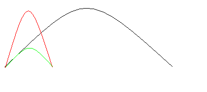

Here's why bass needs so much displacement:
Our ears don't hear the amplitude of the signal (ie, the displacement, peak). We hear the rate of change of pressure - the *steepness* of the wave (the angle at which the wave ).
Look at the attachment. The red and black curves (red being a higher frequency) are of roughly equal magnitude. However, we'd hear the red wave as much louder than the black one, as the uptake is much steeper. The black and green lines, however, are roughly the same steepness, so they'd be heard as about the same volume. However, the black line is of much greater magnitude, so much more displacement is needed to get those low frequencies.

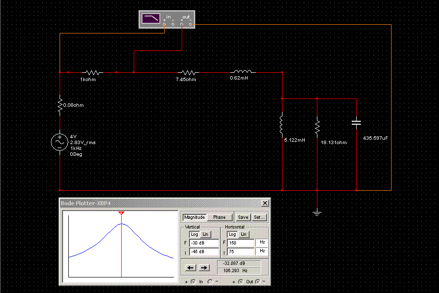

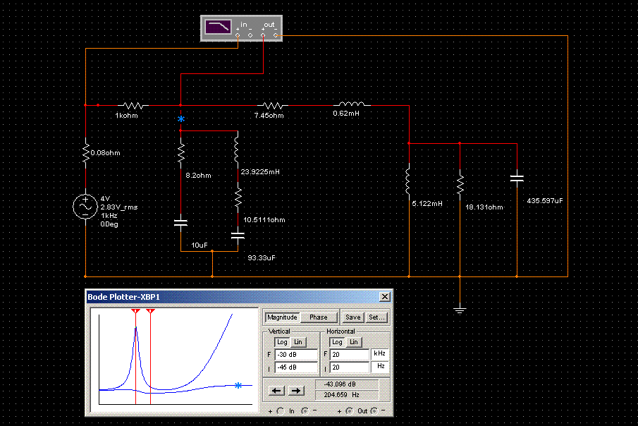

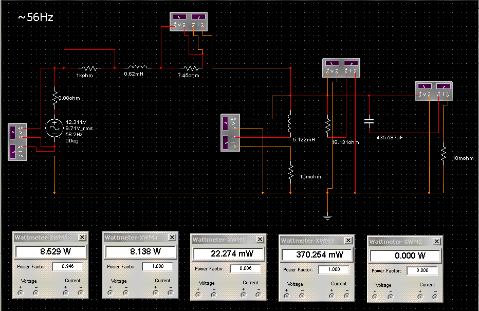

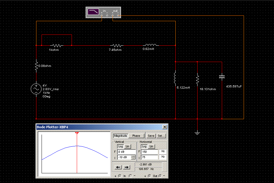

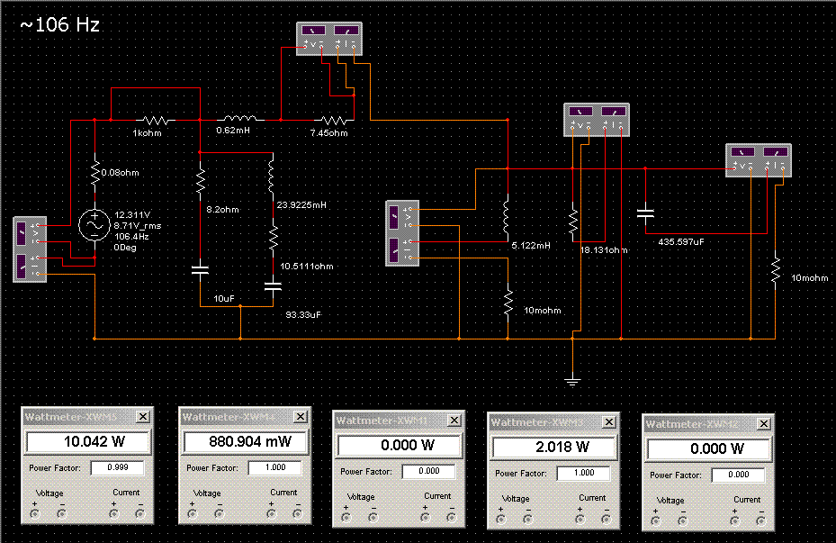

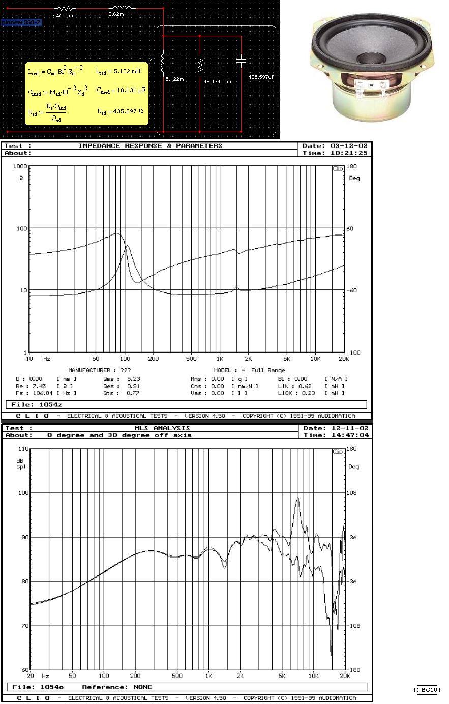

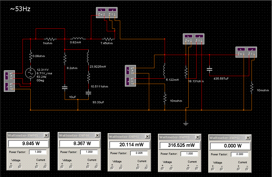

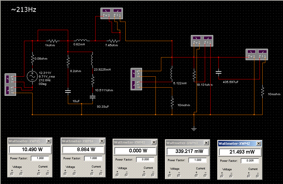

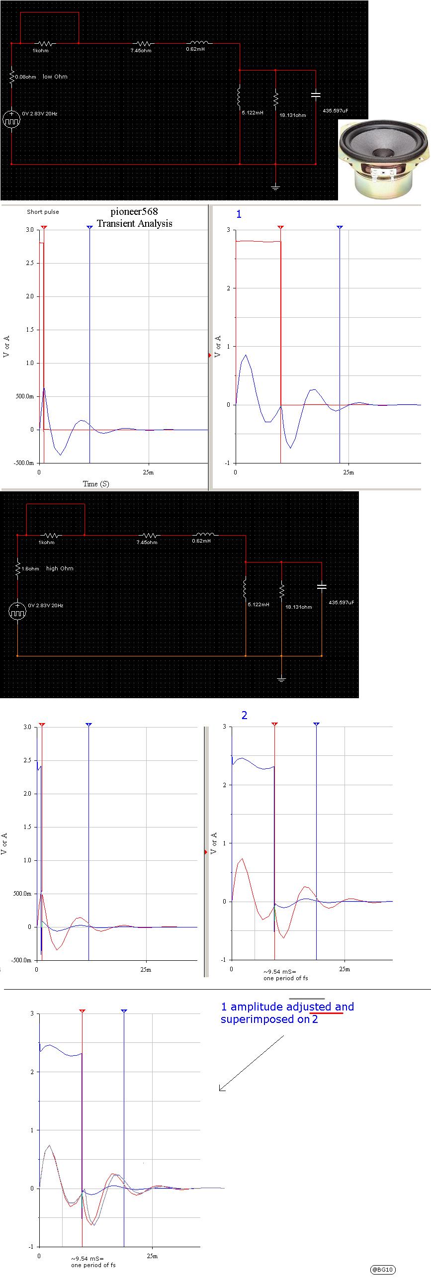

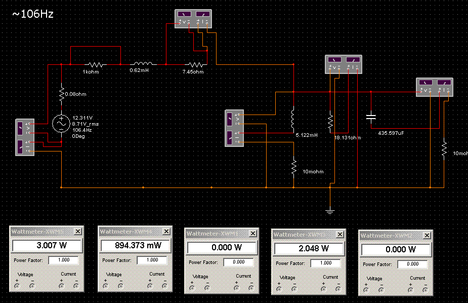

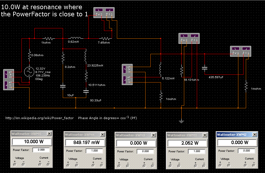

Hi.
I tried too but played with 'Multisim' instead and generated a bunch of pictures,
b
Hi.
I tried too but played with 'Multisim' instead and generated a bunch of pictures,as usual
