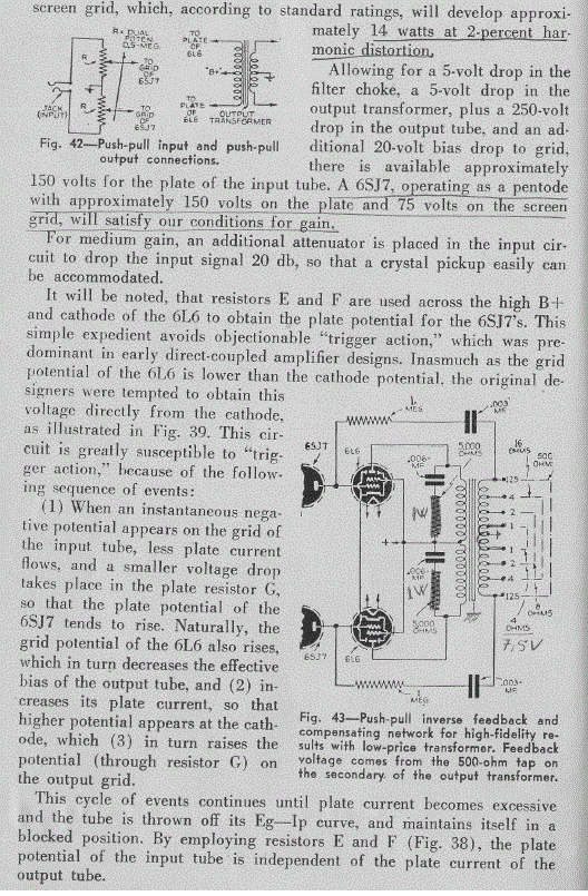

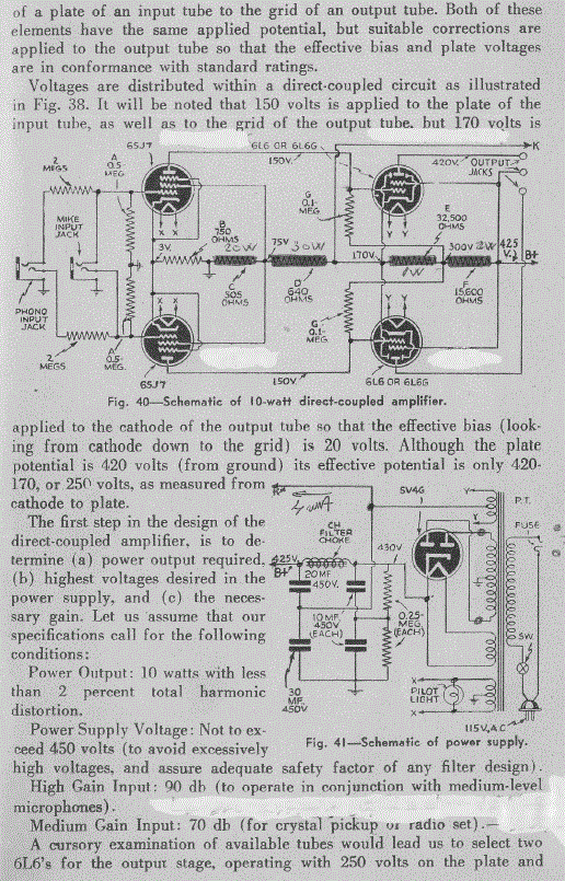

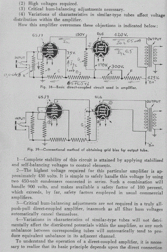

I was reading through an old Radio-Craft book (from 1947) and came across this Direct-Coupled 10 P-P amp design using 6L6s. And, it is fully balanced as well.
All 6 pages of the article are attached.
I have read it through and it is truly direct-coupled - NO caps in the signal path, only the PS.
I have attached the whole article. Maybe one of you design gurus could re-calculate the values to build this with better (read quieter) tubes than the 6L6. How 'bout EL34s or 6550s? Also, the input tubes are 6SJ7 - maybe change them to 6DJ8 or 6H30?
I am pretty well decided to build one of these to see how it sounds, but would love any input from the tube experts out there.

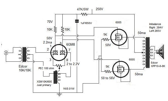

Jess,
It should work fine, but note it’s going differential, or splitting phase, off the input jack with 1meg between legs. This would probably be hard to drive straight off a CD player and may sound funny so keep that in mind. I’m not sure the feedback scheme will work as drawn unless you are using the output transformer spec’ed in the article.
On a lark I did this direct connect P-P and it sounds better than I expected. It should be clear I had lots of Edcor bits around.

Looks to me like this scheme wastes a lot of power. (requires class A output mode even, besides the voltage dropping resistors.) The high value resistors in the output tube cathodes are going to make the output Z rather high too. I don't think that global feedback "option" is going to be optional.
Why not just use the standard approach of two high value series resistors from each of the input stage plates, connected to a B- rail (or use CCS's on them to a - 30V rail). Center connection of the series resistors goes to the output tube grids. Causes a 2X loss of gain (or no loss of gain with the -30V rail CCS's). Could put CCS's in place of the input tube plate resistors as well to B+ for more gain and less distortion yet.

Maybe I’m reading the schematic wrong, but I only see 1.1K in the 6L6 cathodes, even without a feedback scheme, I don’t think output Z would be unreasonable. I think the hard part of implementing that output feedback as drawn is finding an output transformer with those tap options. Using a different transformer would require recalculating feedback, and would move the plate voltage of the 6SJ7 around a bit.
One cannot leave the feedback out because the gain of the 6SJ7 would be higher than the 70 to 90dB the article says it will provide, which is already too much for a modern amp. It’s not easy to swap tubes or gain profiles with a direct-coupled design, there are too many balls in the air. It’s kind of build it exactly as someone worked it out or do your own design from scratch.
Saving electrons was not a high priority in 1947 😀
Still, the total power consumption will not be much more than 200 watts, no?

Why not use a voltage divider to -V? It works for digital, and it works for analog. Tektronix did it!

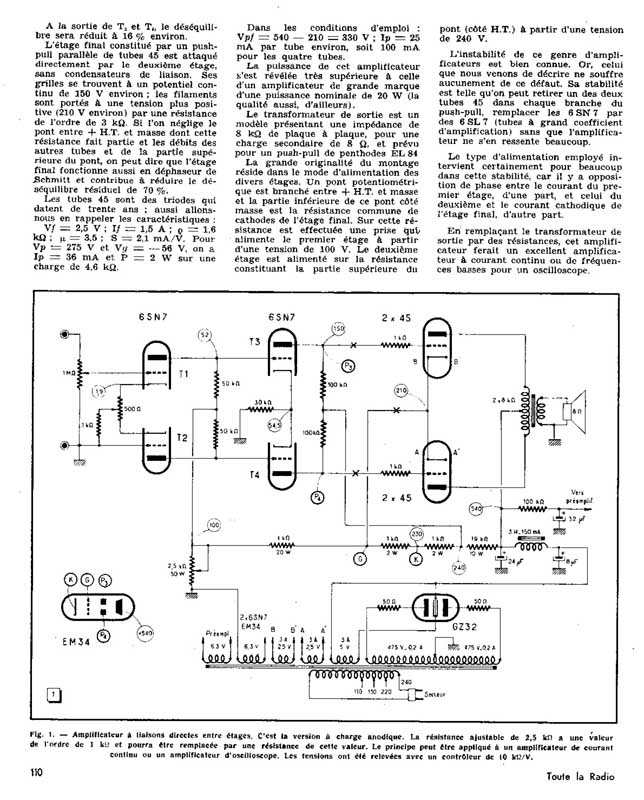

An other one, the Lafont amplifier
The French amplifier posted looks simpler then the one at the start of this thread. And its much lower gain is more in line with modern amplifiers, so it should be easier to work with.
D*#n, I wish I could read French. The Lafont does look simpler.
As the text of my original article indicates very high gain (accepting high-impedance microphone input directly) I was thinking about needing to tune the input tube gain down a bit, or attenuating the input signal.

I have no experience with the tube beyond the schematic I provided.
Matt

I never noticed that the data sheet calls out the 6GM8’s suitability for good direct coupling. I chose it because it works at low volts, allowing me to directly couple without the need to pull it down with negative voltage under the cathode or stand the output tube high. But any tube that works at low volts is fine. I actually use a 6N6P when I saw how much 6GM8s go for now. I just plugged it in with no changes to that schematic. Any tube with a common cathode but separate grid and plate will work in that drive position.
Matt

Moonbird,
I chose the inductor because I had it, and it’s DCR worked for cathode bias. With a twin triode like I used it helps to balance AC between halves. The pot helps balance DC through the outputs by allowing me to tweak DC through the triode halves. It’s a fairly common thing to do, though most around here would use a CCS. The pot and the inductor would serve no purpose with a common cathode driver.

I am not quite sure where in the circuit you are referring, Tim. Can you elaborate a bit for us punters? 😉
I don't have any Tektronix drawings to reference offhand (if you were so tempted, a perusal of BAMA for any of the older 500-series Tek scopes or plugins will turn up entire manuals for you), but I do have an example in my class D tube amp, which is DC coupled.
For example, where the PWM signal enters the driver at the lower left, instead of a grid-leak resistor to ground, a voltage divider to -320V is used. Same thing at the output, 100k on top, 220 + 100k on bottom.
Although this circuit is intended for saturating operation, which means operating points are looser, the same principle applies to linear design. The trick is to use global DC feedback, like an operational amplifier circuit, to keep all operating points balanced.
There is never a need for wasting tens of watts or more across a cathode resistor. 🙂
