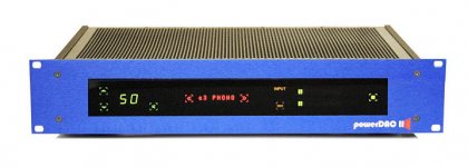

Bruno and John Westlake have been building TDAAs for many years and John Westlake's latest design - which uses closed loop feedback around the power stage - has the best measured performance of any TDAA anywhere, at any price. I've been designing and building open TDAAs since about 1995 and am presently working on yet another one. It's a serious addction and challenge to a variety of one's theoretical and technical skills.
If I were you I would start off by building a stereo TDAA based on the TI modulator chip (which is probably the best available today), coupled to a discrete output stage (OPS) of your own design. Some of John Westlake's discrete OPS schematics have been posted on the forum and my own PowerDAC 2 OPS schematic - based on a HIP4081A bridge driver - is also out there somewhere. These can serve as a good base and the design and layout of an OPS with low THD will keep you out of mischief for long enough for you to forget all this BlueGum. . .Bluee teeth...Buck teeth - whatever - computerry stuff!
I've attached a pic of PowerDAC 2 to whet your interest.

Bruno: Yes, open loop (like TacT Millenium and my PowerDAC 2 and the TI OPS ) is what I'm suggesting Theodoric build. As you say, once one starts putting blatant analog stuff in . . .
But hey, let's not embroil this innocent newcomer in the Digital Amplifier nomenclature wars!
