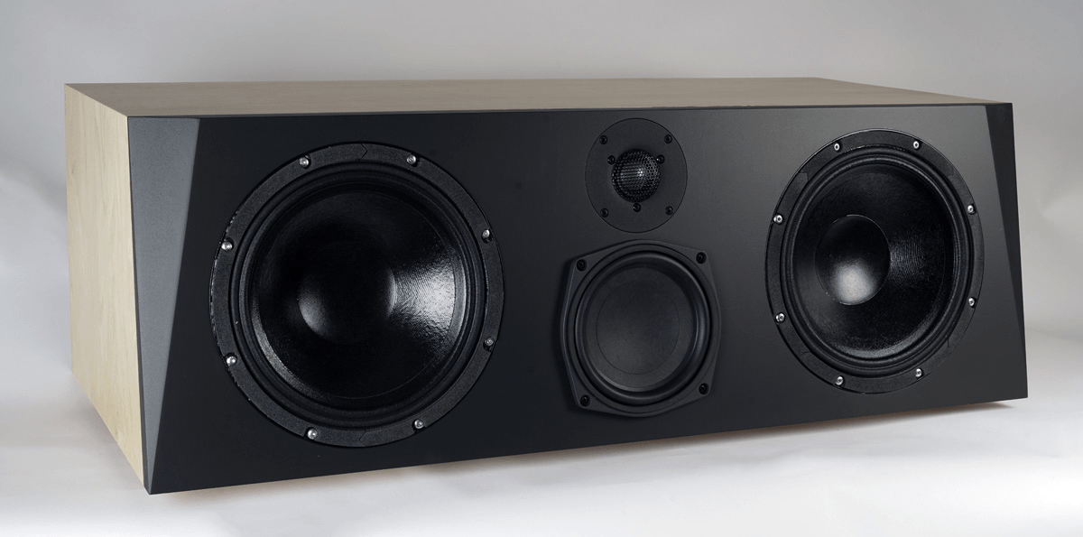

http://www.troelsgravesen.dk/TL-CENTER.htm
Matching high-spl mid just introduced. Looks like ok design, big and loud, isn't it just what many HT fans want?
2x10" woofers aperiodic tuning, 6" mid and 29mm Be-tweeter
