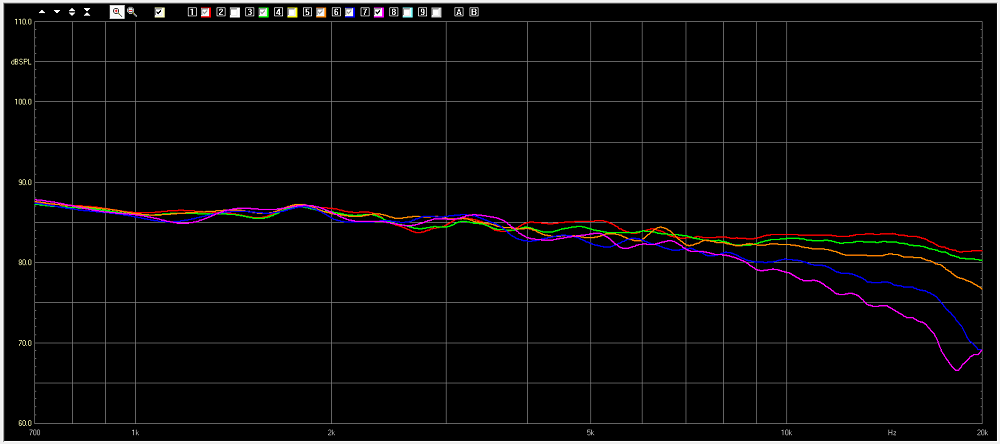

What I think is more attributable to Troels' design skills in this case is the horizontal off-axis response (10-degree intervals, up to 40 degrees off axis):
I think that is quite beautiful, and it was one of the clinchers that decided me in favour of this project.
Alex
